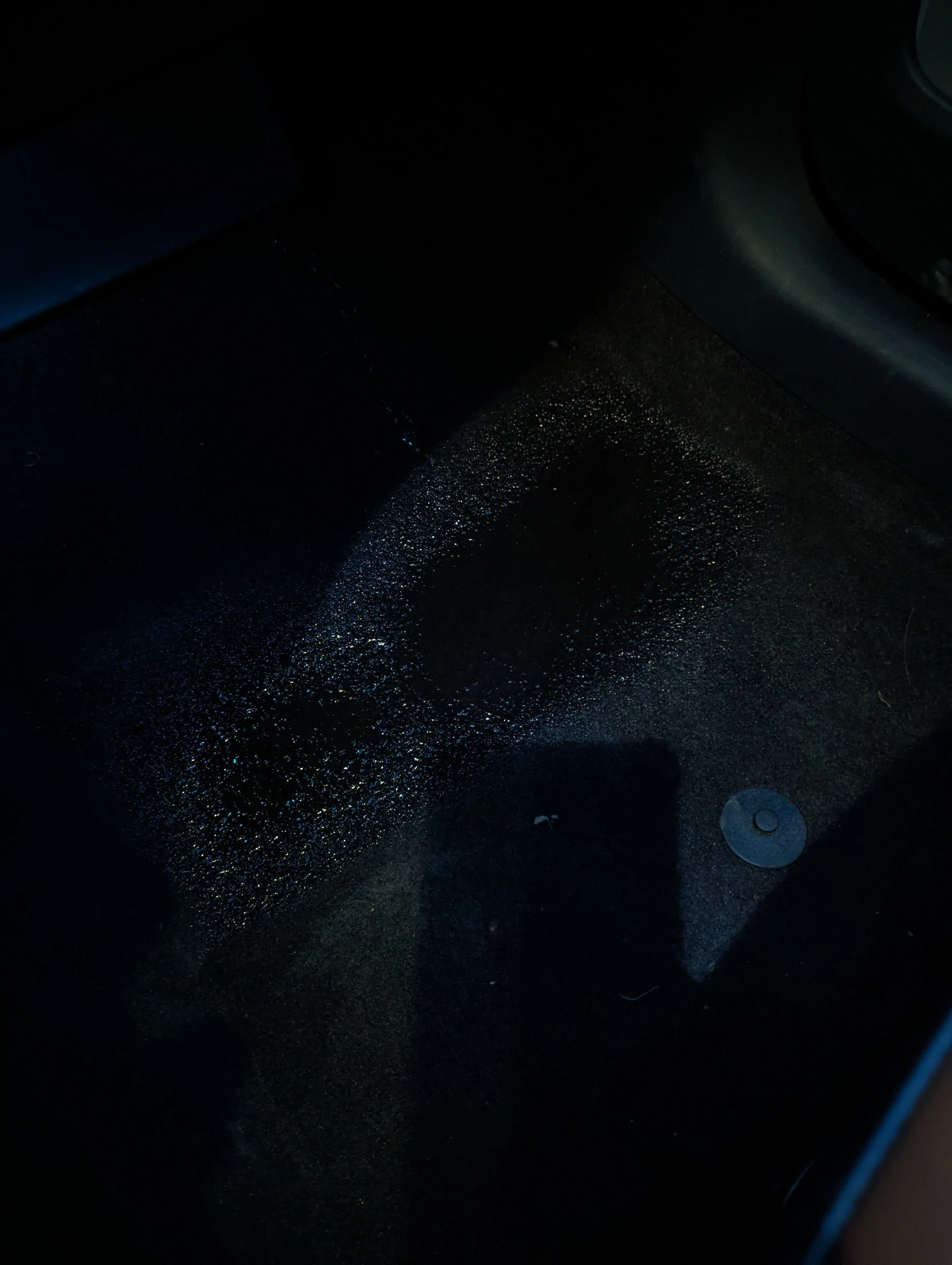

Ford Maverick 23 hybrid leaking condensation 1000011670
sorry about the dark image! Just got my Mav in August and it started leaking in October. It was just a bit damp on the passenger side floor and was worse in the rain. I checked the windows and behind the glove as well as the door seal. I have seen this issue in the forums so I made an appointment and vacuumed it up a couple of times while waiting for a Ford service appointment. This morning it was a literal puddle on the passenger side floor so I'm just hoping they deal with it today. Someone said it was a cowl seal/gasket issue. I hope there isn't any mold:( I hope Ford fixes this issue and it doesn't keep happening.
UPDATE! After a couple of days at the dealership I just got this invoice and will be picking it up soon.
The picture is of the invoice and the mechanic/technician states:
Confirmed client complaint, found the passenger floor wet.
during inspection found water coming from above the blower motor.
removed the cabin air filter to gain access to the fire wall. found the filter wet.
removed the cowl and found the water leaking into the blower motor through the
fresh air intake hole cover.
Correction p/a new cover, will need a cabin air filter
Hope this resolves the issue and I didn't buy a lemon😕

My Mav has been in the shop for the last week. I've been using a rental while they try to dehumidify the underlay. New filter and gasket installed after a couple weeks waiting for parts.
