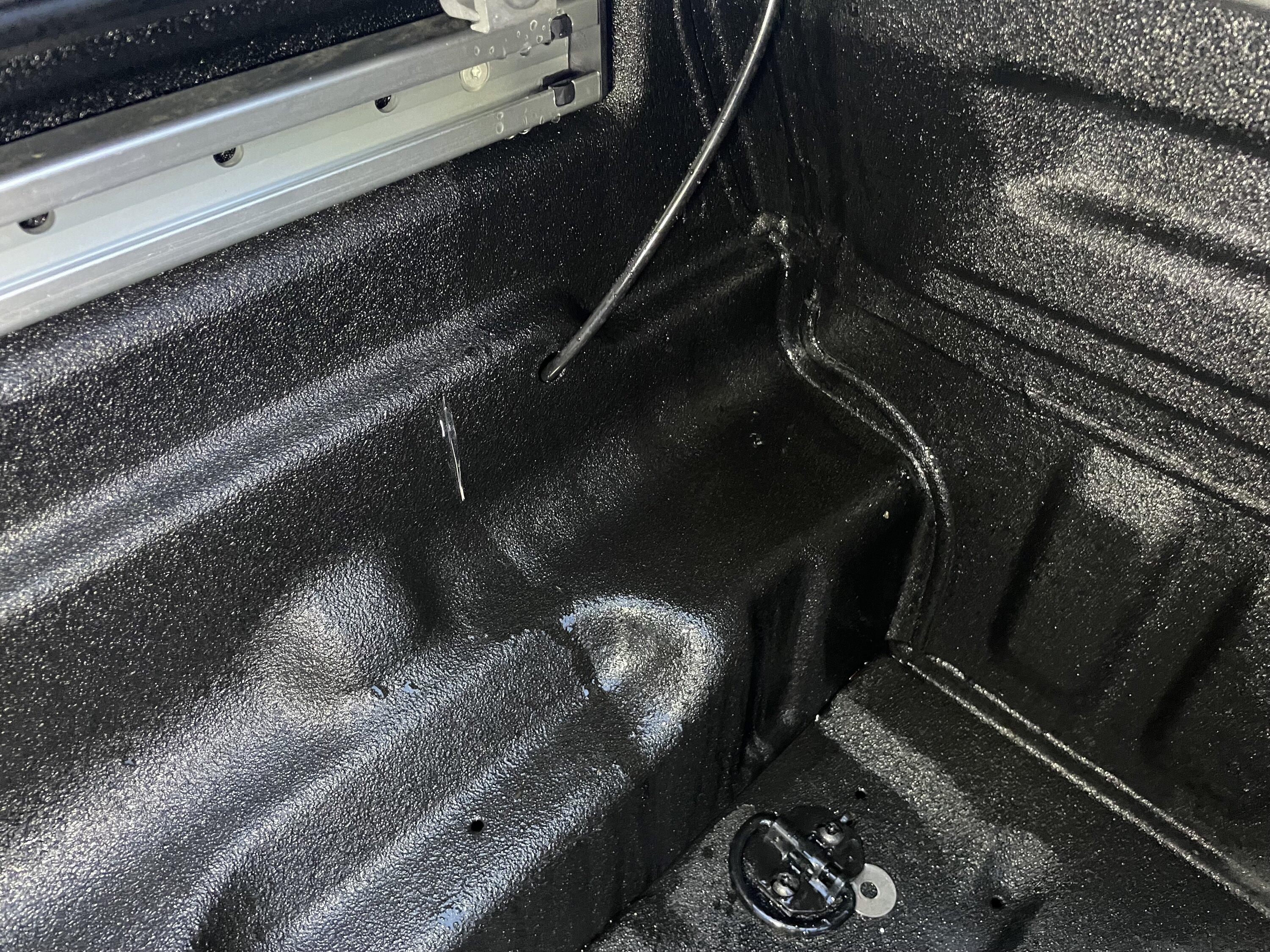

I have the Truxedo Truxport soft roll cover from Ford that I installed myself and on the heaviest of rains I'll get a little drip near the tailgate corner.
Hkak45
K
Dec 7, 2020
212
235
Cody, WY
2022 Maverick Ecoboost

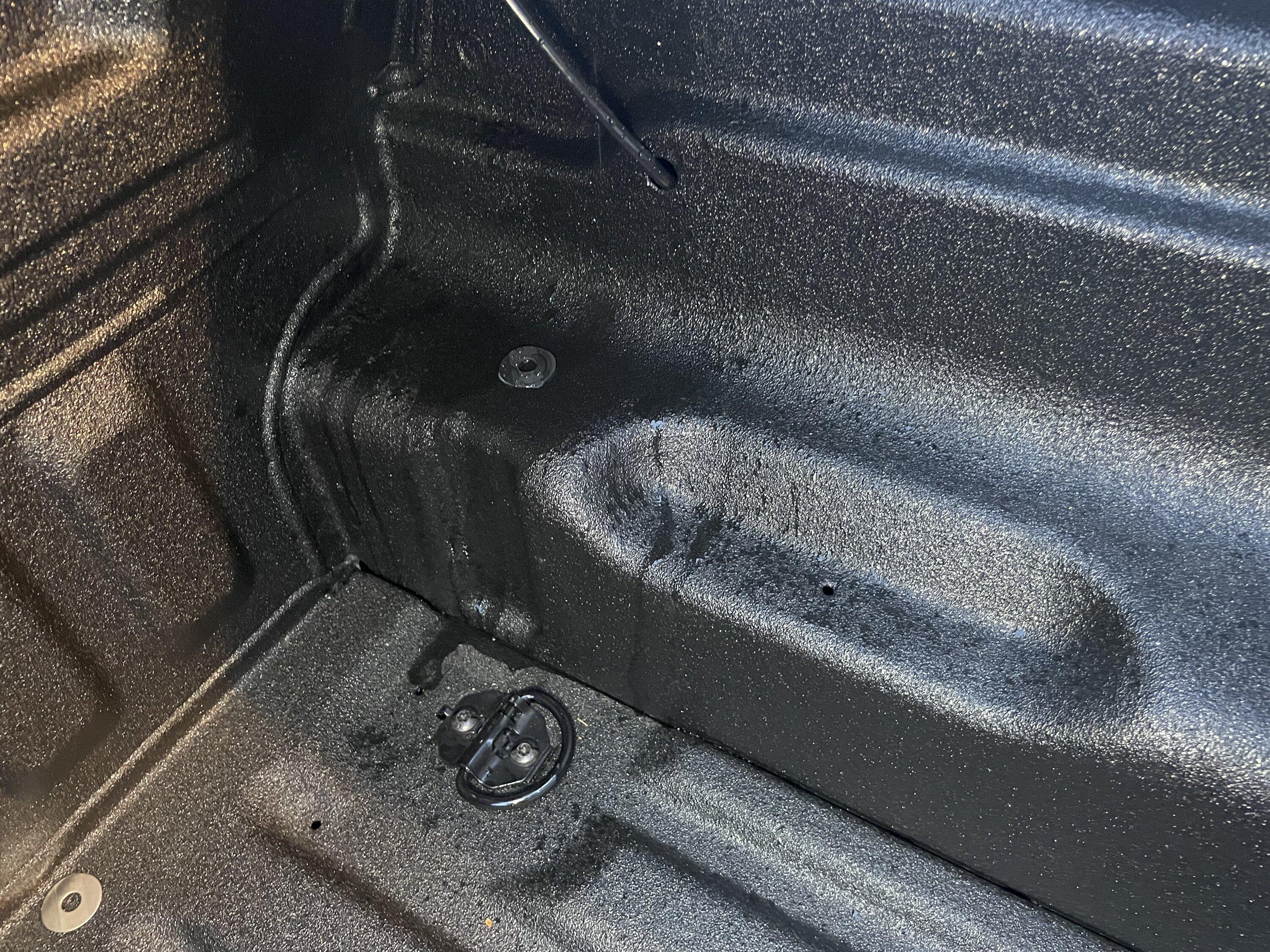

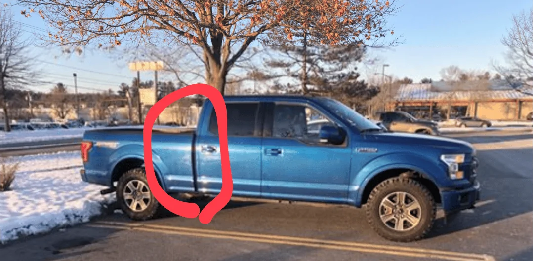

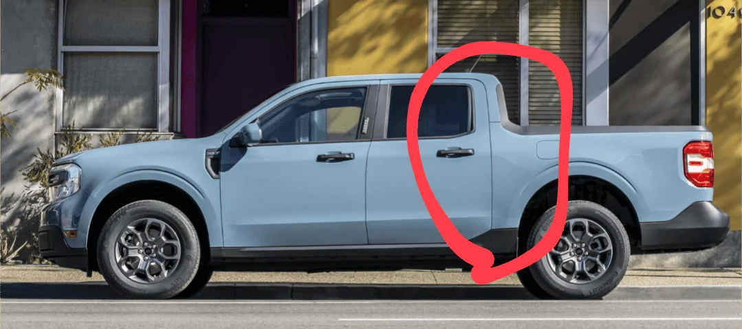

One thing I have noticed with the maverick compared to my F150 is that the maverick bed is connected to the body where the F150 the bed is completely separate piece and has a split between the bed and back window where rain can fall and not get into the bed. I believe this is why a lot of tonneau covers get wet in the bed since the water sits between the back window and cover and water will always find any hole it can when there is enough of it.

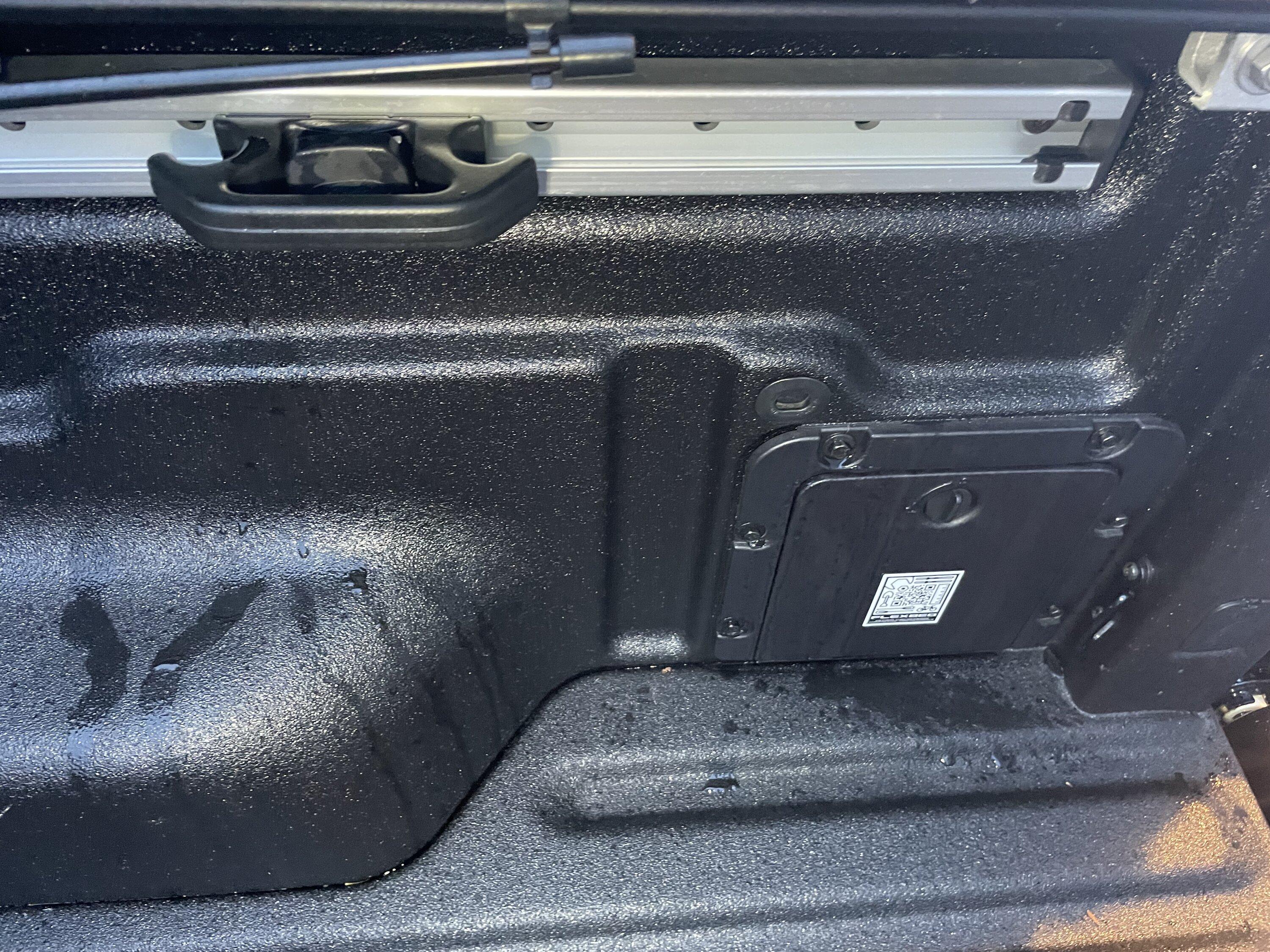

Below are pictures for exhibit A and exhibit B, your honor:
Ford Maverick Tonneau cover leaking 1000003166
Ford Maverick Tonneau cover leaking 1000003167

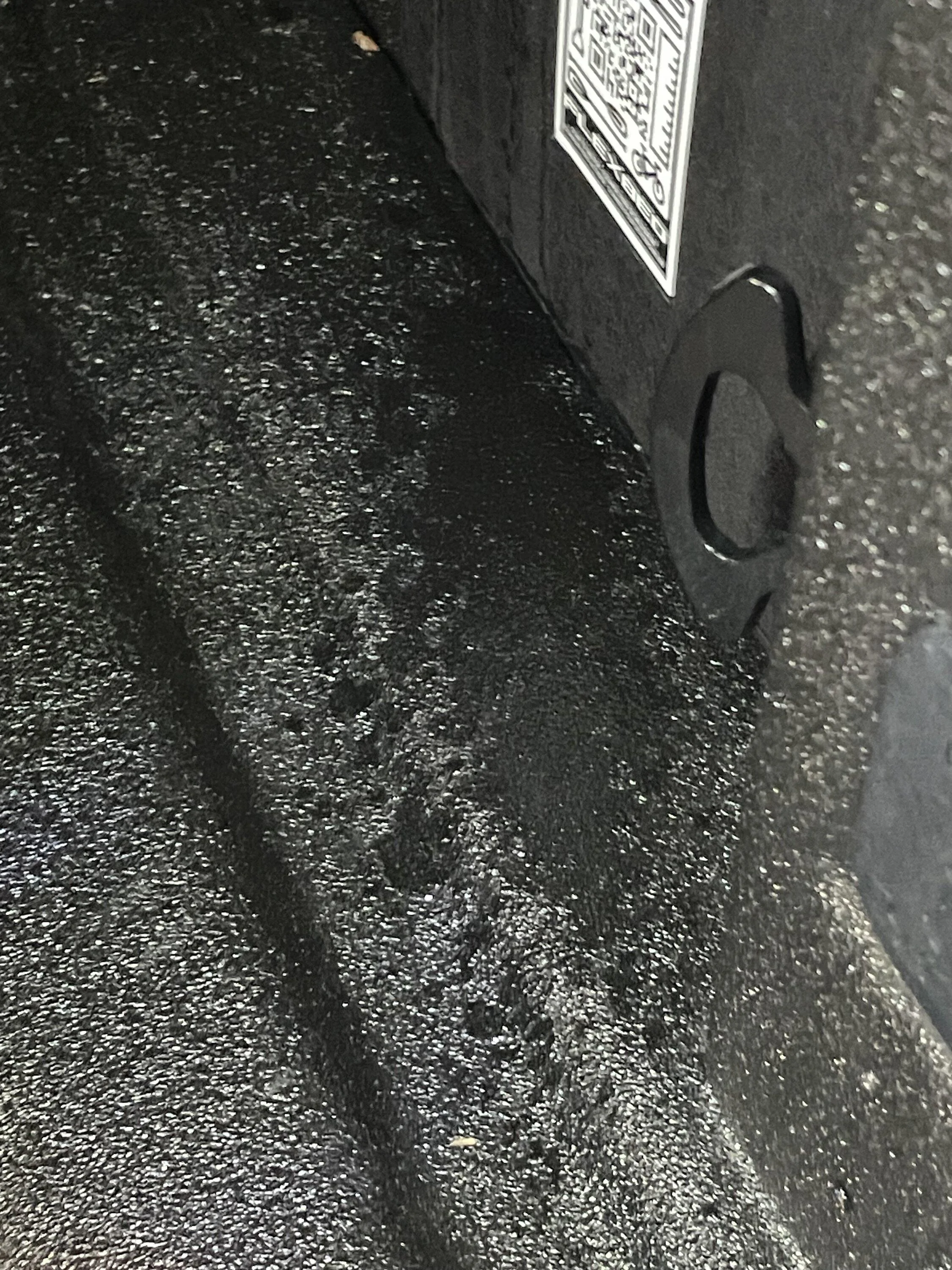

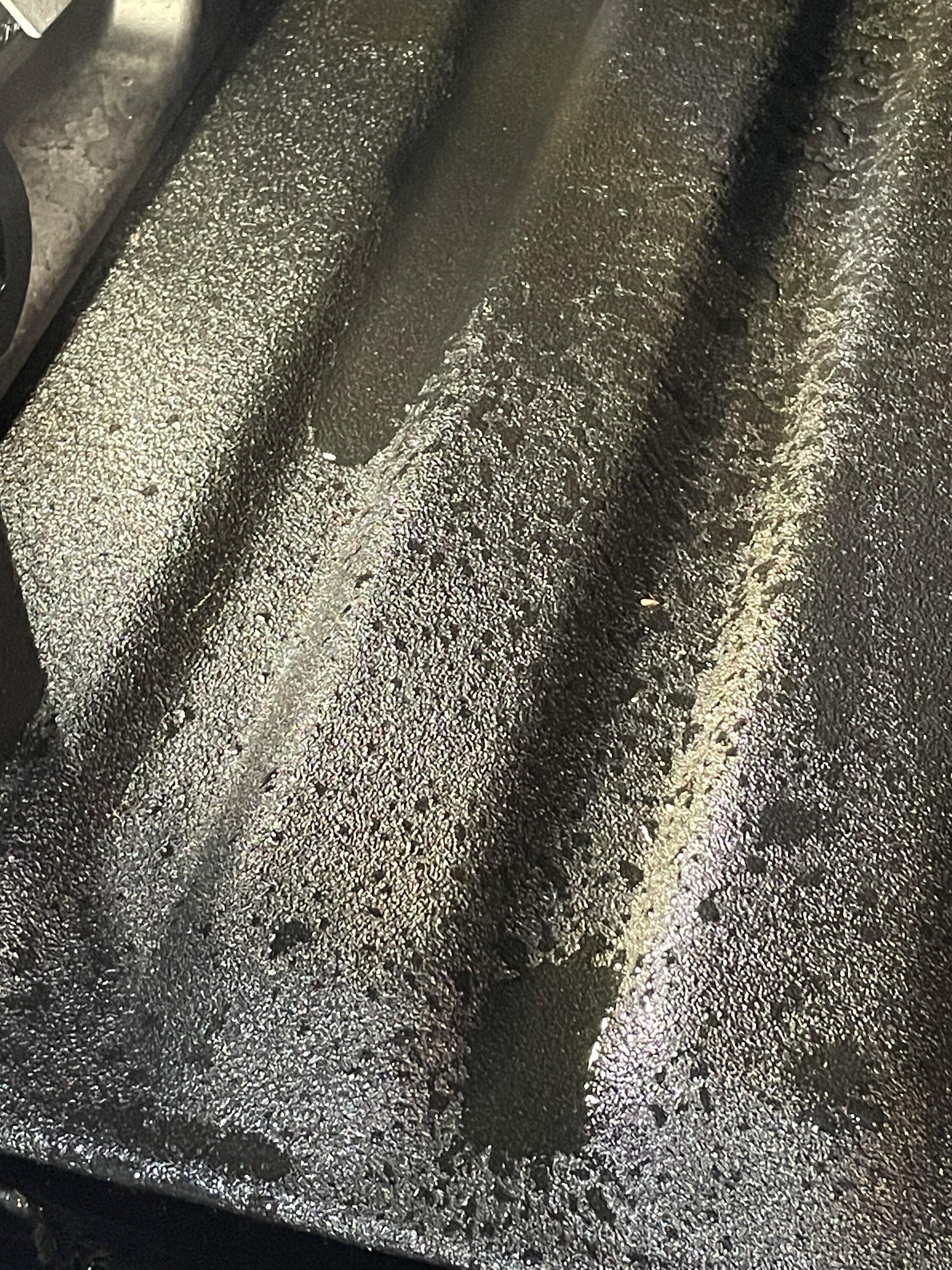

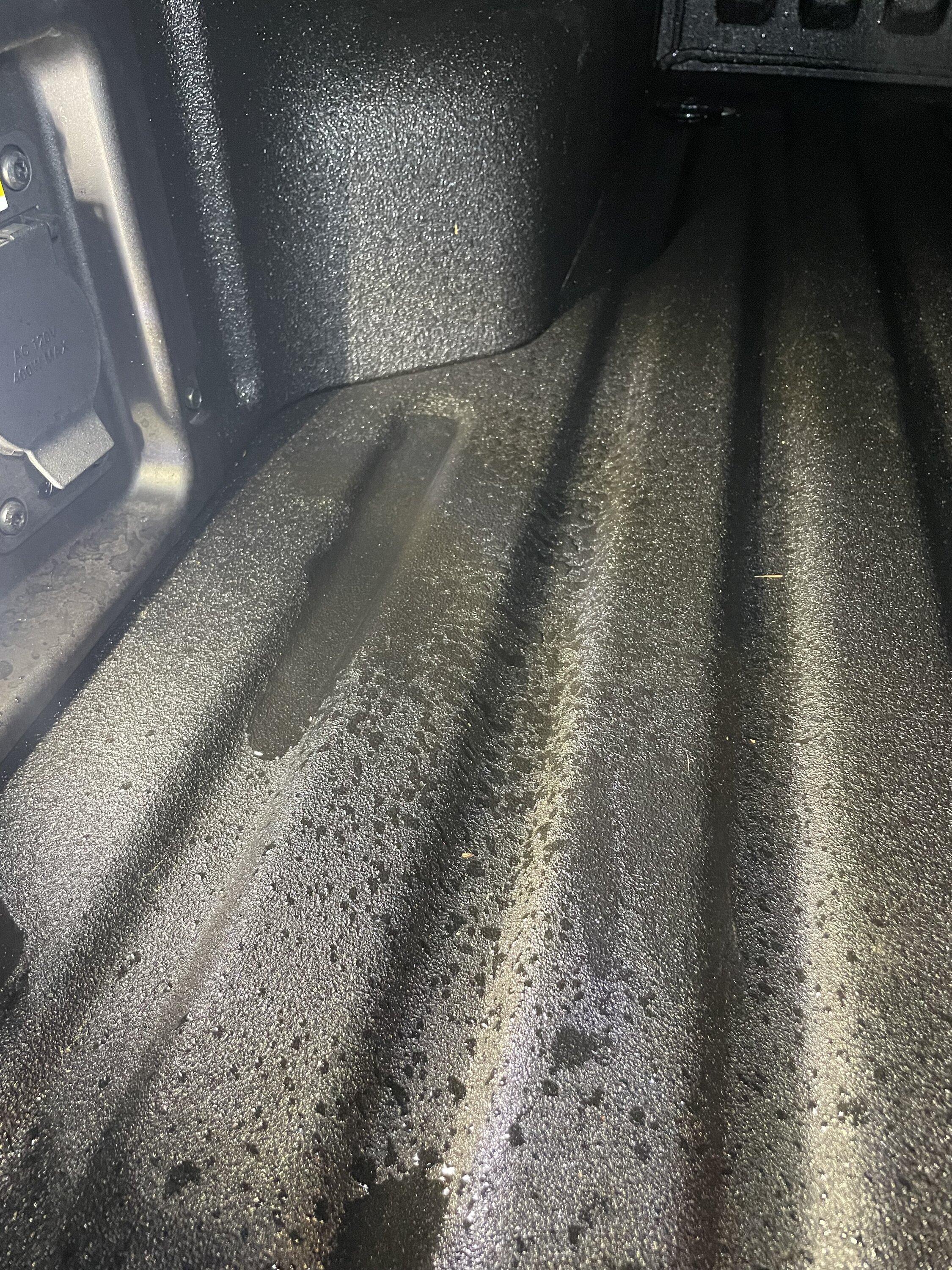

I have a ford dealer installed tonneau cover. I had water in the bed, they had Ford give me a replacement cover. After five weeks of waiting they replaced the cover. We had heavy rain last night, now leaking worse than the old cover.
Is this the dealer issue or are ford covers this bad?
I will attach pictures, let me know you thoughts
thank you

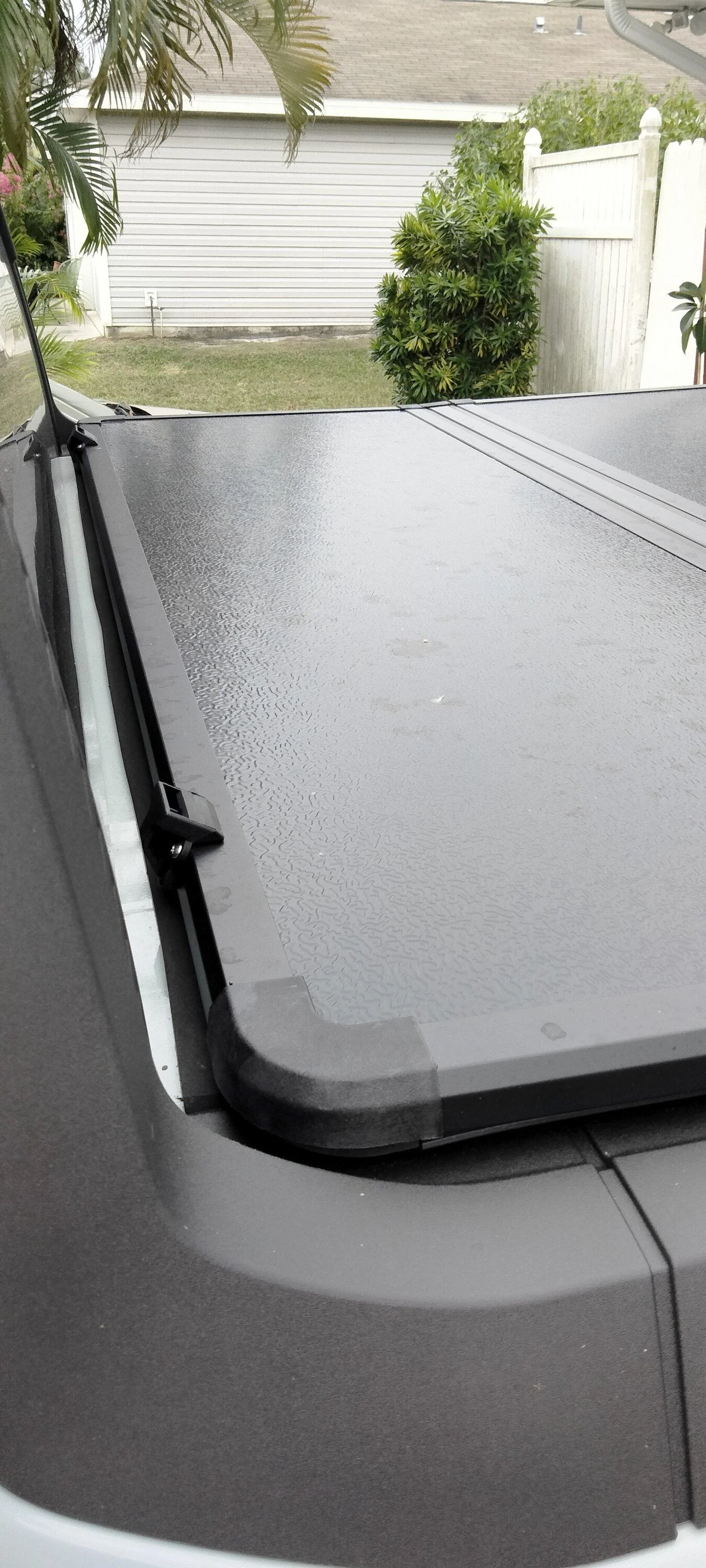

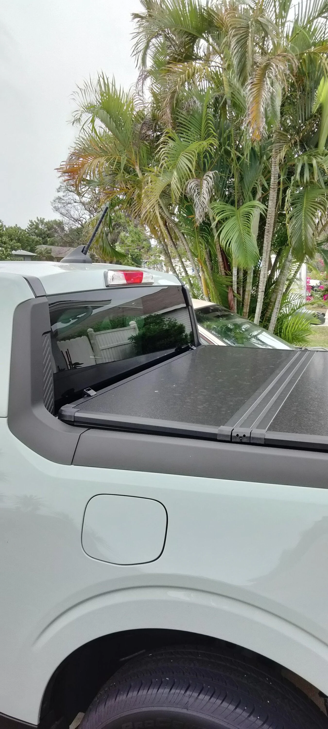

I bought this hard cover and installed it myself. It leaks pretty bad at the corners at the front by the cab, and a little on one side of the center panel. We are having a monsoon here in FL this weekend. I'm going to reposition it after this weather blows over. I am determined to get this thing leak proof. Will really check the seal all the way around and figure this out. Any suggestions are appreciated. I may have it to far up on the weather stripping.

Had capper on F150 that leak around front edges . crawled into bed with caulk gun with 100% clear silicon caulk . problem solved . surface has to be dry .
