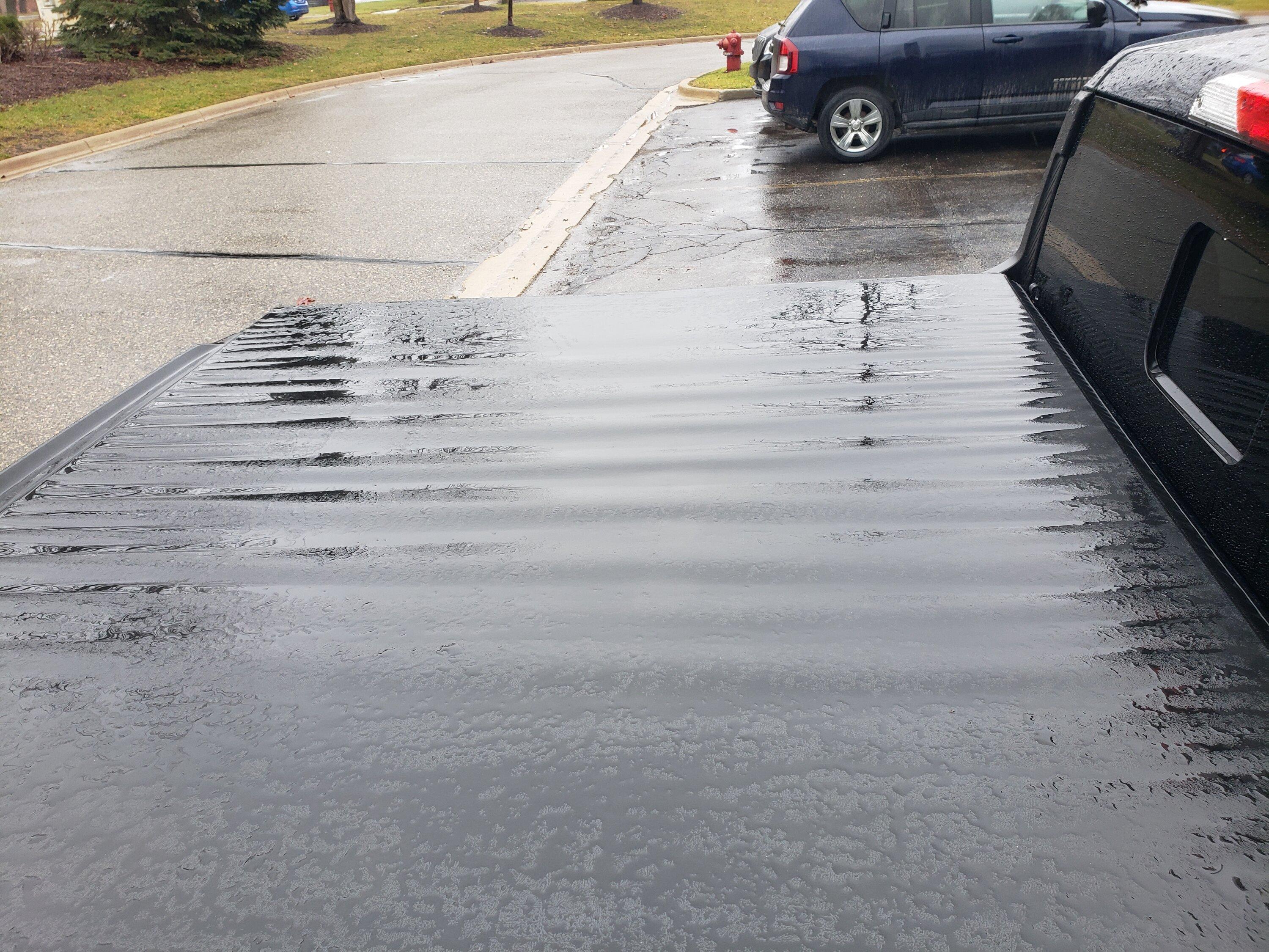

I bought the Ford brand roll up cover when I took delivery of my 2022 lariat. It leaks and will not lay flat. It has ripples in the fabric when under tension that I cannot fix
I have that same cover and to get those wrinkles out (more importantly keep the rippling at speed to a minimum) I clip it in then pull hard at front, middle and back and press down, both sides. No wrinkles.
Good advice. I have tried that so many times without success. The pic I attached is after pulling hard on the velcro as you described.
I welcome other ideas.
