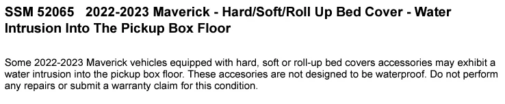

I have the backflip FX 4 that I installed myself and I don’t see nearly that much water after a car wash after you wash it I do blow the seams off and trifold it up and let the water drain through small pipes you had to add to let water exit the vehicle at the drain holes as provided in the directions. A little bit of water gets in at the tailgate area but there’s somethings wrong there that’s way too much water for a hard trifold to let through. If you get inside with a bright flashlight and shine it at the edges and see light, it means the rails were not installed correctly. Generic weatherstripping is also your friend in the tailgate area.I

That may be the company line today but when I bought my cover they talked water tight. Not water proof but tight, and no definition of how dry you would be.
