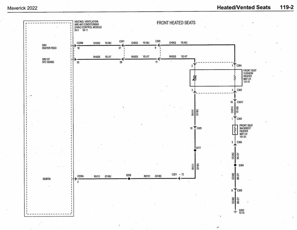

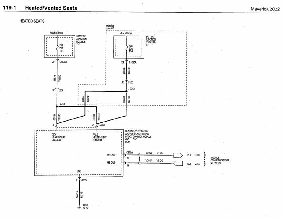

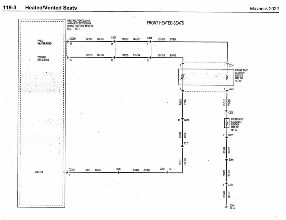

Not sure if this will help or just confuse the issue, but I seem to grab stuff I may never need about my Maverick. One of those items was a scanned copy of the Ford Maverick 2022 Wiring Diagram. Here is what is shows for Heated/Vented Seats.
