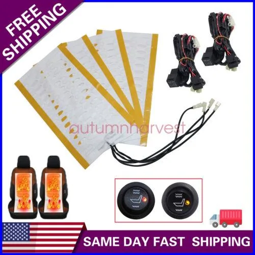

I installed heated seat elements under the factory seat covers on my Mazda Protege winter car because I lived in the White Mountains in NH and it was regularly -25 degrees or so with the wind chill. I bought a kit off of ebay for fifty or sixty bucks which included everything I needed, wiring harness with relays, heating elements for both front cushions and seat backs and nice toggle style factory looking buttons. It was super easy to install and worked very well and last for many years before I moved South and sold the car. Do you have an automotive savvy friend? This is probably the exact same kit your dealer is going to have installed by one of their subcontractors.
The kit was something like this:
Ford Maverick Aftermarket heated seats dealer install ??? ebay heated seat kit
Heated seat kit
