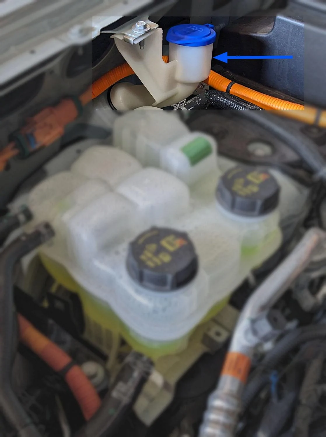

Is anyone else surprised by how small the washer fluid reservoir is.
rdmaverick
Nov 8, 2023
Nevada
2023 Maverick XL Hybrid
Uhoh, on second thought I hope you’re not trying to fill a coolant reservoir… the hybrid has 2 coolant reservoirs, one for the engine and the other for the high voltage battery… the washer reservoir is next to the headlight..
rdmaverick
Nov 8, 2023
Nevada
Next to the headlight??????
HRG
So not only are all of these clearly labeled I can look into the space and see that the tank is only about 2” deep and 12” long and 3 “ high. Does it wrap around the entire wheel well?. Not sure how one can get to the bottom of the tank unless from directly beneath the truck.

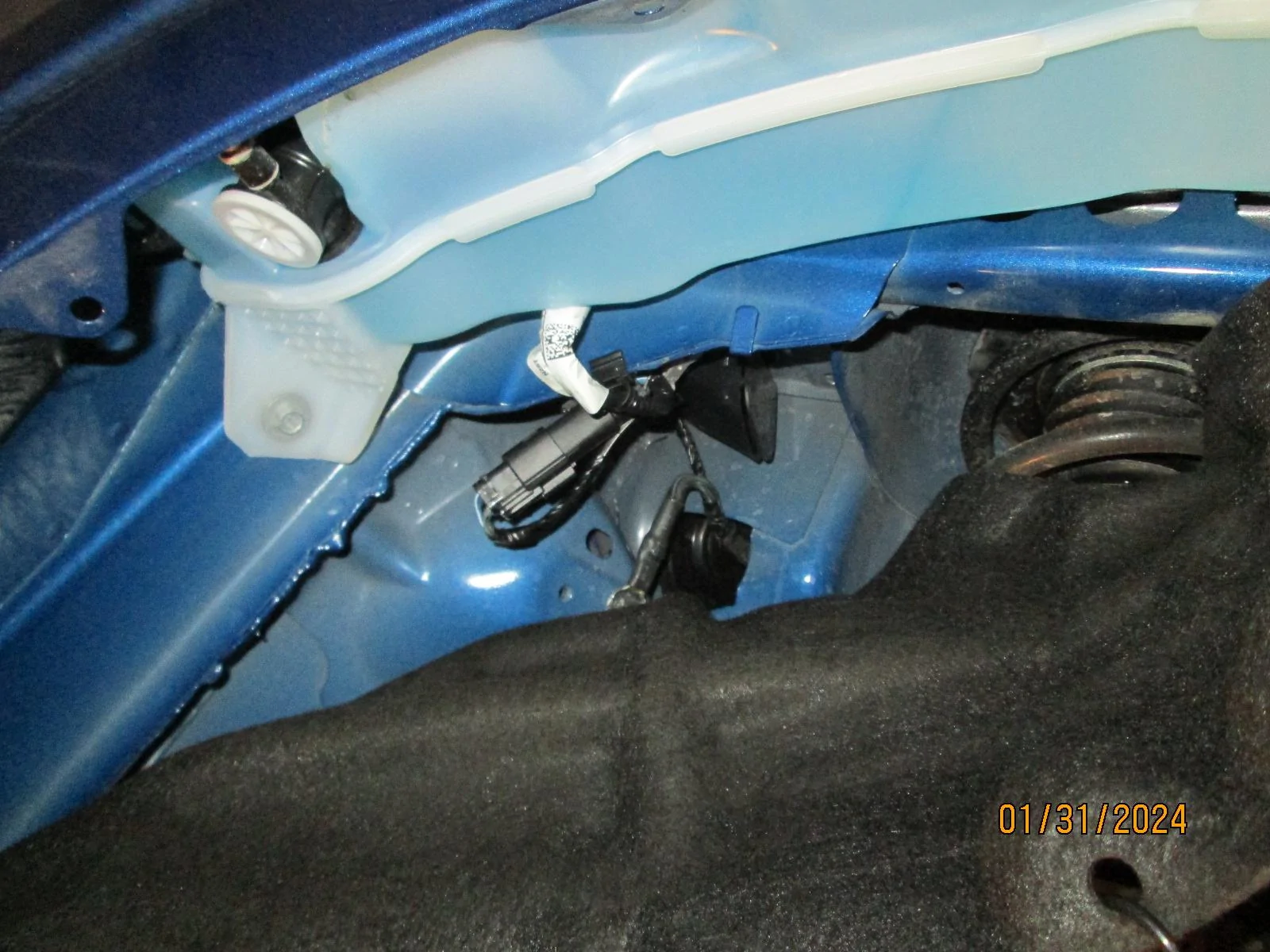

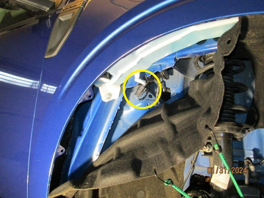

If you pull the wheel well liner back, you can see the tank and access the level sensor.

16oz????????
let me guess, the low fluid warning went off and it took 16oz to fill.
check the elec connection at the bottom of the bottle.
Got a picture of where this is?
HRG
Sounds like a job for the dealer. Should be warranty issue. They do that with turn signal update and oil change and infotainment update etc.
thx for the picture.

It's a couple plastic clips you remove and pull back a liner to see if the sensor is at least plugged in and functional. Could save you a trip - or half a day (or more) without a vehicle depending on how busy they are.
good advice. That type of connector can look connected and not be fully seated. I suggest anyone going this far to first try to remove the plug, if it moves it wasn't fully seated. Reinstall the plug and press until it clicks.
Montana
Jun 13, 2023
4,094
6,349
A little dielectric grease never hurt either ;)
