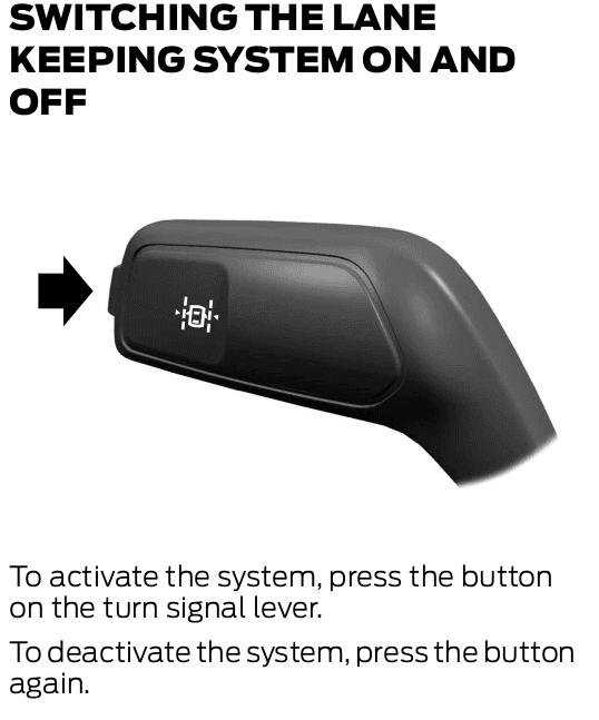

I thought I had this issue too, and it turned out to be the Lane Keeping System wanting the vehicle to be in a slightly different "center" than what I did. You can feel the servos giving a little bit of resistance (creating that "heavy" feel) when it is enabled.
Turn it off by pushing the little button at the end of the turn signal lever and see if that helps.
The driving feel is much better with this off, and I only turn it back on when cruising on the highway.
