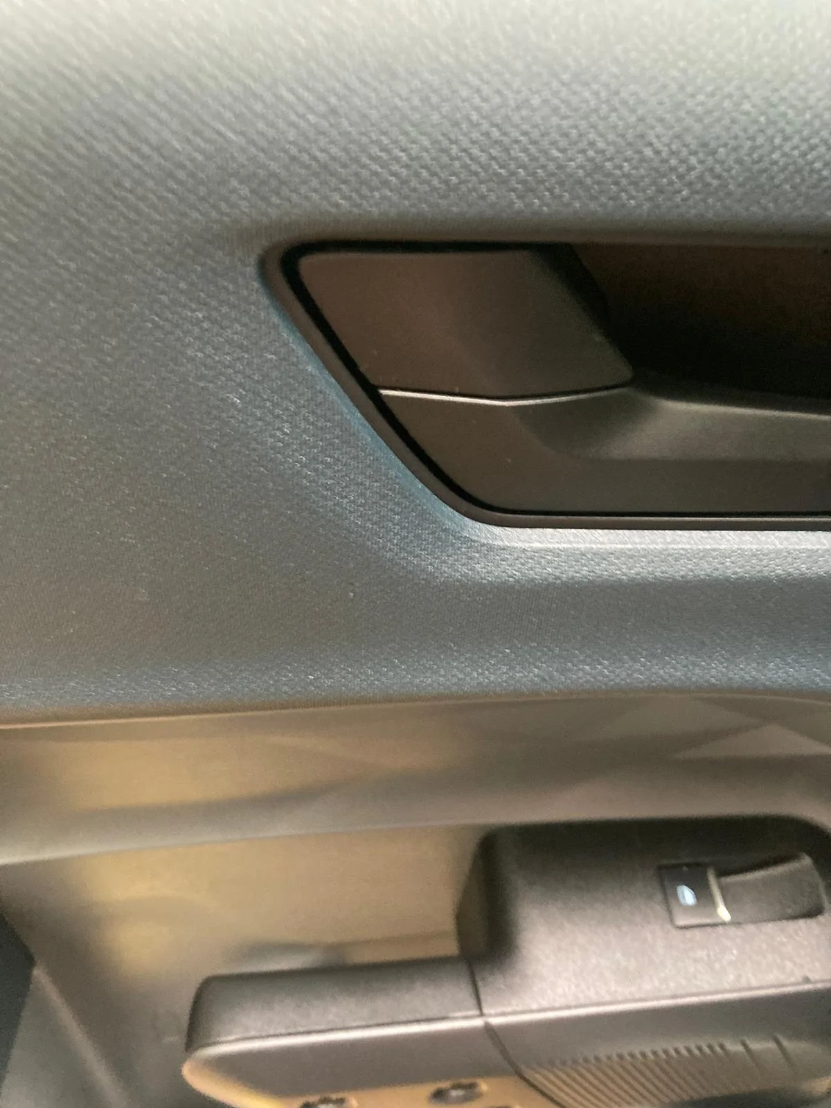

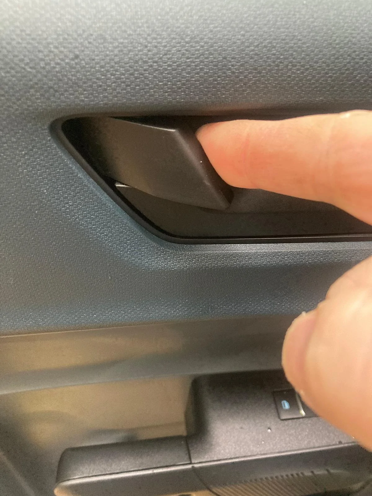

If your not trolling here is how you unlock the backdoor no power needed than you can just open it from outside. if child locks are on
Carlitos_92
Mar 24, 2024
2,273
4,602
Lol, if that is directed at me, no I'm not trolling, I'm just dumb. ;)
I did not try that because no has specifically said "unlock the manual switch on the door and then try it from the outside."
The pics are overkill, but you are correct. Thanks.
