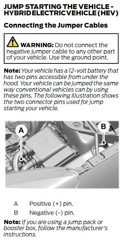

Take out your manual and make sure they know they are jumping a hybrid and not to jump the wrong point(s). There’s a black boot on a point with a no-jumper icon on it. Don’t use that lol. But it’s right next to the proper 12v point with a red boot on it (I think?). Anyway, just watch em and make sure.
https://www.fordservicecontent.com/...d=8431&vFilteringEnabled=False&userMarket=USA

Got it jump started. Thanks so much for your quick reply with the detailed pictures, it was good to know he was doing it right. He used a separate battery pack. He definitely knew it was a hybrid.
