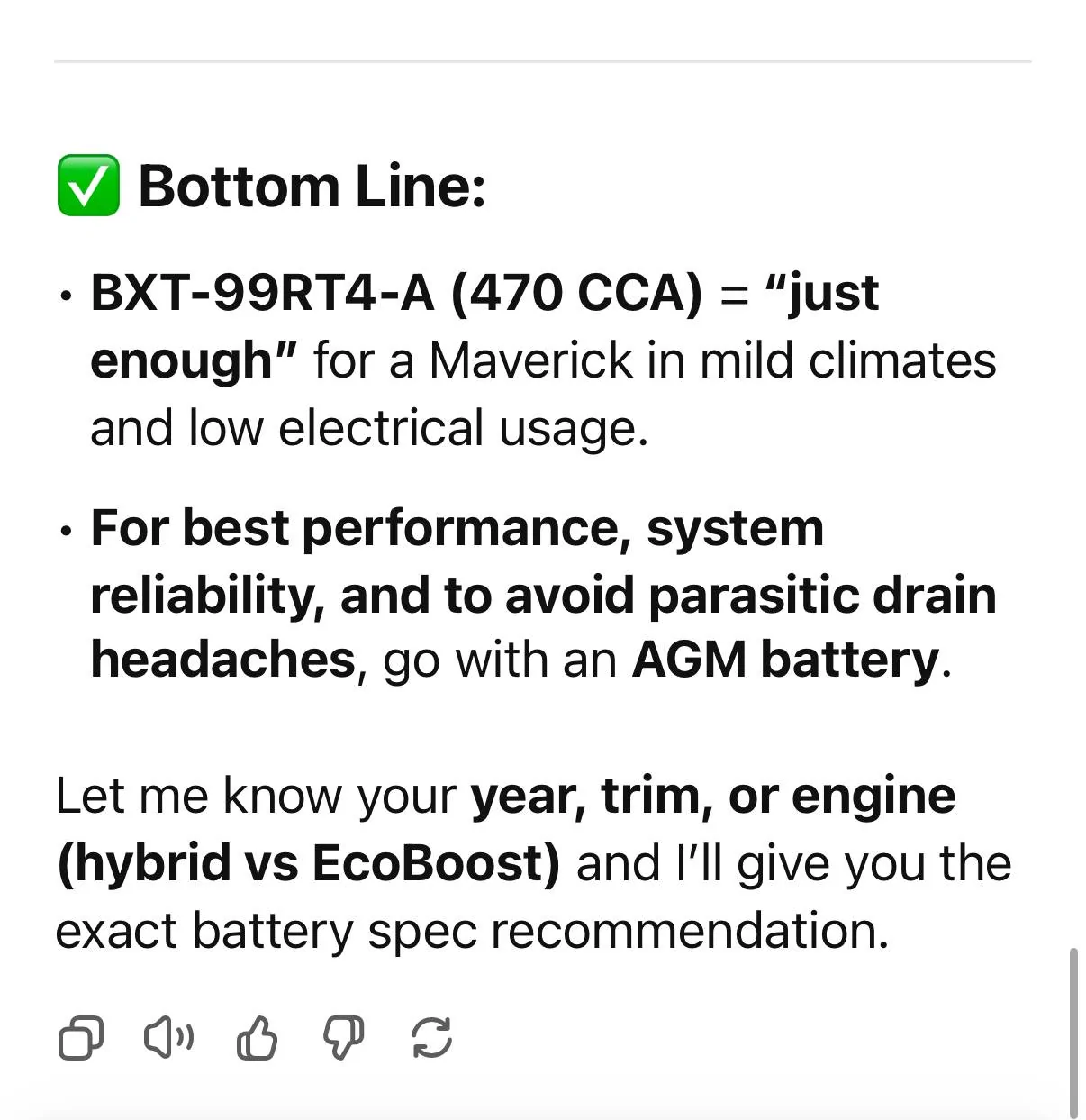

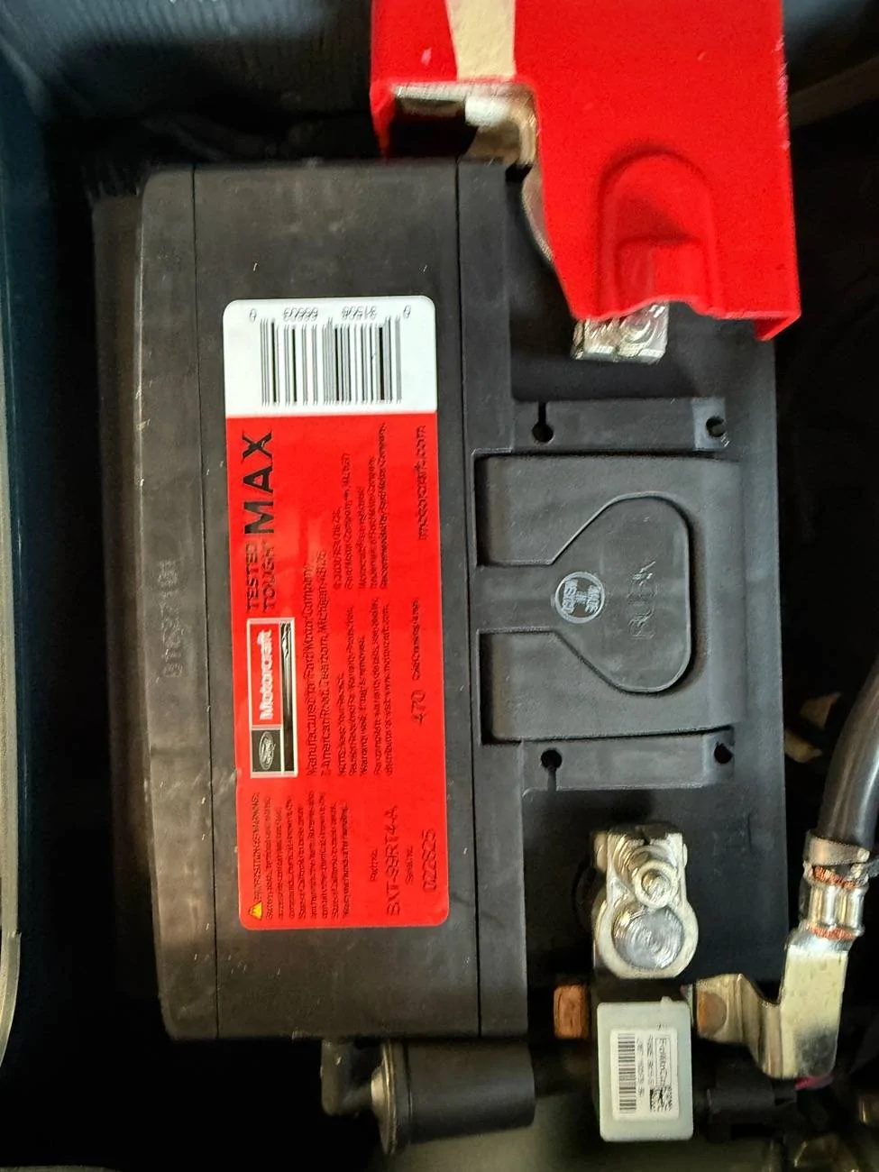

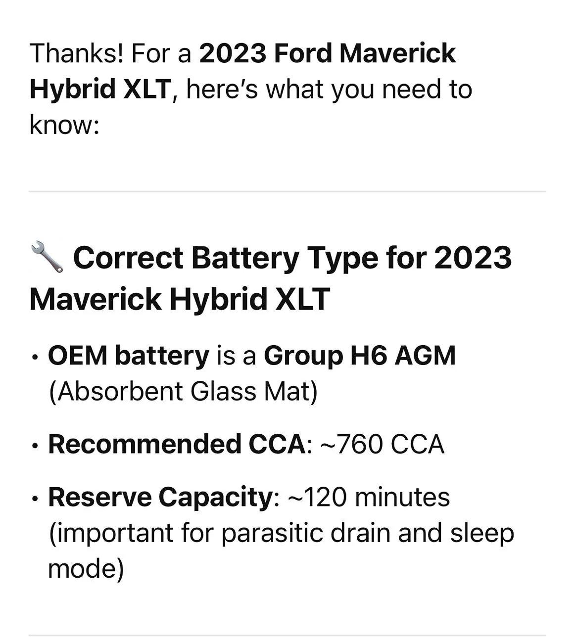

Well, took the Maverick in for the second set of recalls (back up camera, windshield wiper, seat belt). Told dealer battery drains, goes into sleep, needs to be jumped time to time (maybe), and can’t use any of the remote tools like if my kid wanted to find my car, they couldn’t. I thought it was worth a shot reading so many disappointing stories about the battery. They tested and found “battery load test battery fails final voltage”, replaced it with a new
BXT-99RT4-A (470 CCA) model. I’ve been using ChatGPT lately and in my mid 50s, I didn’t want to, now I’m hooked at how amazing it is. So I searched the battery for the 2023 Maverick and it says this. 😳🤔 at least I got a new battery to see how it goes. Old one went 19 months and didn’t have the horror stories I have read. Good luck to all on their battery issues.
