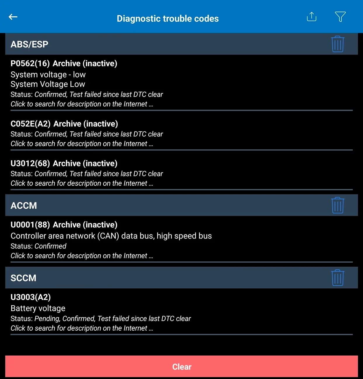

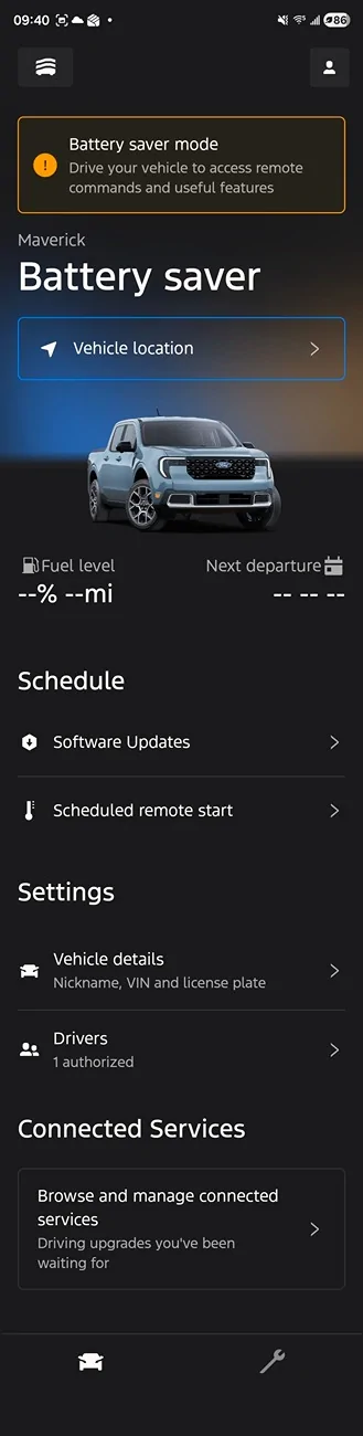

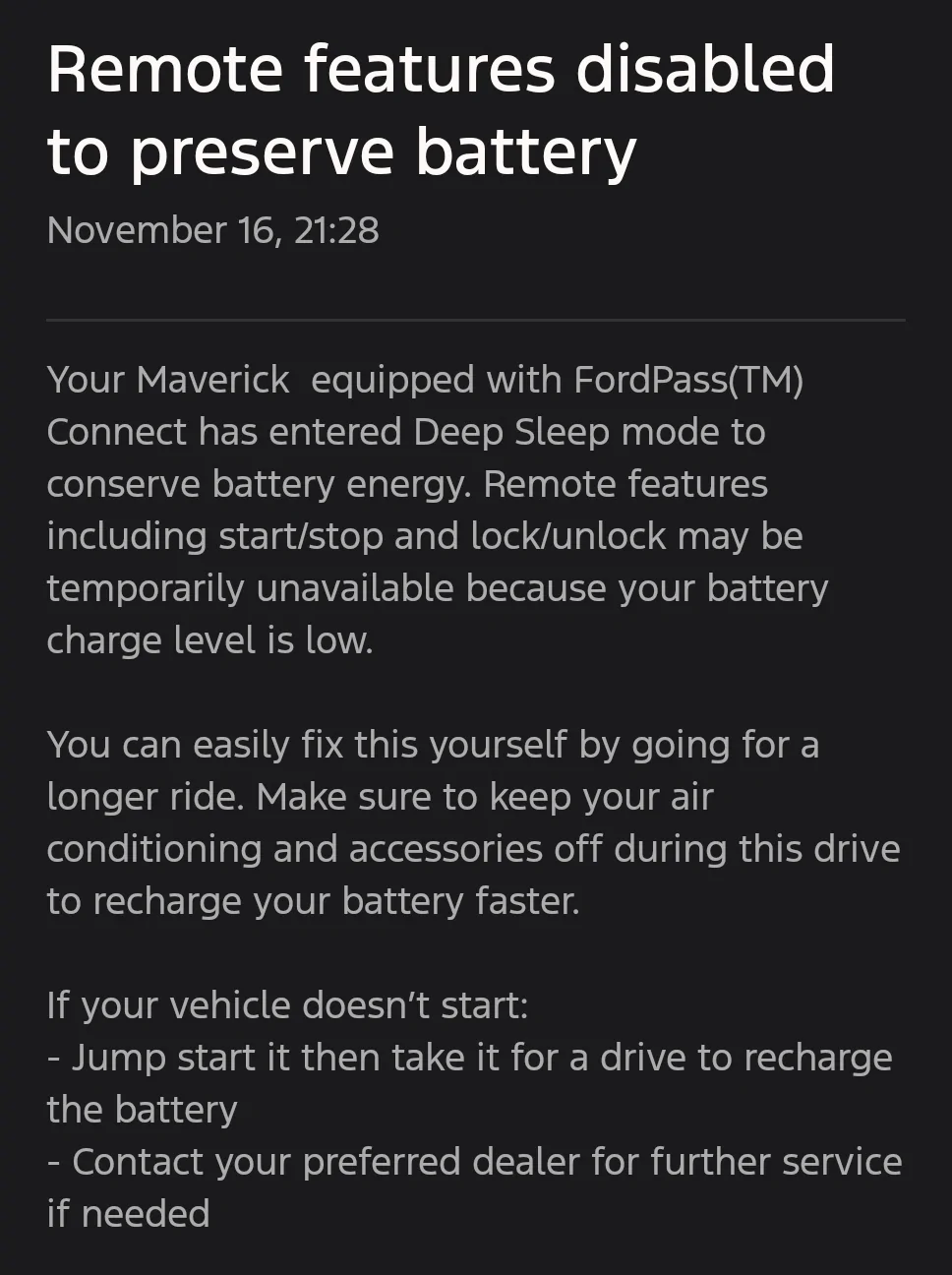

I'm absolutely annoyed by the '25 Maverick Hybrid 12v battery discharge issues. I had the battery charged to 12.3v and tested today after the fourth battery saver alert in five days. This time the battery was at 6v and the truck was deceased. I made an appt with a different dealer after the selling dealer had attempted to convince me my 12v accessory phone charger and OBDII reader caused the low battery warnings last week. I have to take a friend to the Dr. in the morning so I have my little 6amp battery charger hooked up and charging all night long. This is absolutely ridiculous! My 2014 Fusion hybrid would kill its 12v batteries from time to time as well. I guess Ford still doesn't have their act together. 🤔
