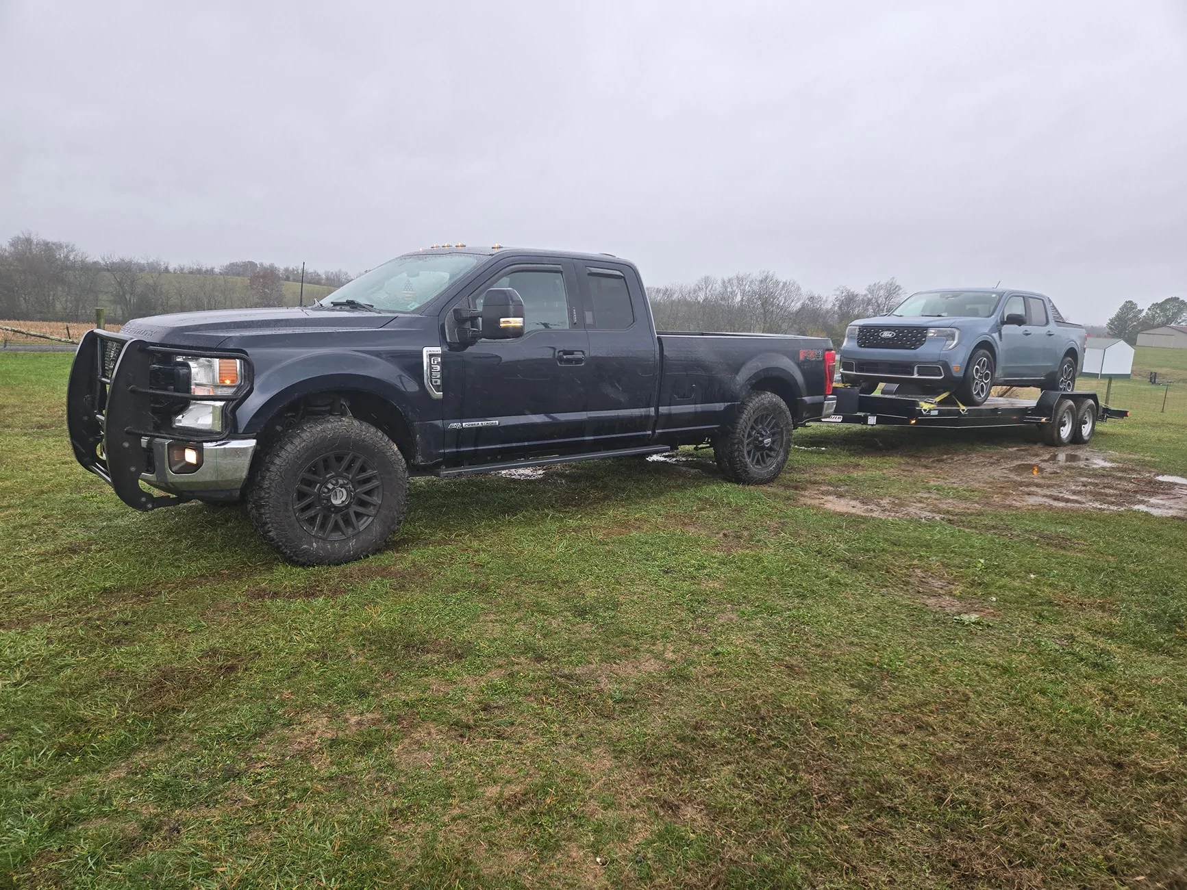

I'm absolutely annoyed by the '25 Maverick Hybrid 12v battery discharge issues. I had the battery charged to 12.3v and tested today after the fourth battery saver alert in five days. This time the battery was at 6v and the truck was deceased. I made an appt with a different dealer after the selling dealer had attempted to convince me my 12v accessory phone charger and OBDII reader caused the low battery warnings last week. I have to take a friend to the Dr. in the morning so I have my little 6amp battery charger hooked up and charging all night long. This is absolutely ridiculous! My 2014 Fusion hybrid would kill its 12v batteries from time to time as well. I guess Ford still doesn't have their act together. 🤔

Two dealers only checked the 12v battery. That battery is fine, it just gets drained. I'll see if they cleared the codes. I just drove 105 miles in the rain round trip to pick it up and bring it home. I'll get it unloaded and check for codes.

No time stamp available but I know they occurred shortly after the message on my phone. It went into battery saver mode at 9:28pm and was bricked by 7:00am. The overnight low temp was 31°F. I let Swope Ford keep it an extra day but the temp didn't drop below 48°F. I'm thinking seriously of installing one of my deep cycle batteries. I bought two group 31 on 50% clearance a year and a half ago and didn't use them yet. I trickle charge them now and then. I'm thinking of gutting the plastic under the rear seat completely and using both in parallel. That's about 2,000 amps cca total. I don't want to have to "Fiddle" with this again. It wastes two days with each useless trip to Ford.
