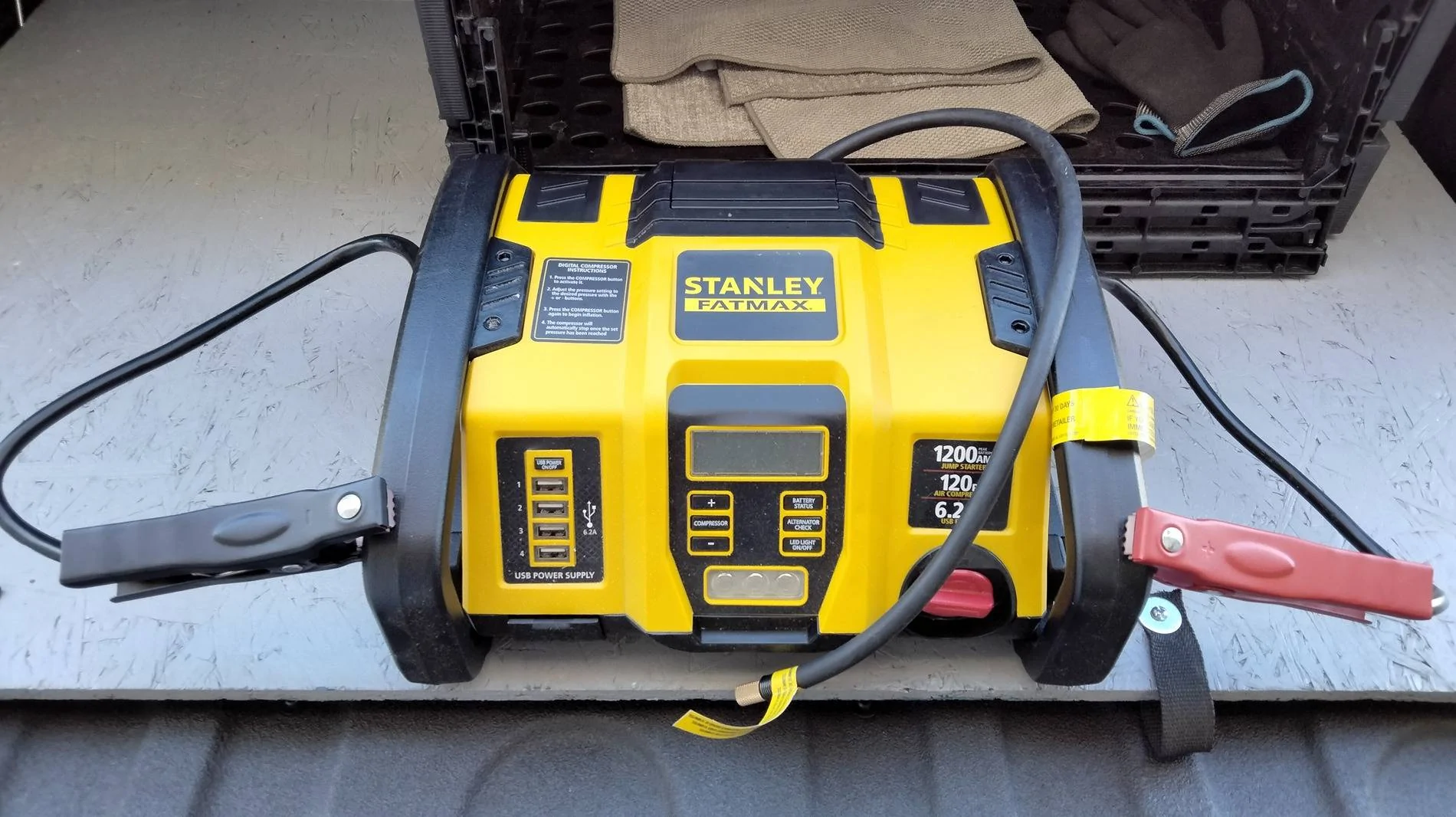

I haven't seen a newish vehicle in a long while that the standard battery cables would allow a backwards post battery to be installed, and still reach the correct side. I've helped out a lot of stranded folks with my jumper pack - or at least took a look to see if that was issue to help with.
Maverick is no different.
