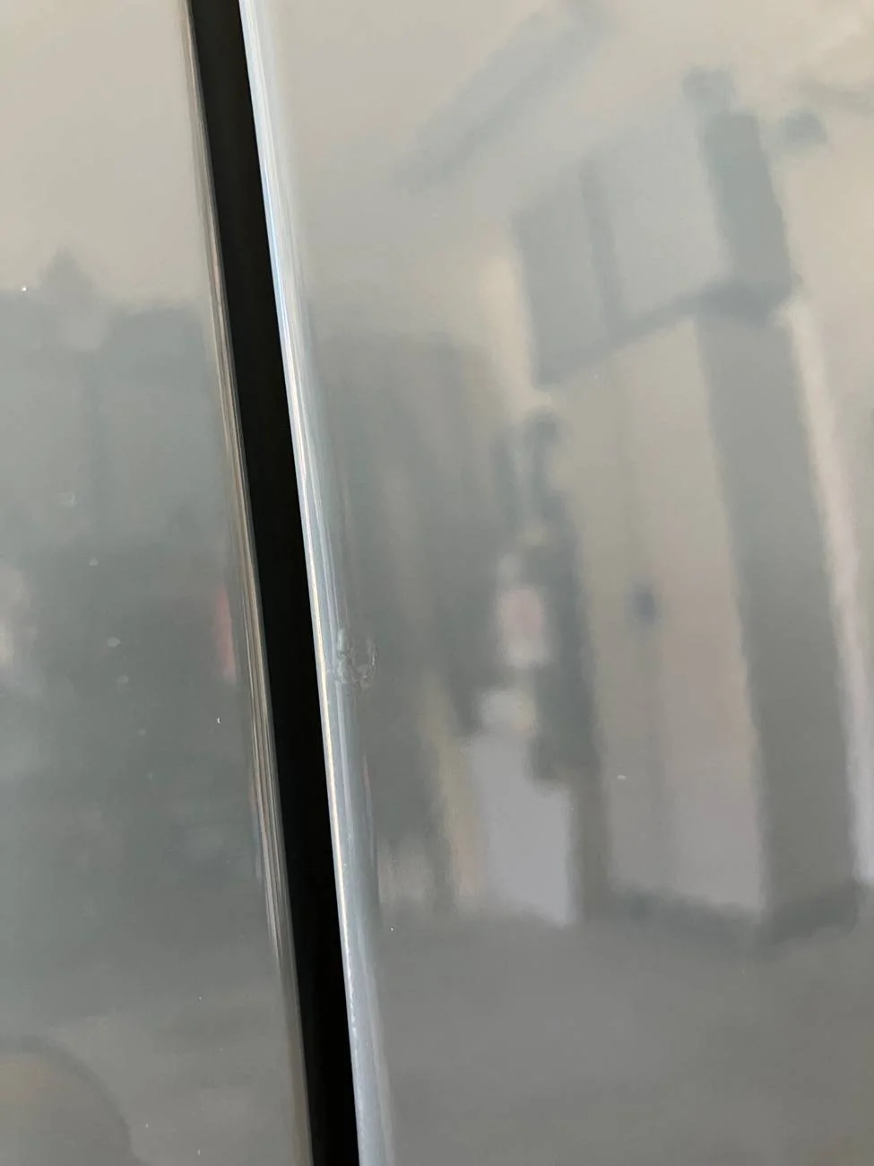

The big thing to decide is if you're going to put paint protection film on the front bumper and hood. Ford sells an accessory for it that has minimal coverage and is better than nothing, but you should plan to spend $500 - 1000 to do it right.
Once you start getting stone chips on the front bumper and hood, it's too late.

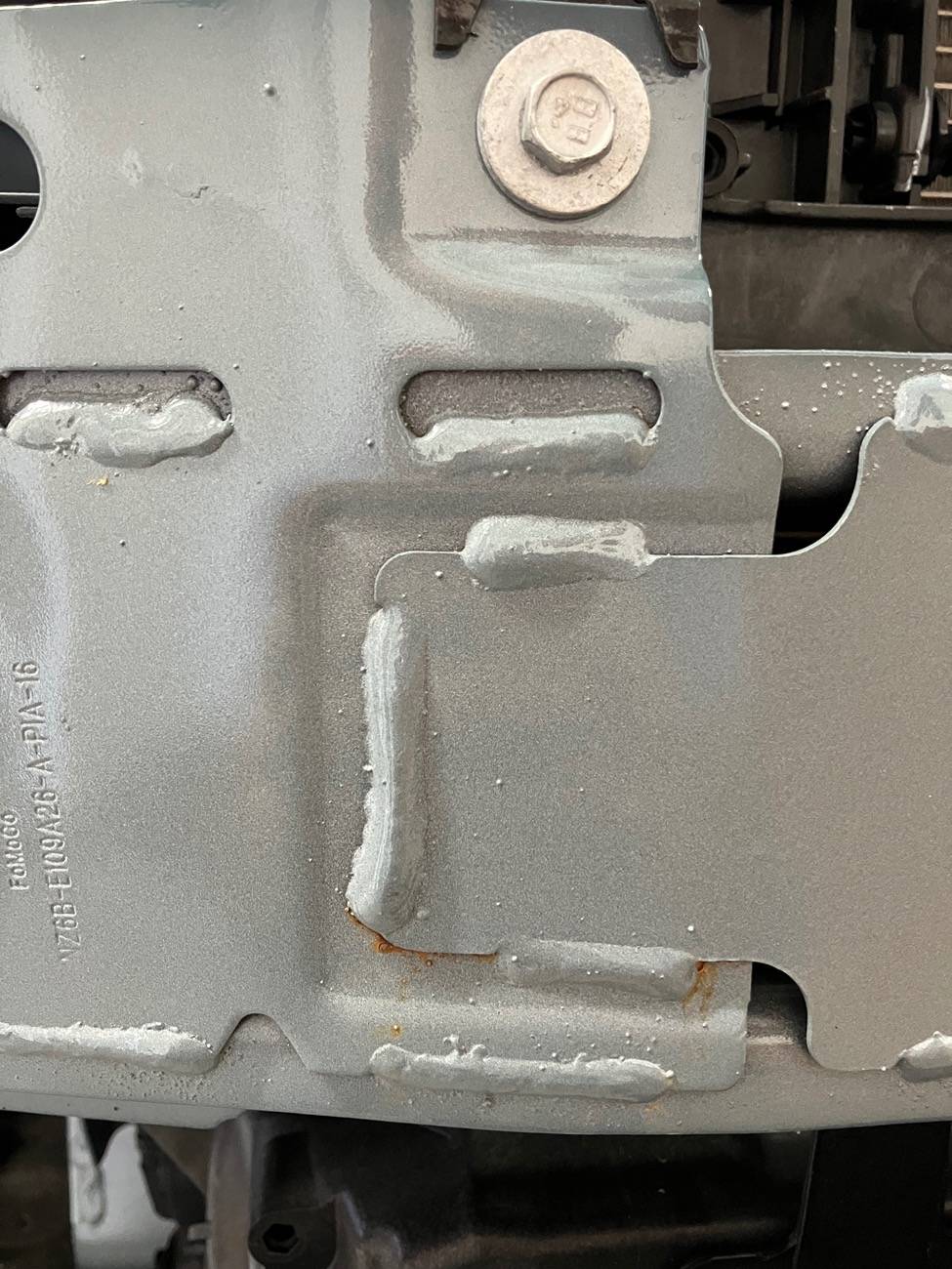

There seems to be no factory rust preventive to be found. I am in the rust belt and have sprayed mine liberally with Fluid Film after removing all the wheel well liners and underbody shields. There are many places to catch and hold debris and salt on these trucks. In my opinion, rust will the the main issue with these trucks in only a few years if left unprotected.

Rust protection is non existent. Fluid film the underbody.
