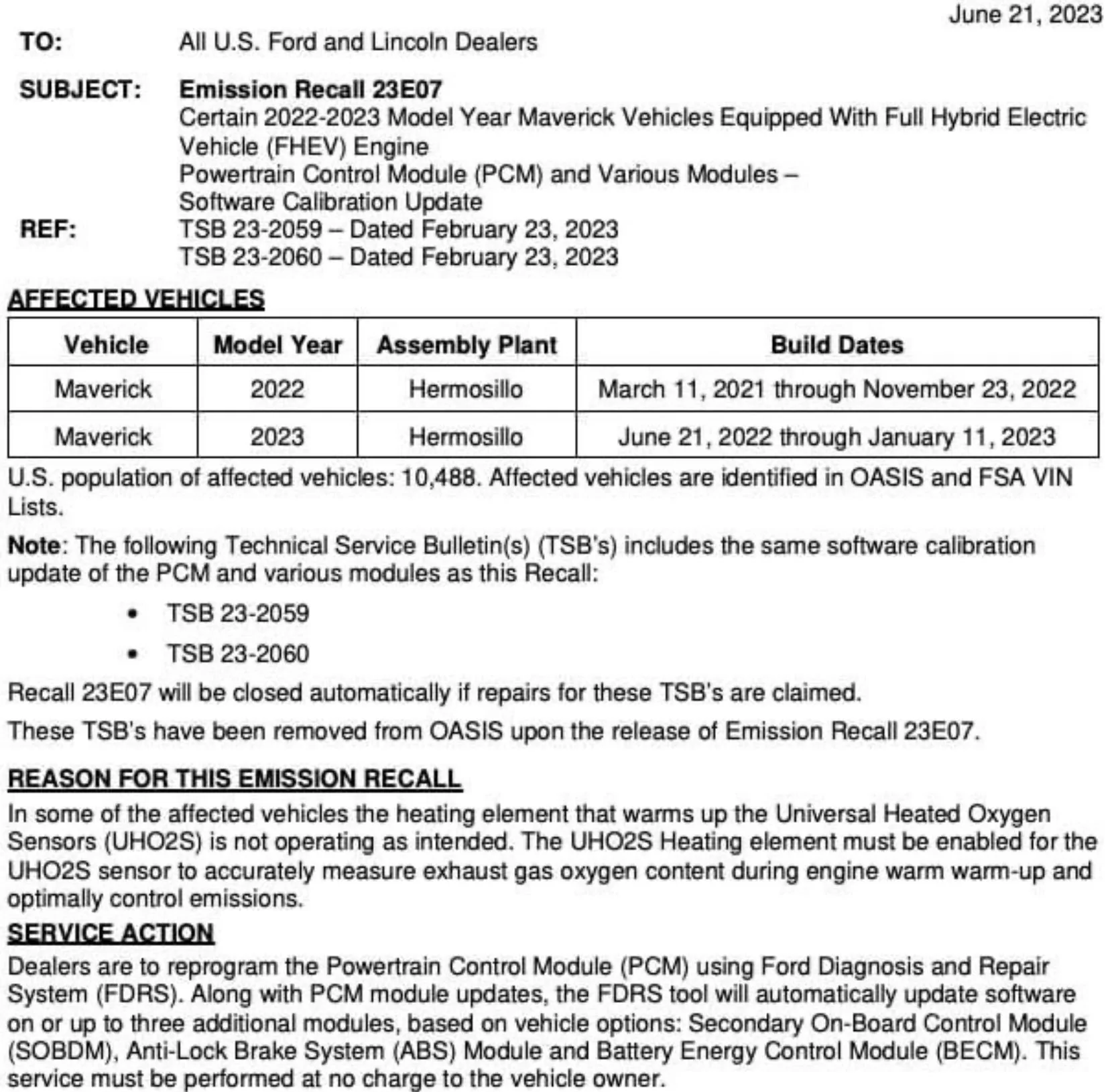

Hi all!
Some 2023 Maverick vehicles may exhibit a shudder or vibration when the vehicle is braking at 15 mph or below, when the gas engine shuts down and the vehicle is operating in electric mode only. This may be due to the software in the powertrain control module (PCM). We've recently released TSB-23-2209 which instructs Ford dealers to install revised software into the PCM to resolve the engine shudder concern. This TSB only addresses 2023 MY, however we are finishing testing for 2022 MY and will re-publish the TSB at that time. The dealer will need to inspect your vehicle to diagnose the concern and determine if your issue is related to this TSB. As a reminder, you can find more TSB information for your VIN, make and MY at https://www.ford.com/support/ and https://www.ford.ca/support/?gnav=header-support. Please let us know how your Maverick feels with the new software.

Ford Maverick Hybrid shudder recall {filename}
Recalls *
Description
Software calibration update
Campaign#
23E07
What the heck is this about?
