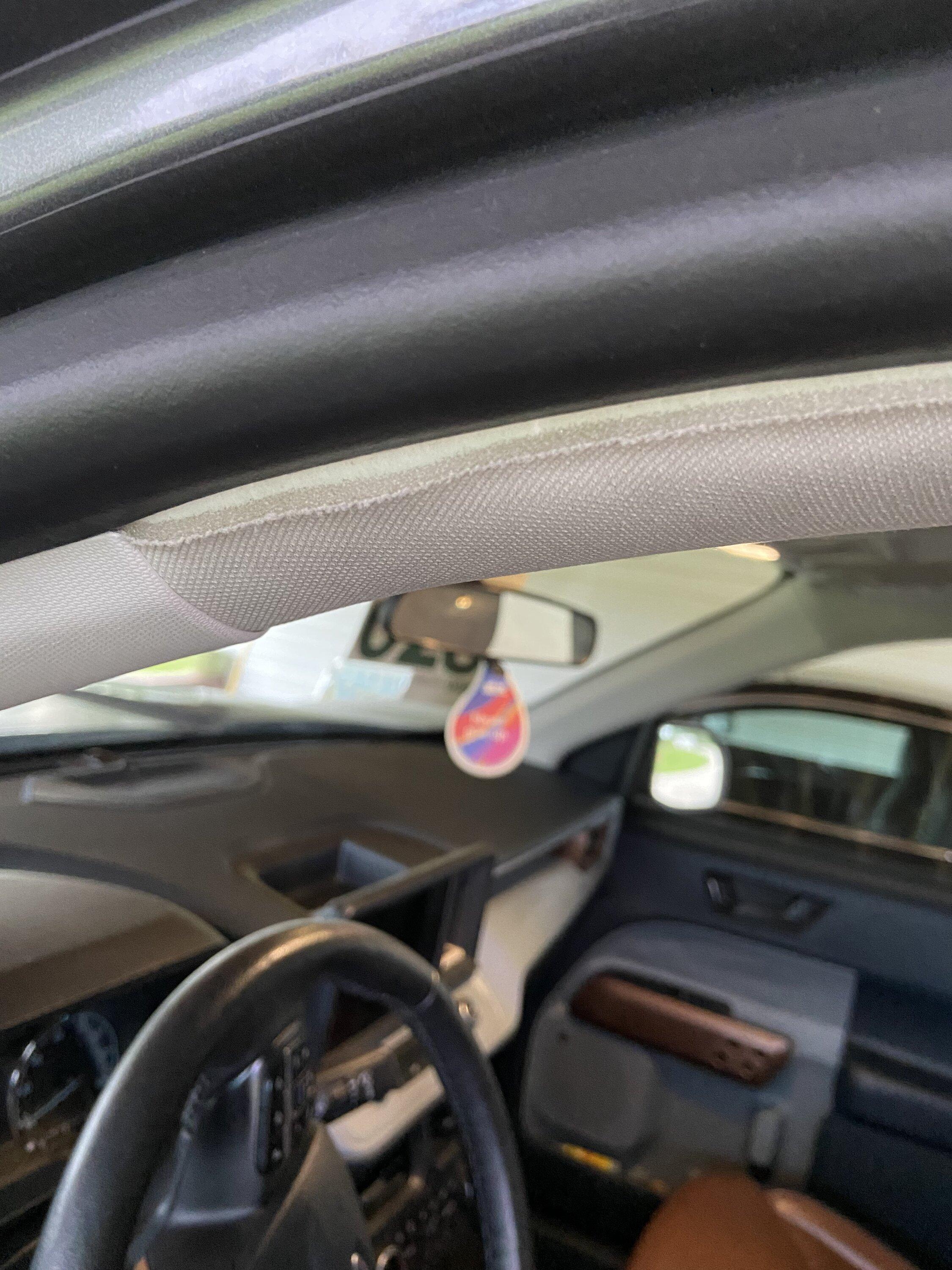

Update changed both axles it finally fixed the shaking and shuddering. New issue airbag recall new airbags are to big headliner hangs down past the weatherstripping. Truck sghe the dealer 7 weeks .

Finally Fixed both axles replaced. New issue airbag recall the new ones they installed std to big headliner hangs down past the weatherstripping . Just glad it don’t shake anymore.

That’s the same thing that was happening to my truck . It was at the dealer for 7 weeks . They changed both axles finally it’s fixed no more shaking/ shuddering. Hold off on airbag recall they put the new ones in but they are to big headliner hangs down past weatherstripping.
Odd I had the airbag recall done and everything looks as good as new - all put back right

Yeah no - I wouldn’t accept that, someone didn’t know how to put it back together right
