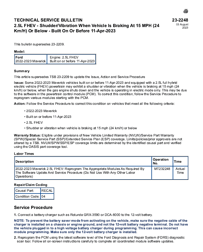

I purchased and took delivery of my MY23 Maverick Hybrid on 5/9
Drove it for 2 weeks no issues. Around 800 miles I started to notice the engine vibrations aka on here as the shudder. Took it to my local Ford service Dept and they took it for a drive. Noticed it and said it was normal. At first it really wasn’t terrible but sometimes it was bad then it would usually be nominal.
Well since about 1200 miles it progressively got worse. I now have 2400 miles on it. Had a buddy of mine who works for ford take it for a drive. Told me that he doesn’t feel anything usually.
I saw on here that Ford posted on one of the shudder issue pages that there was a software update - the TSB mentioned above.
I took it to the dealer today. They felt the shudder and did the update. The service advisor told me they reset a few modules as well and now the car acts normal after another road test.
Was excited to pick it up to say the least.
I picked it up and….
Well 20 mins of driving and I can say it didn’t do it once. In fact I think that in eco mode it regens harder than it did before. I could be wrong but it did feel different. So far so good. I’ll report back in a week if anything changes.
