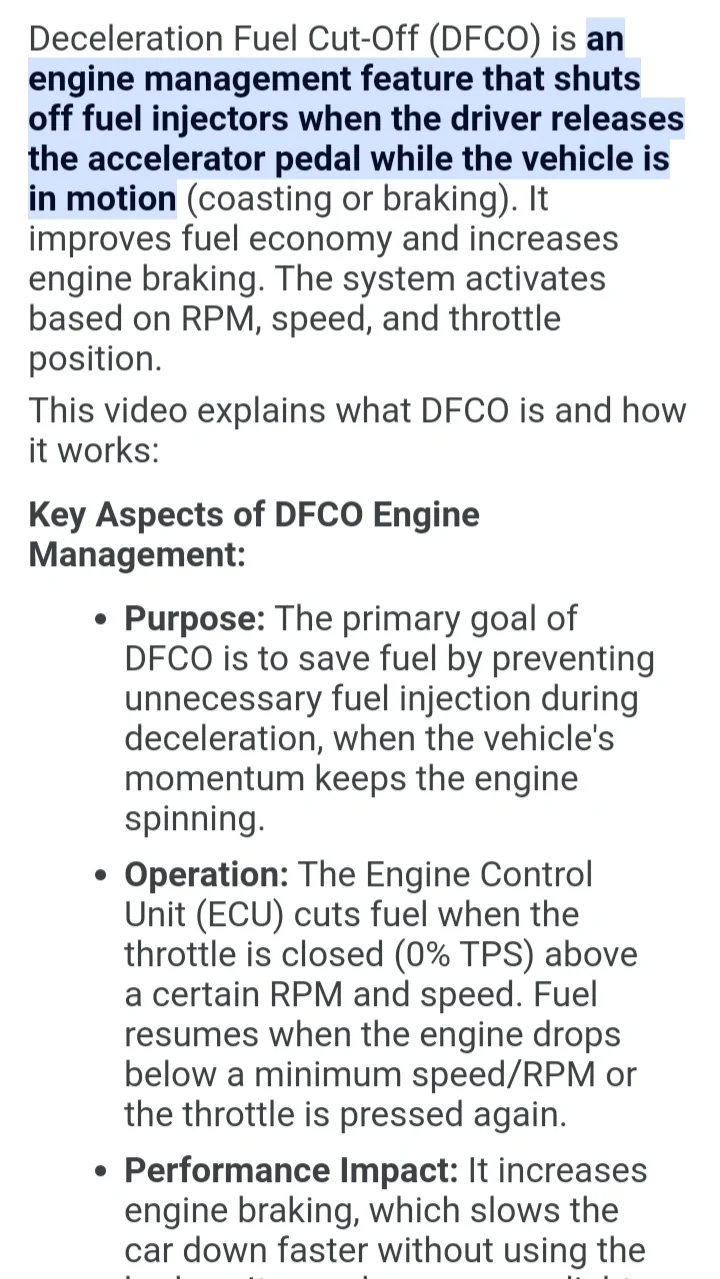

I did not know that. Does the ICE actually fire up? In other words, are the spark plugs sparking and fuel being injected and burned just to slow the truck down? I hope the answer is no. ✌
Will,
Deceleration fuel cut off was basically implemented around 2010 on fuel injected vehicles.
Here's a little more information.
Ford Maverick Hybrid Revs Coasting Down Hill 20260208_083725
