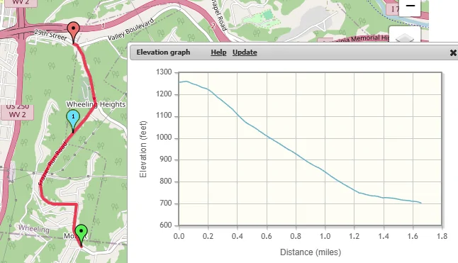

HeyBales
May 3, 2024
5,660
5,515
KC Metro area
Not sure what you mean.
Not sure how else you would do it.
You want nothing but friction brakes going down a hill? That's exactly what you'll get in the "N" position.
But that also gets you overheated brakes and warped rotors.
Yes, that's what I meant - there is ability to do it.
But automatically, without having to shift to neutral.
And some engine braking can still be done, perhaps not at a higher RPM.
Other cars going down that hill with me are surviving some how.
I'm sure because there isn't a next lower "gear" to select to help, there has to be some auto-assist in the matter.
I'm not talking 20 mile long steep decline either where brake trouble could occur - this was maybe 2 miles and not that steep - just happened to have full HVB because of the drive up.
I'm sure like the decision for normal 10% max power for EV, or when to drop to 12V float charge - they had their avg driving scenarios they engineered to. They changed the 25MY to 15% power (yes bigger motor) - so they do change their minds on some of those.
The hill:
Ford Maverick Hybrid Revs Coasting Down Hill 1770697427303-2g
