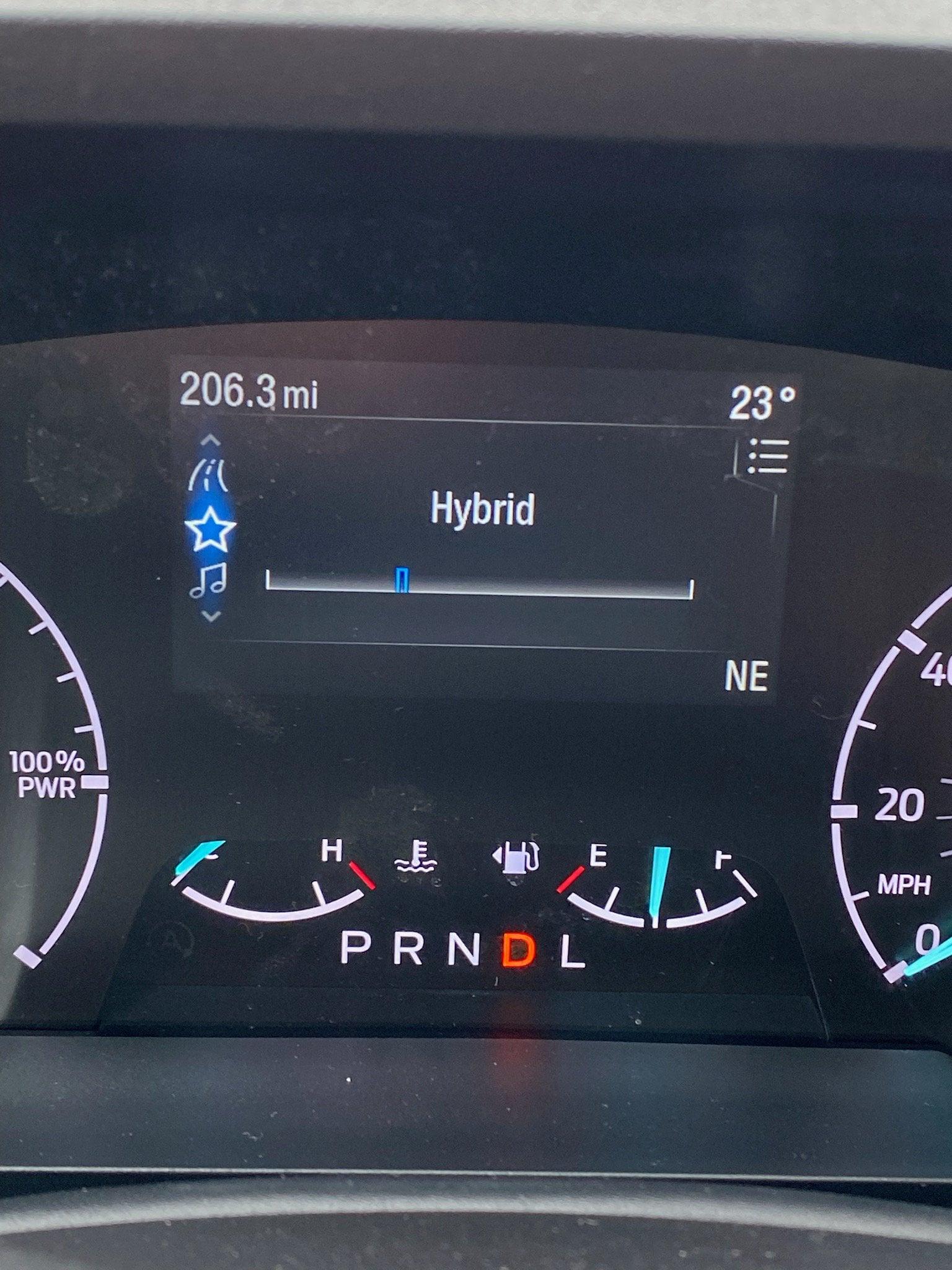

This particular drive is to work. This morning it was about 38 degrees. It is my first hybrid, what I have been focusing on it the ā€œinstantaneous mpgā€ reading as I have been trying to find the areas of my driving that are in electric. My overall mpg is around 45 since I’ve had it. Last week I was around 50, however since last week I’m down to 46. I know it’s a silly complaint, but my frustration kicks in when things aren’t consistent. This drive is about 7 miles in total.

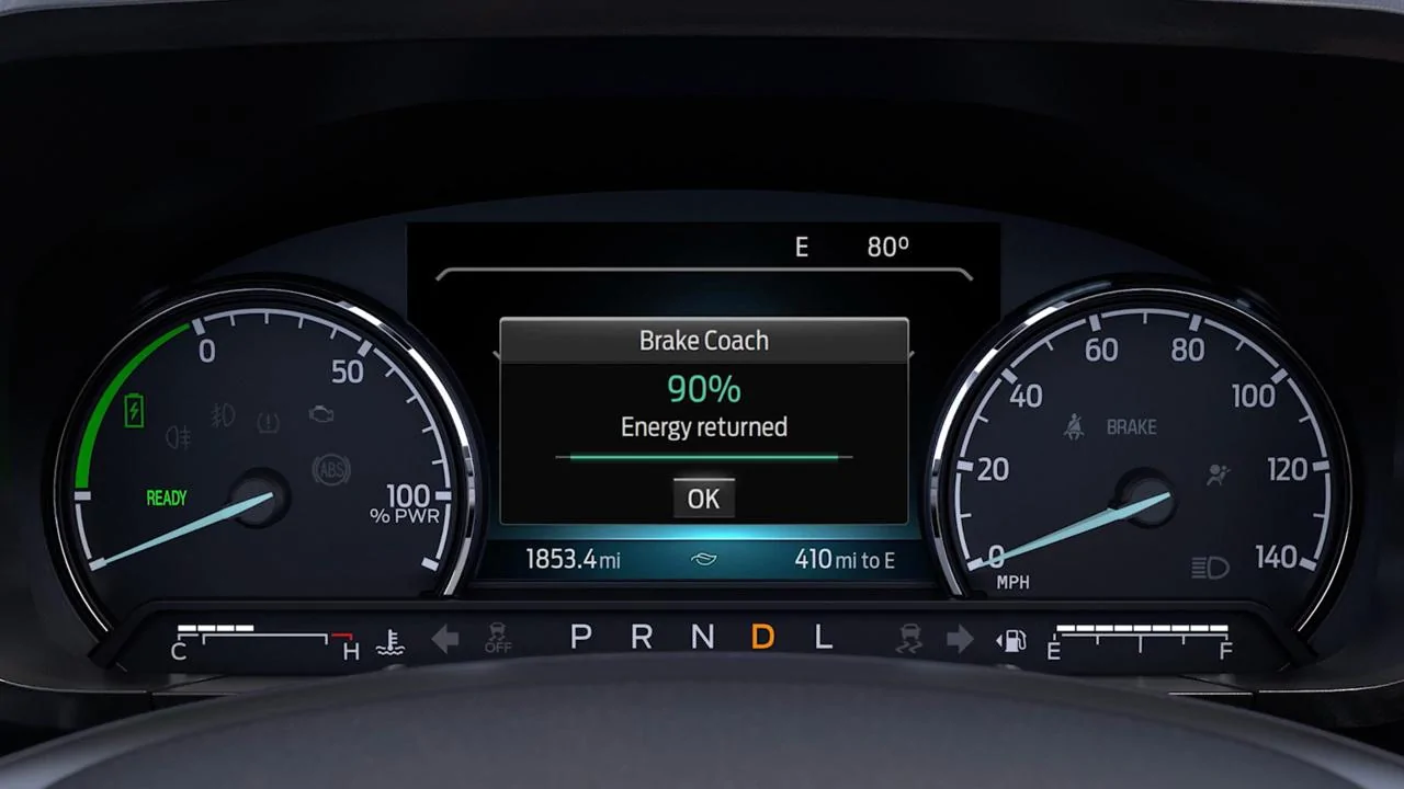

The EV coach aka brake coach is a good tool to use for real time. When I’m breaking I work to keep the bar out of the white all the way to the stop. It will help you to gauge whether you are breaking too late or too hard. If you keep out of the white when breaking you will get 100% energy returned each time.
When driving try to keep on the blue and green as much as possible but really if you are getting the milage you claim upon fill ups you are doing quite well. Ignore the real time mph.
EV coach and brake coach are different things. EV coach is a specific display, with a bar that will display blue for EV, white for hybrid and green for regen braking. Brake coach gives you a score, out of 100, after completing a complete stop (or very close) and pops up on the screen for a couple seconds.
Well isn’t it the same screen? Please share.

Ok I s
Brake Coach is an overlain "pop up"
Ok I see what you are saying. Yes as long as you don’t let the EV coach go in to the white when breaking you will always get a 100% brake coach score.

EV Coach & Brake Coach are two different screens. You can enable/disable either or both of them separately, in the instrument cluster settings, using the steering wheel menu. They also display differently in different trim levels.
100% on the Brake Coach (when reaching a full stop) means that you used Regenerative braking for that entire braking event. IOW, you used motor/generator 100% to stop, so all of the braking went to charge the battery and none of it was wasted by friction braking with the brake pads.
Learning to use the Brake Coach will save fuel. And you might go 200k before you need that first brake job. Keeps your fancy wheels looking cleaner longer, too, due to significantly reduced brake pad wear.

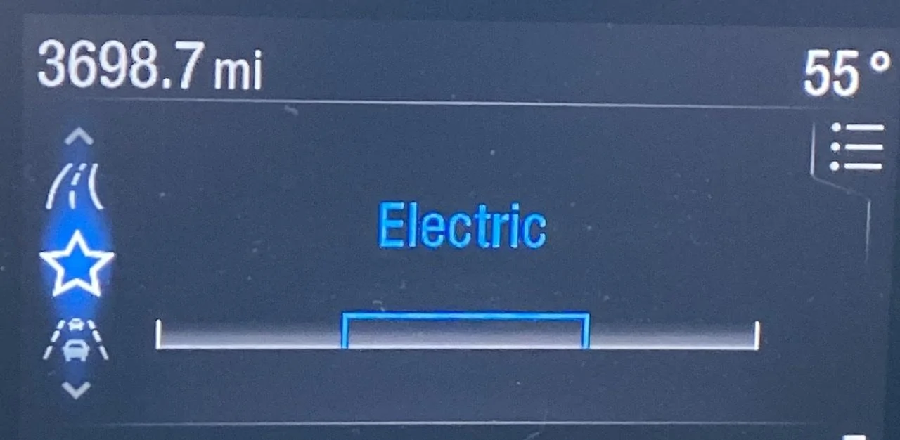

I've only put on about 450 miles on this thing so far, but I've noticed with slightly hilly conditions (and occasionally on straight aways), if it's chugging away on hybrid mode (ie, gas engine is on) and doesn't seem to want to engage into electric, I find if I let off the accelerator just a bit and feather back on, it'll kick into electric mode far more often than not, then I can cruise in that mode for a little while.
For short drives, if I let it linger in hybrid mode the majority of the drive, I might end up with 24mpg or less. If I make more of an effort to engage the electric mode, then I'll consistently hit around 45-50mpg, with an all time high of 70.

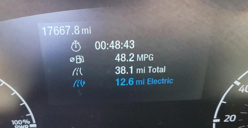

I have had my XLT Hybrid for about 2 months now. This week for some reason, areas that are typically run in ā€œelectricā€ are not, and it’s digging into my fuel mileage. Is this normal? Still not running air or heat, but stretches of road that had previously been covered in electric are now being covered in the gas and at less than 20mpg. Am I looking at a problem or has this week been an anomaly? Or worse, was the previous time on electric an anomaly?
Luckily, my other car is a Chevy Volt (PHEV) so I am not trained to drive "EV Style". I use cruise control, stay under 60mph and don't accelerate more than 20% (usually). The dashboard guestamater usually says I'm getting 44mpg, but when I do the math it's about 41mpg. However, yesterday with ambient temperature in the afternoon around 60 and using no AC or heat I got 48mpg on the guesstimater. I'll need to fill up this week and see what the real numbers are.
