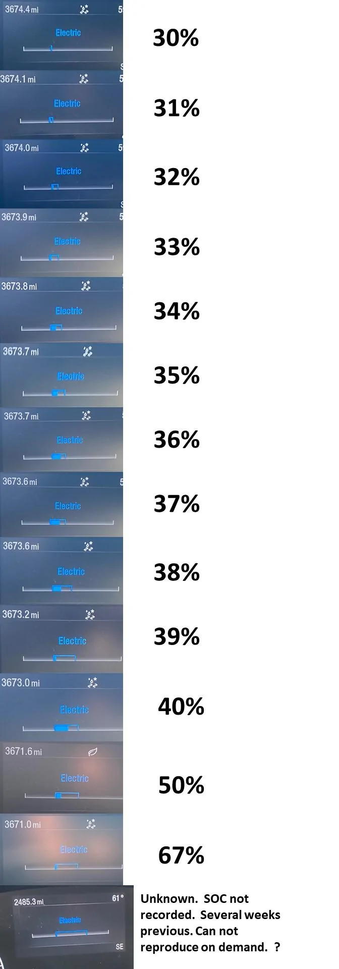

The blue bar comes on, on top of the white "hybrid" bar at battery 43% SOC.
I guess this is when Ford programmed in a little bit of "encouragement" to try and utilize EV drive mode. Implying "don't bother" when SOC is below 43% and gets larger as charge increases.
You can have EV all the way down to 30%.

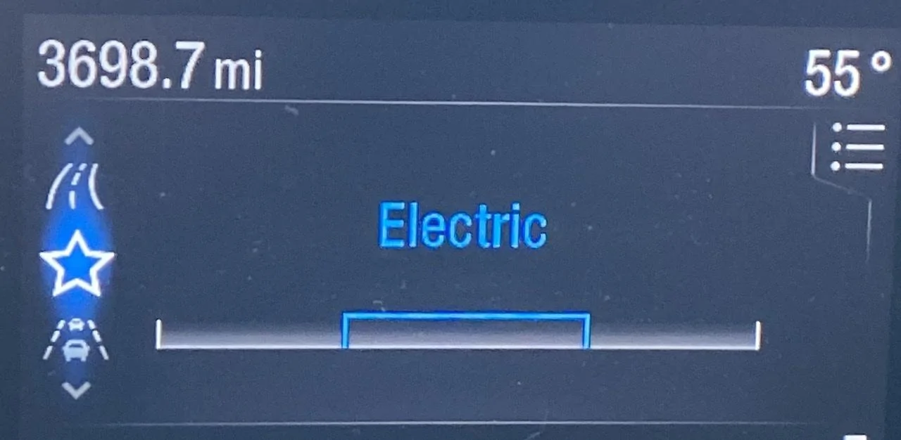

Seems I inadvertently created some concern. Here is a very detailed description, with photos, from my observations today.
Ford Maverick What’s your EV coach “blue bar” length? AC7C71A0-AB48-4B24-9046-7AC517CC03F4
New information:
I CAN create the long bar on demand. Many times now.
If you park with high state of charge, when you restart you get the long bar, but sadly; only the first time. But why?
The power output is up to DOUBLE the first time out on a start up.
If you park with high SOC.
70% SOC

The bar is showing how much power is available from the battery. SOC is the most important factor but battery temperature is a secondary factor. The ideal battery temperature is around 70 degrees. If the battery is colder or hotter, it will shorten the bar.

What you said can happen but it's not the only time.
The battery can be 30% to 70%.
The blue bar is really small 30% to 35%.
The blue bar is more or less "normal" size 35% to 65%.
The blue bar is really large 65% to 70%.
Guess where the battery charge usually is? Above 35% and below 65%.

Well on the lower end they give you a good idea of how much charge is left in the battery. But turns out, it's more of an early warning system of hey, you're about to run out of charge.
40% to 30% the bars shrink in a linear manner. Above 40% it appears they don't, so not much help except you know you are above 40%.
Kinda like the yellow lamp for low fuel.
Higher SOC (state of charge expressed as a percentage) means more power, just like more fuel in the tank, so yes, you can drive further on electricity.
