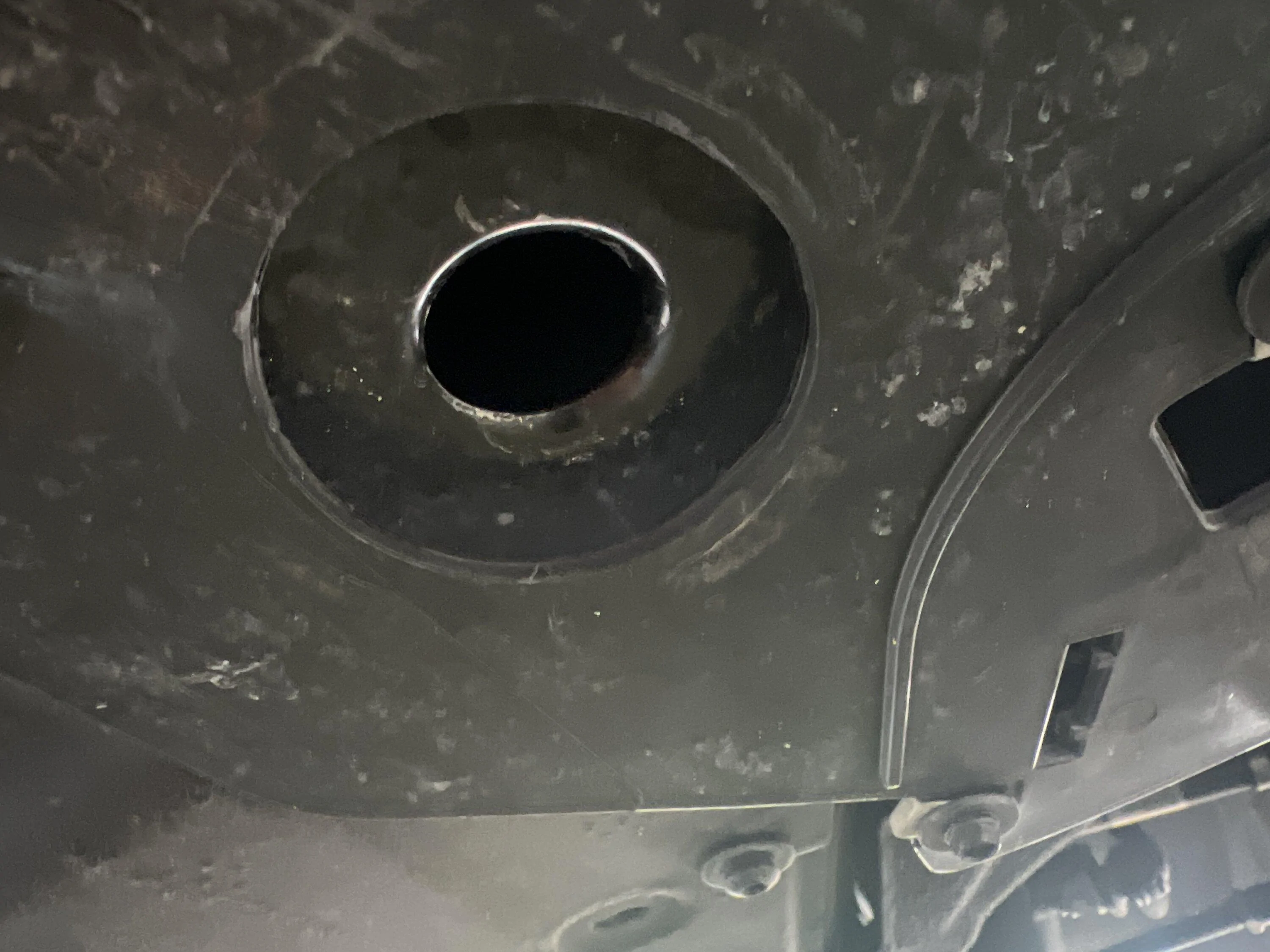

I agree with you on the fwd being the weak point. I really wish they would get an E-AWD system like the escape and rav4 hybrids have. in towing mode, the rear motor always being engaged would do wonders for that. Have you considered balancing the truck a little bit? for example, putting sand bag in the engine compartment as far forward as possible to counter some of the weight in the back? or is it not nearly bad enough for that?
Or maybe add some weight by bolting it to the two threaded "recovery" attachment holes, one on each side at the front?
Hybrid recovery holes in the front bottom are not threaded. I’ve used them.
Makes sense. I would ha ve lost bet on that because I remember being surprised when I looked at mine and thought I saw threads. I will look again. They are relatively small, at least on mine and too small for rivnut.
You may be looking too far back. They are right in front of the front wheel lip and look like this
Was further back. I was possibly looking at a threaded hole for rail transport tie down ?? Rear attachment for flat tow plate?? Thanks for pic. I am going to pickup my avalanche Tremor tomorrow and may trade my hybrid XLT in on it.
