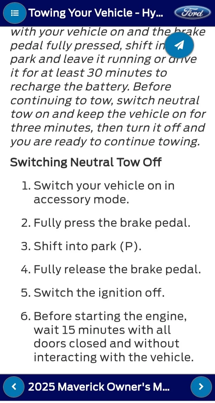

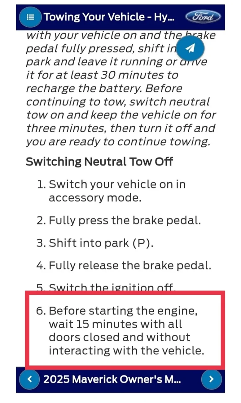

Getting ready to tow my 2026 Hybrid for the first time after installing base plate and wiring. Does anyone know why directions tell you to NOT start the engine for 30 minutes after exiting tow mode? You almost always have to move it after disconnecting the tow bar!

We have a 2025 we flat tow and I have never done the 15 minute wait, we disconnect and drive to camp site and have never had any issues.
Denny,
I'm not doubting you.
I'm just saying.
I wonder why they put it in the manual🤷‍♂️
