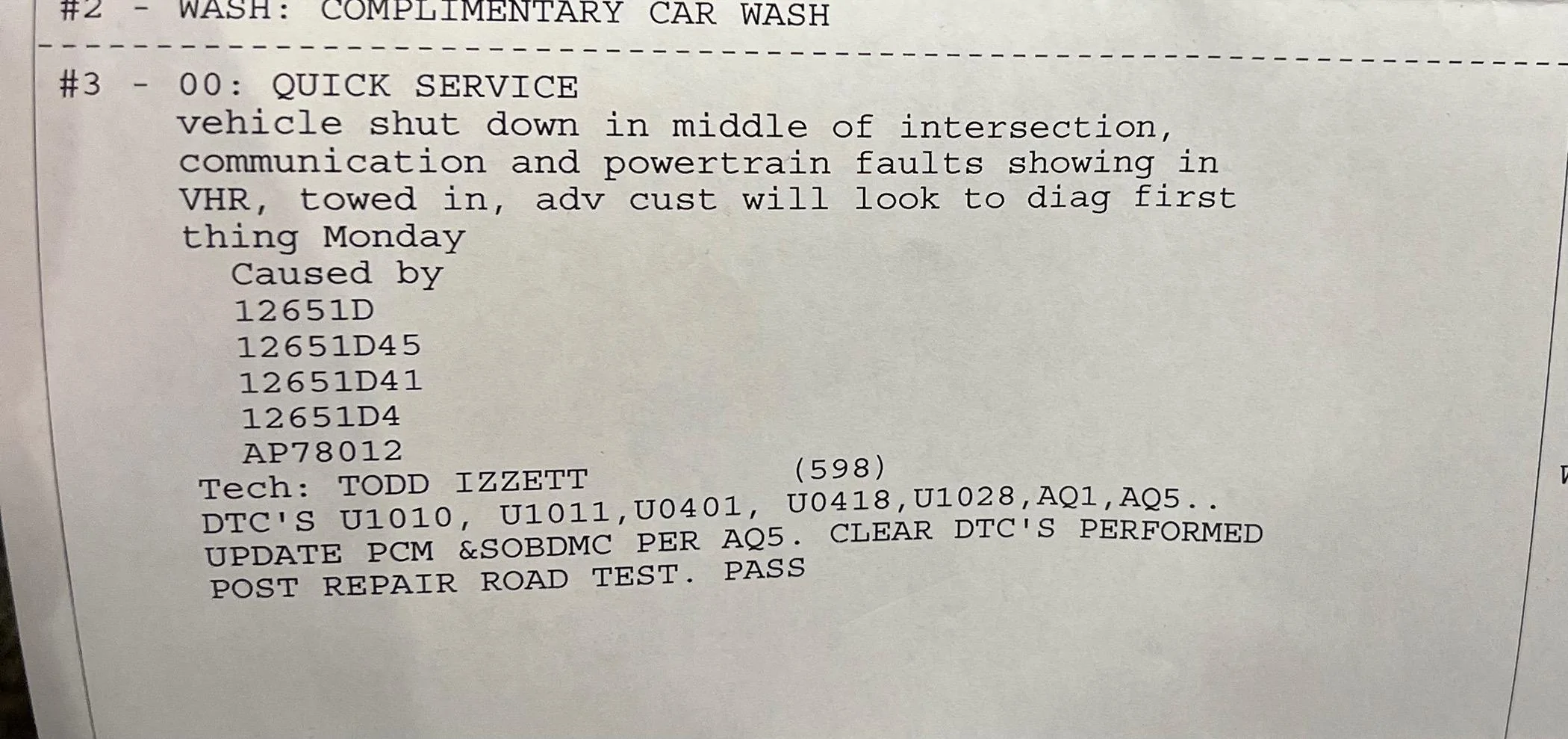

Got this service done 4/16/24 after our truck’s hissy fit. Luckily we were able to drive it over 1,000k miles this week without incident. (Phew!)
What does update pcm & sodbmc per aq5 mean?
Is clear dtc just clearing the error codes?
