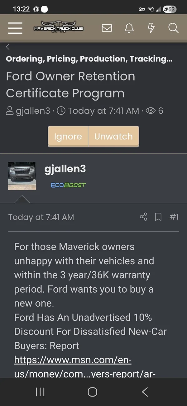

This seems to be an example where this could be a candidate test to see if Ford is doing what the article said, in this other thread from today.
Ford Maverick Connecting rod bearing finally caught up with me Screenshot_20251203_132231_DuckDuckGo
