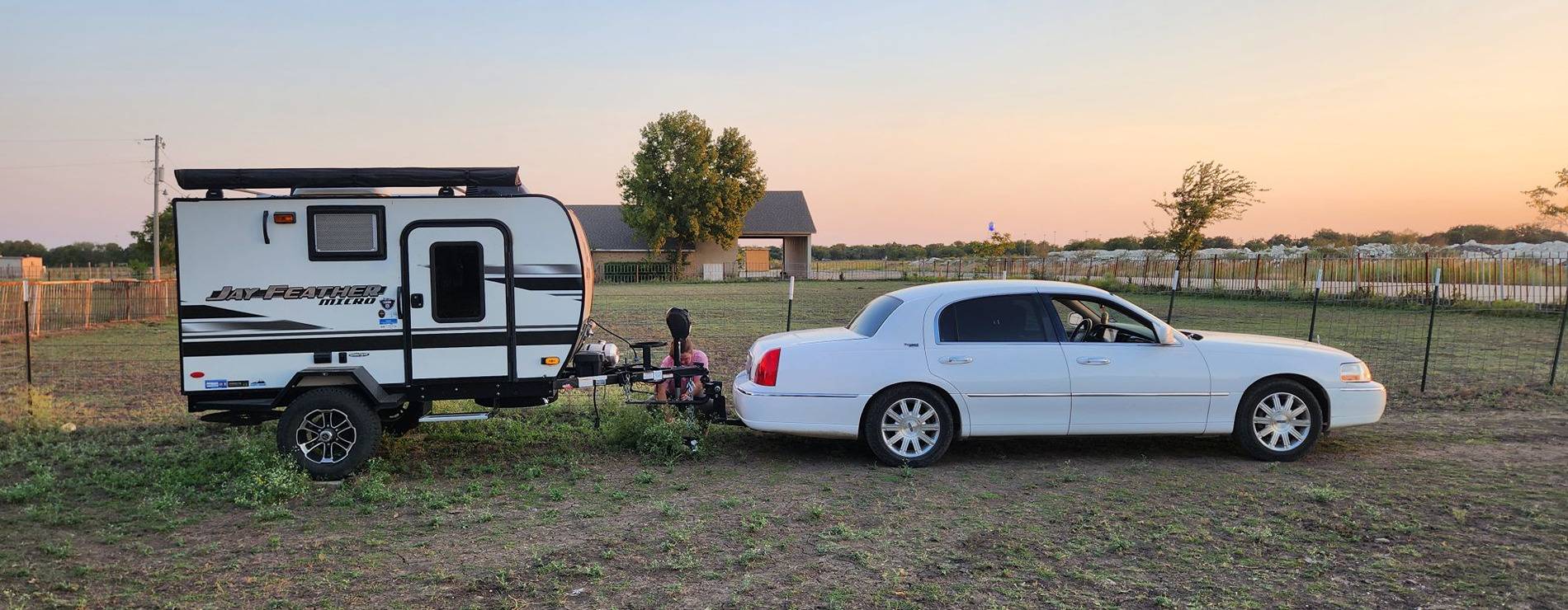

Ford 4.6L with 4R75W transmission regularly towing all kinds of stuff.
I'll be honest though, even with a better final drive ratio you really don't want to be trying to pull more than 4k with the 4.6L. The trans can handle it but the cooling capacity for the engine really cannot. I have taken this rig through several states and mountain passes without issues....That said I'm planning to upgrade to a 25 AWD Hybrid.

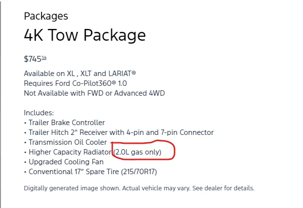

To add, anyone know how the new hybrid is magically able to tow 4000 pounds? The actual total power has not changed at all (same drive train/engine) and adding AWD doesn't increase power available. There are some minor suspension changes in the rear, but outside that, it looks like total power available wasn't the stopping block that limits the 22-24 hybrids to 2k.
there are major suspension changes to the rear and radiator
plus a new transmission.
