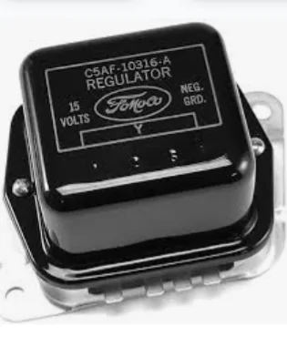

After reading through 7 pages of fascinating commentary that rivals the still yet unresolved mystery of UFOs, this one post tickled my fancy....
I am as old as Glen Baker so he might be able to relate a thing or two. Recalling back in the day (as in last century) when we had analog gauges, I remember every time I turned on the headlights, the BATT one would jump a bit before settling back into where it started from. And sometimes, it would jump and stay there. Sometimes the idiot light would come on, other times not.
Since we didn't have "compooters" back then, the only thing that would do this is the voltage regulator in the alternator. This would be a simple transistor that kind of act like an on/off switch to prevent overcharging of the battery.
While possible and perhaps someone more knowledgeable than the average DIYer, could something in the alternator be factored into the nuances of this discussion? What would happen one took the alternator out of the equation? Call me curious, but as a former forensic accountant, we always relied on addition by subtraction to narrow down the clues to the end result.
Wasn't that one of the jobs of the old school alternators . . . regulate the voltage?

My 65 Mustang, 70 Challenger both had alternators but we're equipped with separate voltage Regulators. Mounted on the firewall or on the fender🤷‍♂️
It depended on whether one had one built in. I believe it was towards the 70s and 80s when manufacturers started phasing them out from the mechanical ones to solid state to built in.
The point I was trying to make is electrical current is relative; like a light switch, it's on or off. The same with computers; their instructions are in the form of bits, 0 or 1. While there are so many things along its path from point A to point B, it still behaves the same in its raw form. No one has ever figured out how to harness it completely.

It depended on whether one had one built in. I believe it was towards the 70s and 80s when manufacturers started phasing them out the mechanical ones to solid state to built in.
The point I was trying to make is electrical current is relative; like a light switch its on or off. The same with computers; their instructions are in the form of bits, 0 or 1. While there are so many things along its path from point A to point B, it still behaves the same in its raw form. No one has ever figured out how to harness it completely.
The recharge rate used to be adjusted by changing the voltage only with the battery accepting what it will at the reduced voltage. Today the system voltage has to be increased to supply all current needed (wire size part of it). Since voltage is higher than desired as battery approaches 90+%. The bms has to limit current not voltage. There seems to be a difficulty in controlling current flow to that needed. I wonder if one possible answer might be a dedicated dcdc regulator (full "key on" time maintainer) on the positive battery post??? At least on hybrid although any time current flowed out of battery maintainer might restart depending on design(?). In any case if dcdc converter is supplying less than what bms wants for battery the on post voltage controller would adjust voltage from buss up or down???
