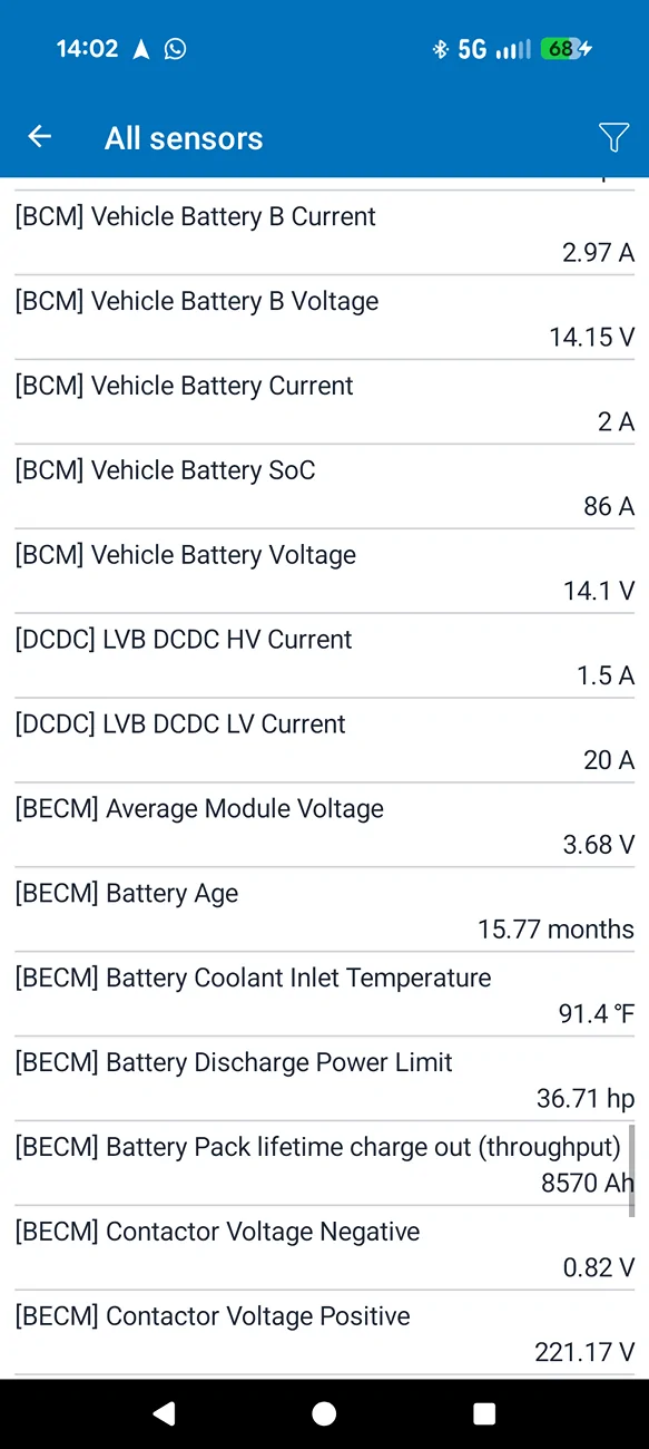

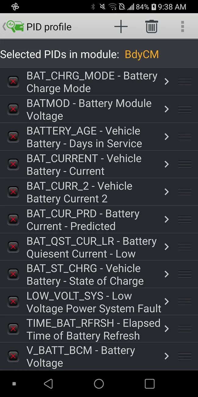

Search PIDs for BCM, as that's the module the PID's are under. Below is my screenshot of some of them.
Despite not having 2 batteries, Battery B (or 2 in Forscan) for Current & Voltage give non-whole number figures so are more useful to look at.
There is a SOH PID - in Forscan it contains no data but an error.
Correct on Vehicle Battery SOC being the other one.
The QST or Quiesent Current is also useful to see. It's the avg mA draw during the prior Sleep period, which is reached after your up to 60 min max period after turn off. 25-50 mA expected values. So it's good to see if everything is really as asleep as it should be. I'll see higher than that if doing errands, and the sleep period was brief, so high average and something must have still run. And when longer and higher, I'm guessing it was time for the periodic Relearn that happens.

@rslilly76 uses the same Car Scanner Pro, and here's from a prior post that shows some of them. If you can group a few useful ones together - won't have too much data. We both seem to have some overkill!
From this pic - B Current and B Voltage, Battery SoC (not sure why it says A), DCDC values are useful sometimes. And that QST I mentioned.
The BECM's are regarding the HVB - also useful if not just entertaining.
