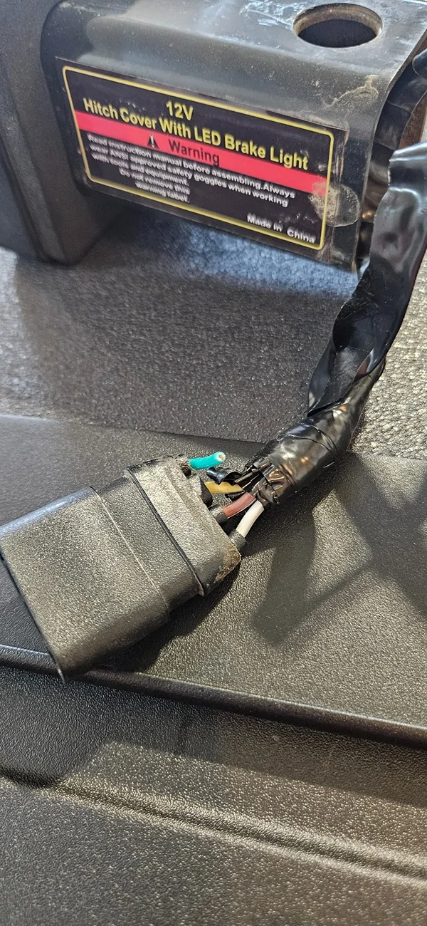

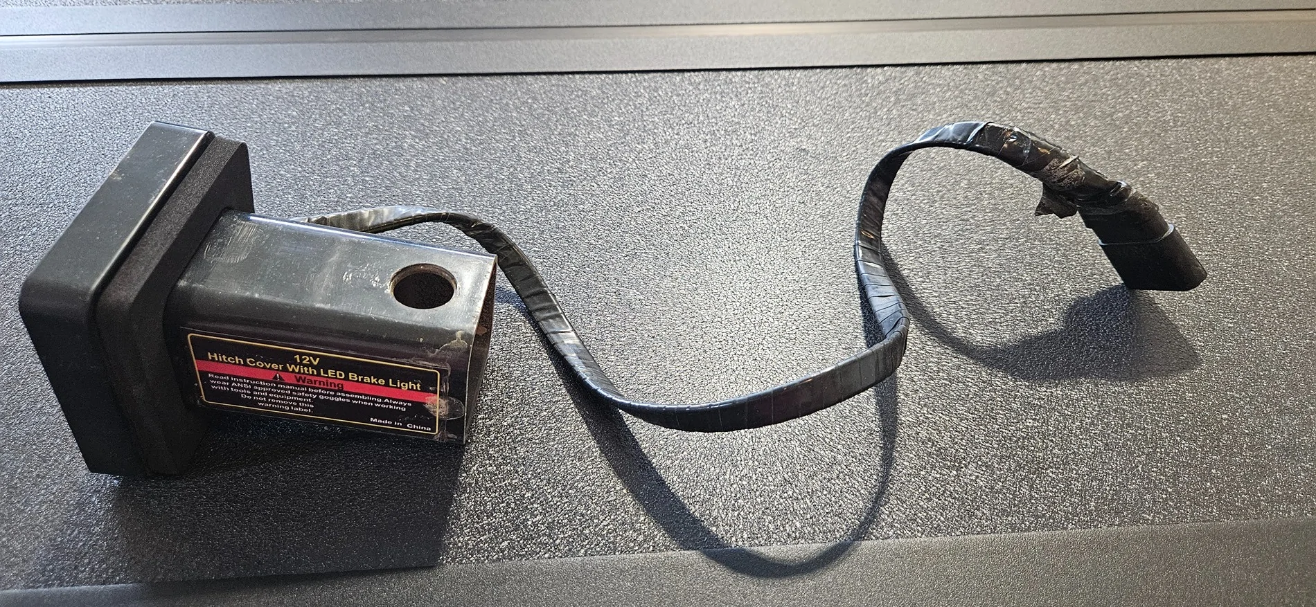

Thanks, this does help. So, if I follow, I want to be clear:
A) If you do connect the light, and you want to keep the backup lines (and the rear parking/backup sensors, if so equipped), you must cut 3/4 of the wires on the light wiring harness so that it functions only as a running light, not a brake light.
B) This light is only suitable to optimize battery charging if you're OK without the backup camera lines (and the rear parking/backup sensors as well). In this case you won't cut the wires because you need the hitch brake light to function to affect battery charging.
C) Which are the wires to cut?
Okay, check completed on what wire I cut to disable the signal lights...it was the green, and only the green wire.
Cutting the green wire on my hitch light (not truck wiring!) disabled the signal light function as well as the brake light function.
My Hitch light, as a result, only functions as another park light in my use case.
All my sensors and back up assistance is working and when I checked, my truck said "No Trailer Attached".
I then plugged in my 7 pin trailer plug tester (Curt brand)into the 7 pin trailer plug on my truck, and it registers as a trailer being connected, disabling back up assistance and I imagine the backup sensors.
I hope this helps, if you have any more questions you can DM me, or post here as it is all good.
Andy
Edit to add a photo or 2..which i forgot.

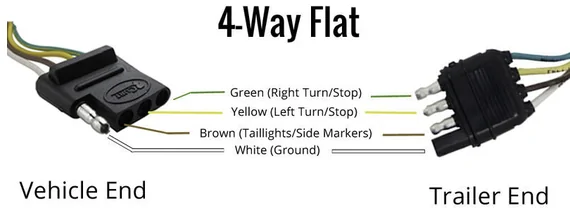

Errr... that should only have disabled the right turn blinker?
But this is brilliant. Connecting only the brown wire should do the job.
Indeed, the green/yellow wires are your right/left turn & brake wires. Brown is running lights, white chassis ground. My question is: for this to work to "trick" the 12v charging, wouldn't the parking or headlights still need to be On to provide power to the Brown wire, so it can draw a small current? Or does the mere presence of the plug attached do the trick without lights being on?

Good day @El Kabong and @KenE
I would like to reassure you that on my truck and 4 pin Hitch light I only needed to cut the green wire (as indicated in the photo I attached), you only need to cut the green wire.
Just the green wire cuts the circuit and both of the signal lights and brake lights are disabled.
As per my test yesterday (I had to interrupt my wife's knitting and ask for assistance) and with two of us I once again confirmed my results.
Also note that I believe doing this disables the hitch lights ability to help keep the 12 volt battery topped up!
I still turn my park lights/headlights on in the daytime to accomplish the battery top up as discovered by Mavster Mechanic.
But, if you insist on purchasing a hitch tail light like mine and want to cut the wires to test for yourself...wait...don't cut anything yet.
Do the test correctly...Plug the light in and test to see if the hitch light helps maintain the battery...once confirmed, report back here on it, and then start snipping one wire at a time to continue your test and stop when you have achieved what my one wire cut accomplished.....signal lighrs and brake lights disabled....come back here and let us know (on 2nd thought, start your own thread on it, so it keeps it easier to find).
You might want to order 2 of these lights, as you may need the 2nd if you don't want to splice the wires back together afterwards, so that it helps keep your 12 volt battery charged.... ;-)
This is the process I followed when I got my light, to test what I wanted to do.
