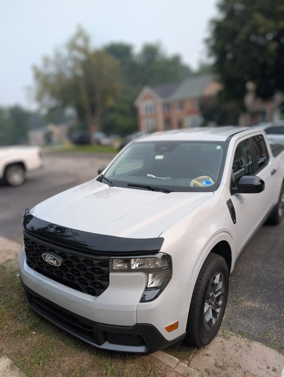

I just installed the Husky Liners Smoke Hood Shield
Part #: HUL-2815980
Only took about 15 minutes. Install was very simple.

I just installed the Husky hood shield, it wasn't difficult except for removing the OEM fasteners that attach the rubber hood gasket under the hood. Easier to pull out with needle nose pliers and then they have an oblong shape you can't see inside the gasket, and you need to "finesse them".
The fasteners that come with the hood guard do not go into the same holes that the OEM gasket fasteners went into, as the guard sits tight up to the hood. A couple of dabs of rubber adhesive might make you feel better, but it actually doesn't look like the truck misses them.
For some reason the new fasteners were just slightly too short to attach the center two attachment spots, despite repeated attempts, so I used a couple of my just slightly longer ones and that did the trick. The part itself fits well, looks good.
The "bumpers" noted above are just small plastic stick on tabs that you typically see on cupboard doors for stops.
They don't look like they would do much except perhaps to possibly protect the hood if a large object whacked the hood guard. I wouldn't count on them doing much to prevent damage.
I put them on the hood shield itself like the OP did, and I cleaned the attach points with alcohol first.
I like the look and it should help keep the hood edge spot from its previous job of bug collection. :wink:

I just installed mine a couple of days ago and the holes lined up perfectly and the fasteners fit and worked as well.
I have a 2025 XLT hybrid. Maybe you received an older production version or a defective run.

The holes on the shield all lined up fine with the hood holes and the install came out great.
The minor problem I had was two of the fasteners for the center would not attach to the hood.
It might have been a fastener problem, but in any case it was easily resolved.
Using slightly longer fasteners secured it.
Not a big deal.
