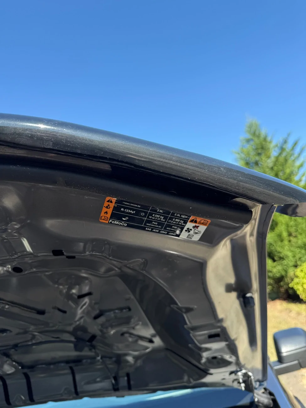

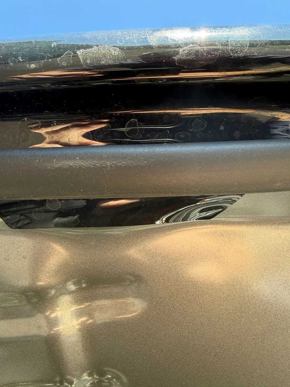

I'm not sure what rubber seals you are referring to but nothing attaches to the outside of the hood (except for the little stick on bumpers.) Everything connects on the inside of the hood onto predrilled holes with the supplied mounting screws. I'm not sure if these photos help but the mounting screws are under the weather stripping.

Did you have to remove the light blue factory clips from the holes that the supplied mounting screws will occupy? In those places, is the hood seal itself no longer attached the way it was using the original light blue clips?

I just installed mine quickly in a parking lot, and from the best I can assume, the hood seal just isn’t held completely in place where the original mounting clips had to be replaced by the supplied mounting screws.

Correct. You remove the blue clips and in those holes go the mounting screws. You no longer use those clips but additional ones hold the hood seal in place

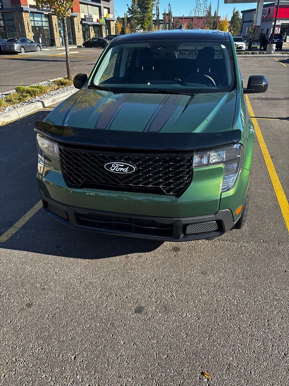

I think I have successfully installed mine!
Ford Maverick Husky Hood Bug Deflector? {filename}
Looks good. :cool:
