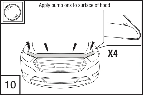

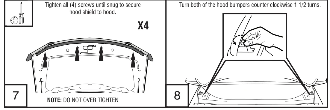

will it scratch the hood paint on the leading edge?
Instructions include clear bumpers to stick on the hood to prevent scratches.

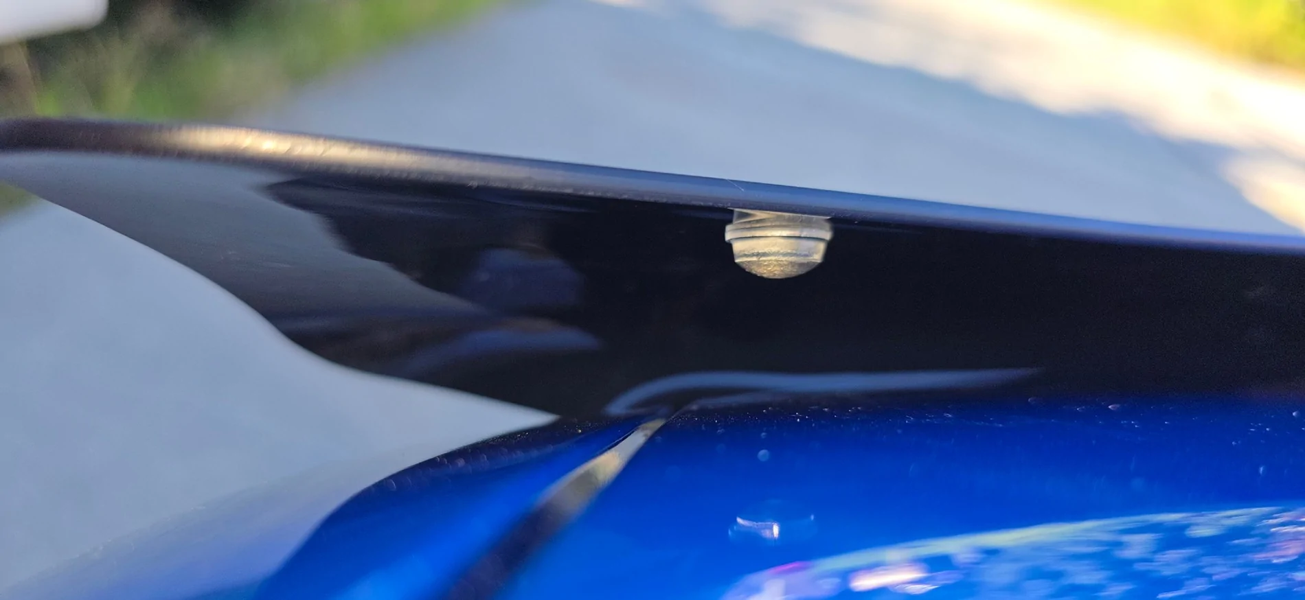

Ford Maverick Husky Liners Hood Bug Shield Installation with the Black Appearance Package 1754597011251-aa
I placed them direct on the shield:
Ford Maverick Husky Liners Hood Bug Shield Installation with the Black Appearance Package hood-shield-i-bumper-install-20250804_173057-1-jpg

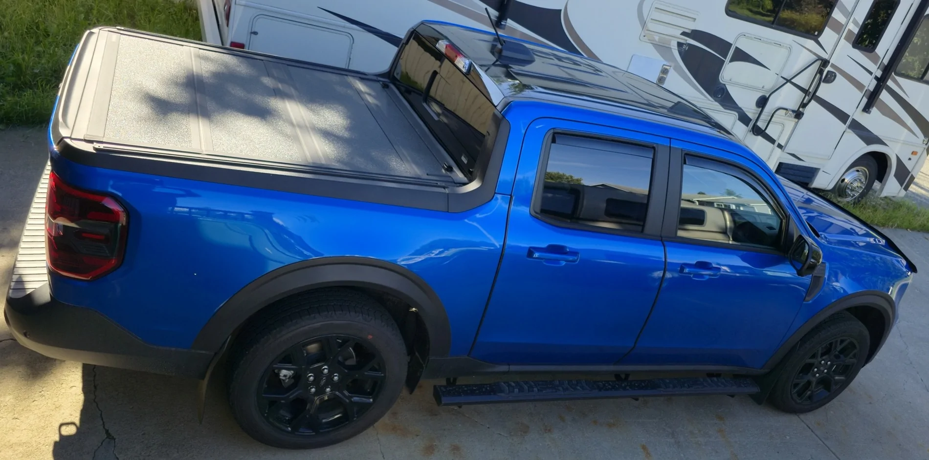

Also, I see you have a base plate for towing behind an RV/Motorhome. Had my Blue Ox installed yesterday with the Demco brake controller and a trickle battery charger. I read that the Maverick is an excellent Toad. Can’t wait to find out for myself!
Yes, It is a Blue Ox base plate for towing.

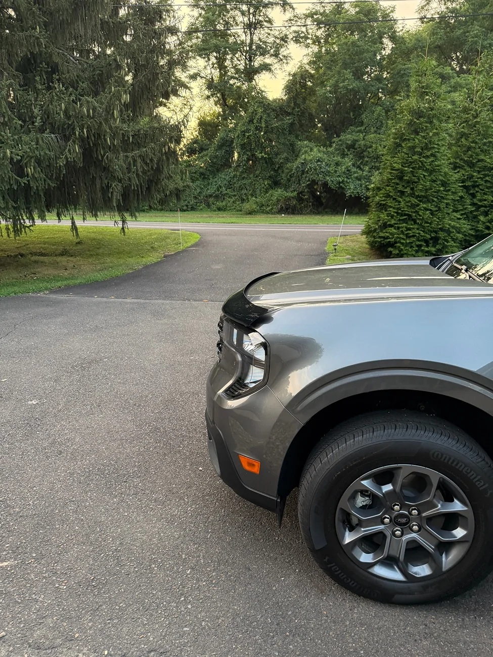

I'd rather have the chips versus this "batwing"
Why is it extending outwards on both sides? shouldn't it be flush? something is not right..
It attaches on the underside of the hood. It does not touch the top of the hood. It is designed as a bug deflector. The 'bat wings' extend the coverage to fenders on both sides of the hood.

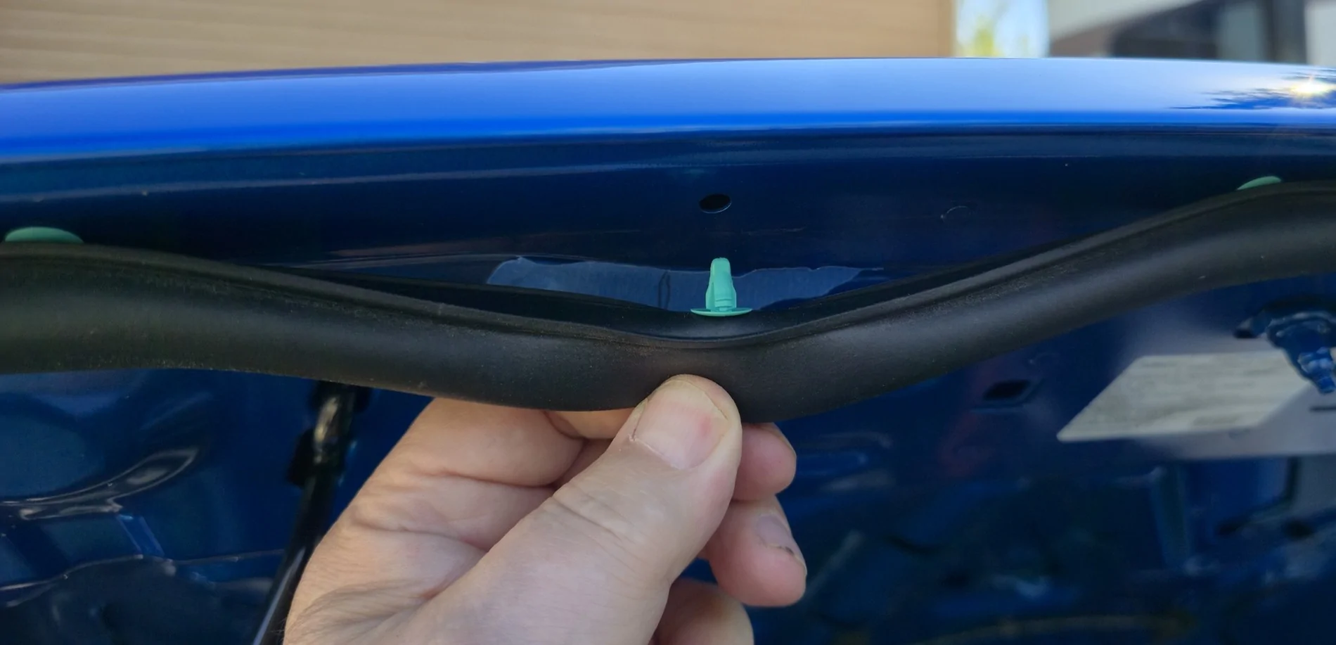

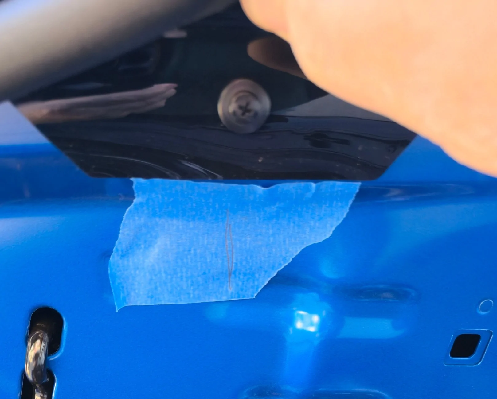

Started with hood open to locate the four buttons under the rubber gasket to remove. I used blue masking tape & a pencil to mark the holes.
Green button removal.

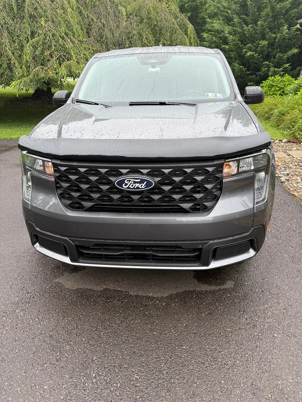

Done: Front and Left view:

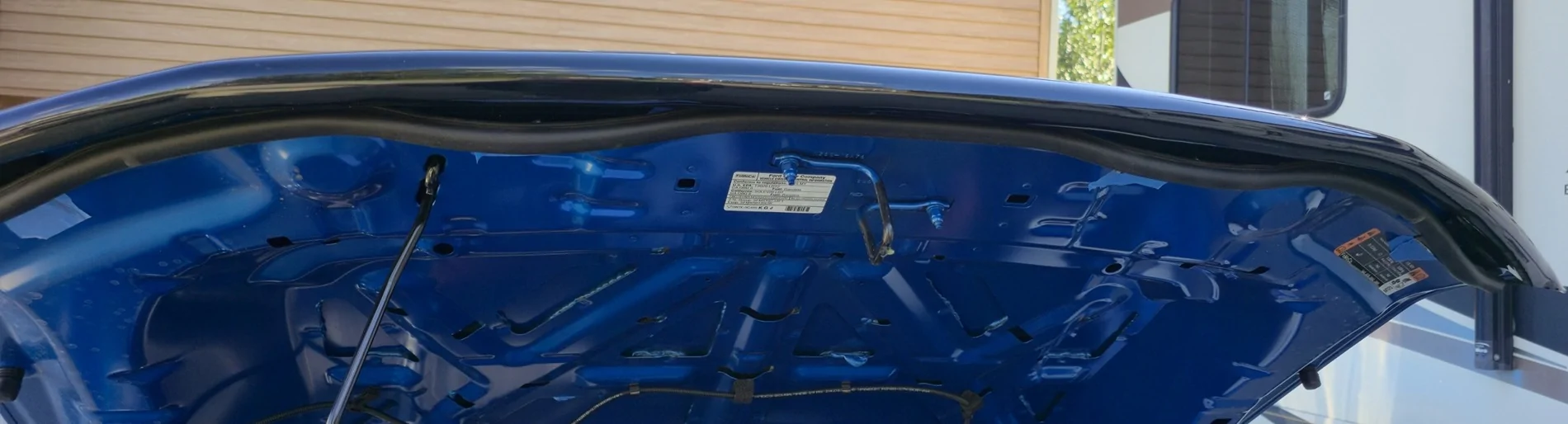

Hidden bumper install:

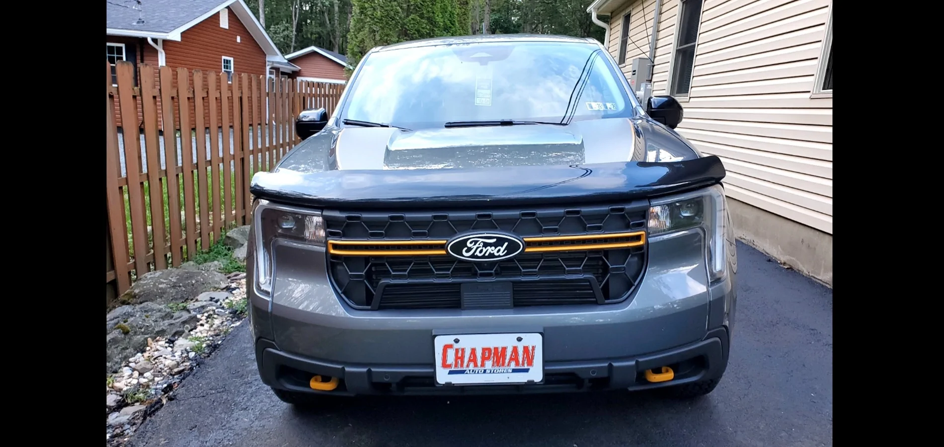

Final side full view:
I think the Husky Liners Hood Shield looks good with the Black Appearance Package.

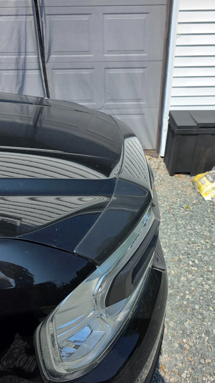

I got the same Husky bug guard for my Maverick and I loved it, I ended up installing the bumpers on the back of the bug guard too as opposed to the hood like the instructions wanted. The Husky was the way to go for me since it goes the complete length of the front end, including above the headlamps and you don't have to glue anything onto the vehicle which gives me the ick.
Ford Maverick Husky Liners Hood Bug Shield Installation with the Black Appearance Package Bug Guard

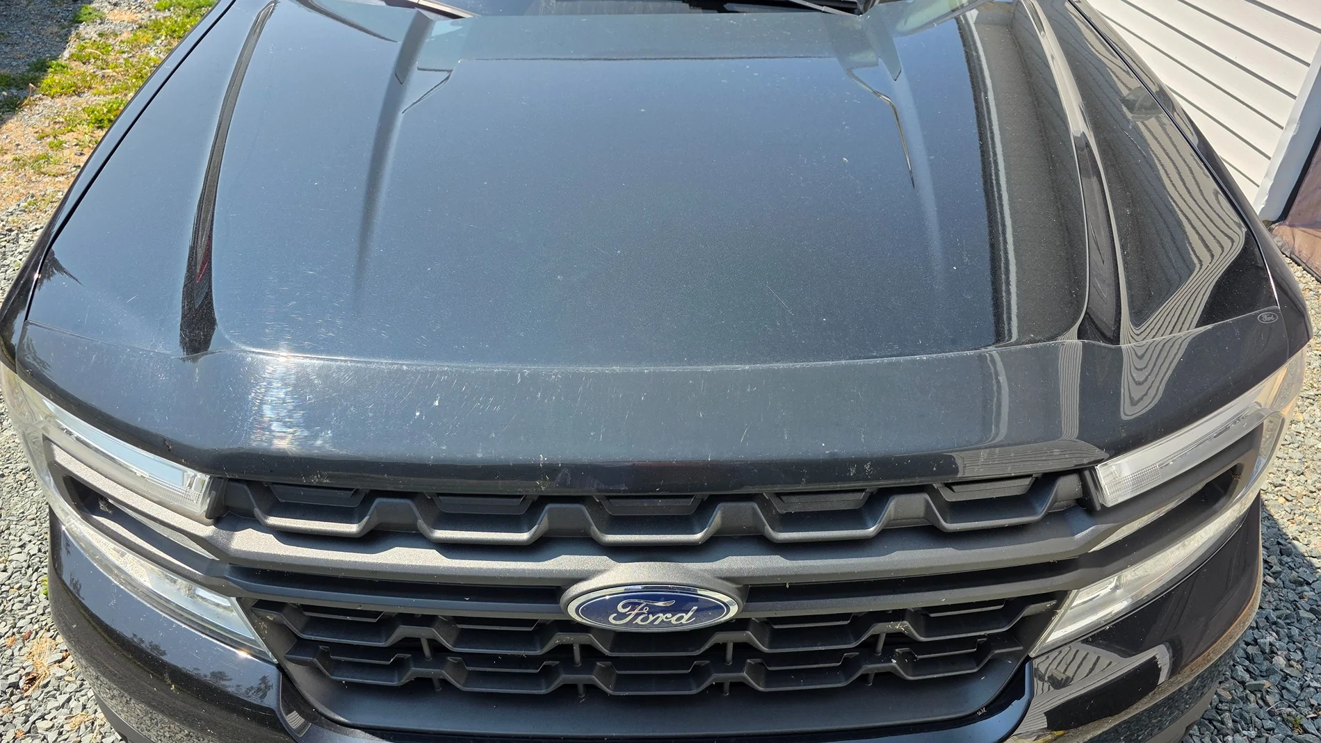

Mine came with what I assume is a factory one. Is the consensus that this will damage the paint as it is touching it? (yes, the truck needs a good wash).
That is not the same thing as it's not deflecting anything for the windshield protection - nor protecting top of fenders up front.
Paint damage if you remove it poorly.
