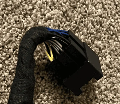

I wonder if you can share the connector part number or some identification for the "ACM male" (the one that you connect to the present connector in the truck to get all the signals and power from it).
Maybe mouser has it.
I have all the parts, apim sync4, apim connector , acm female, but not that one, and I don't want to unpin the present, want to make one plug and play harness.

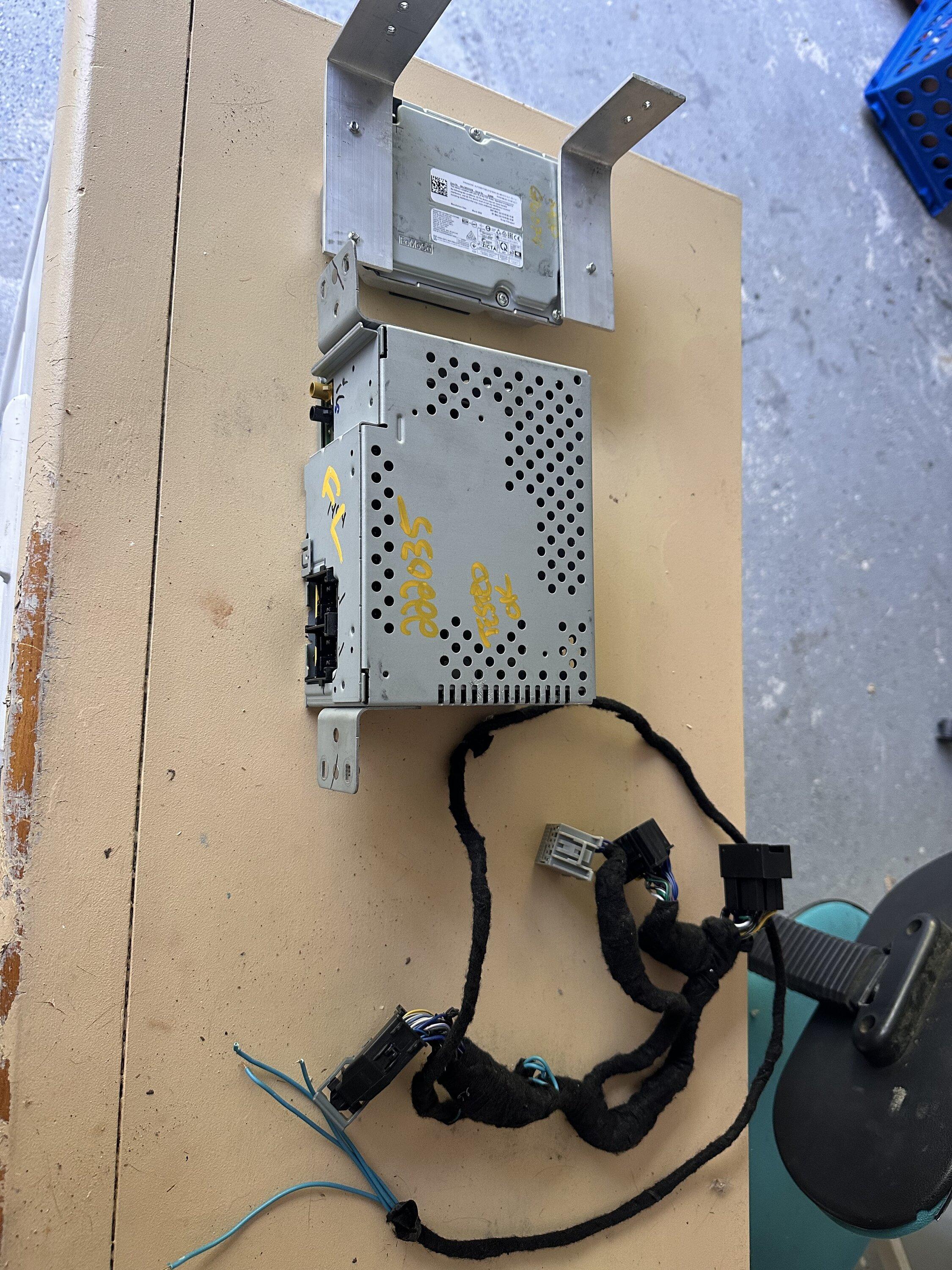

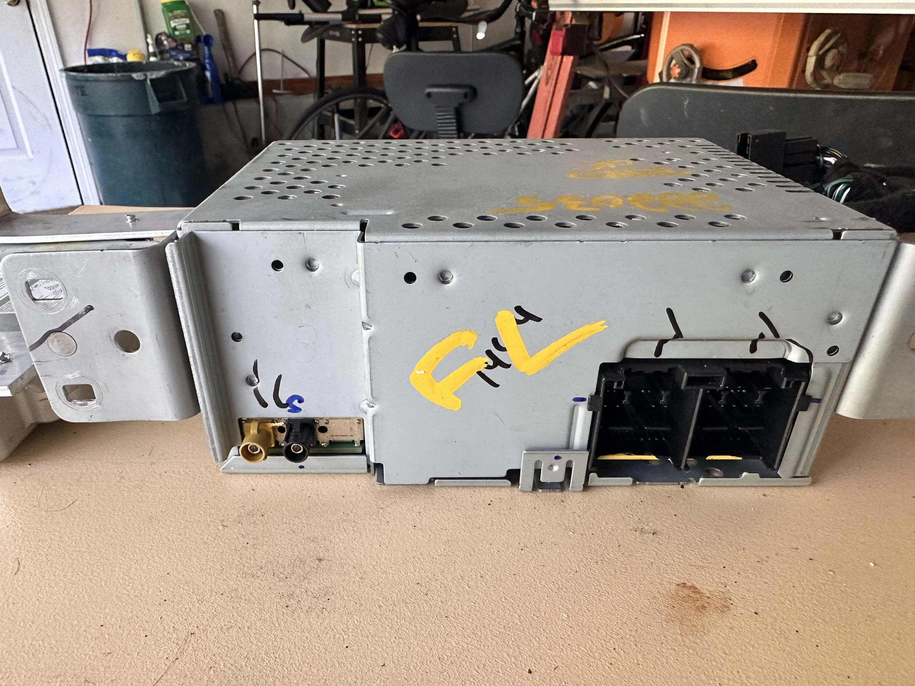

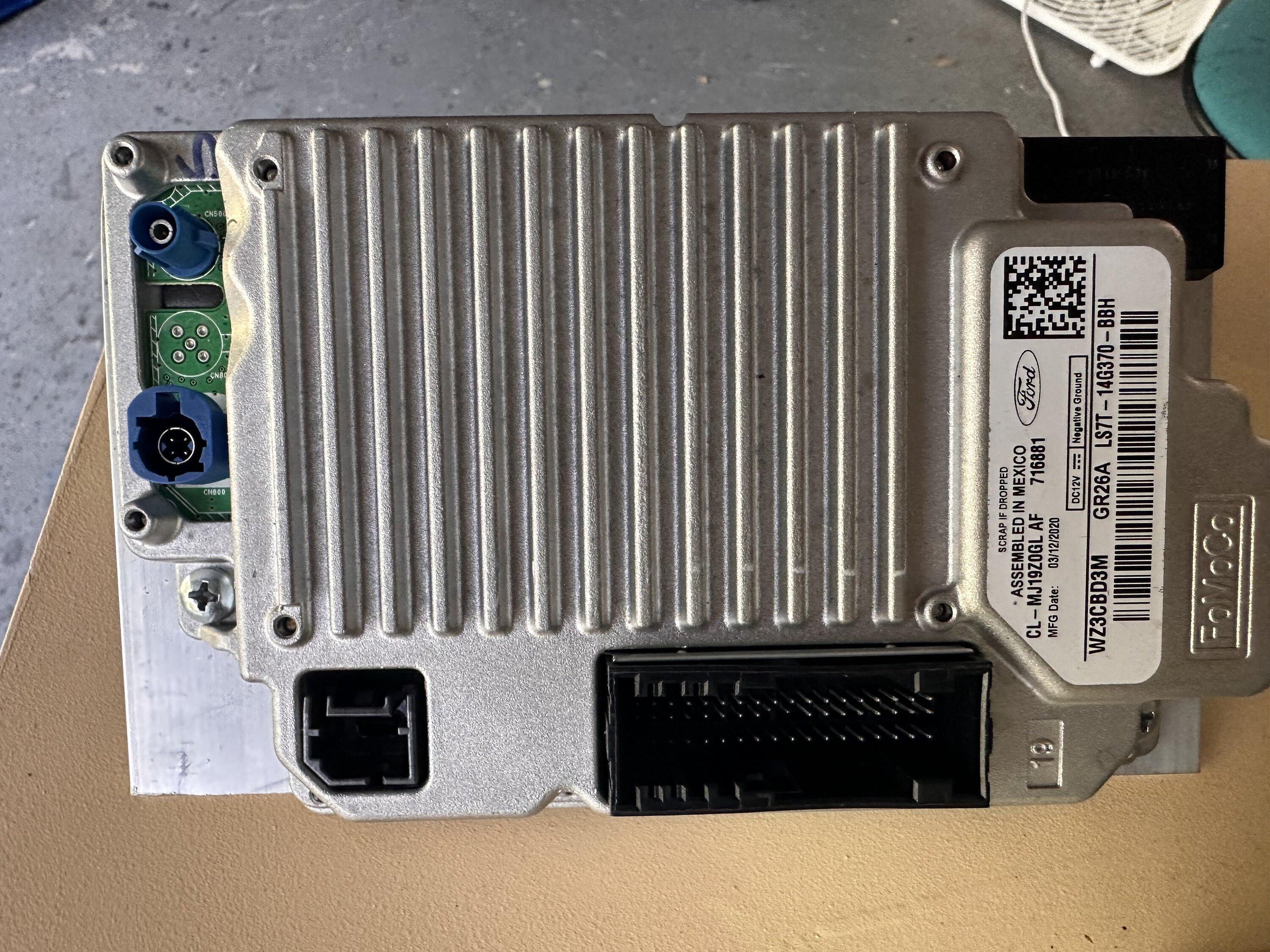

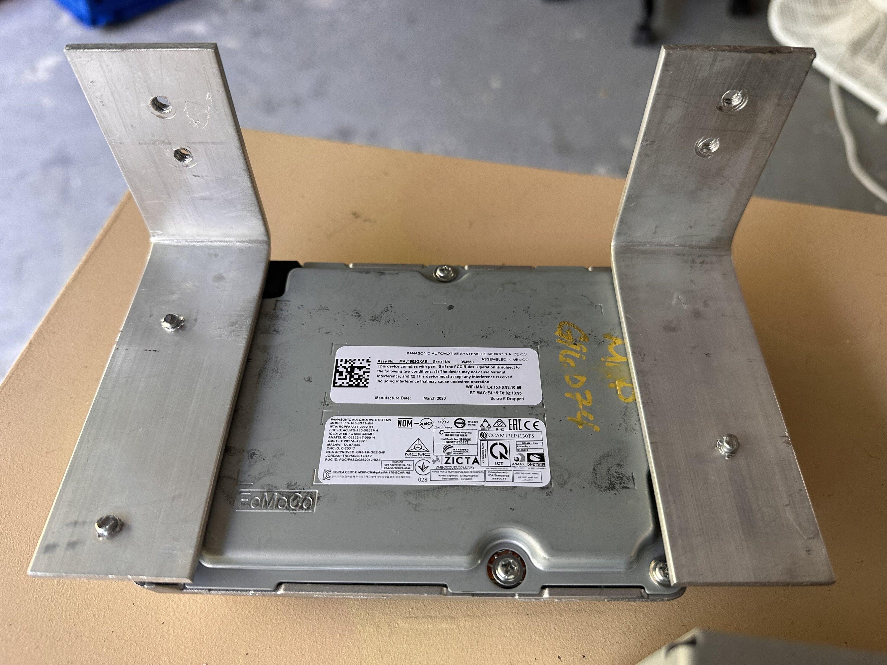

Just uninstalled my sync 3 upgrade from my 22 Maverick XLT and posting parts here for sale. Including harness (built as shown from this thread), non-nav sync 3, and compatible ACM. Model numbers in photos. System worked perfectly with known limitations. You’ll have to do your own forscan programming. Take all for $600

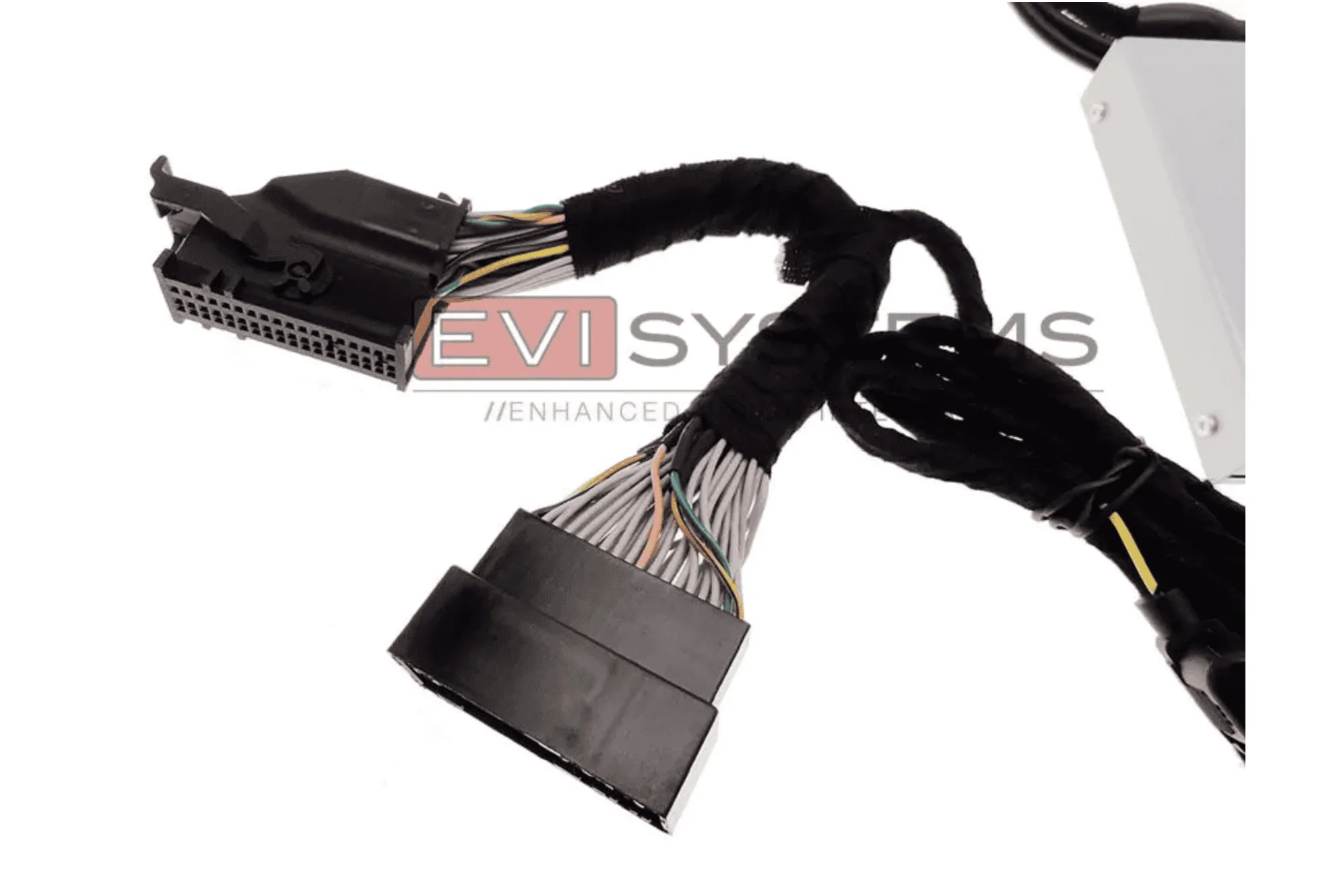

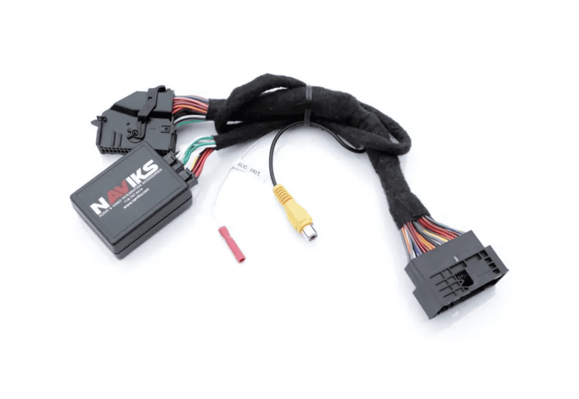

So Im looking to install Sync 3 into a non sync XLT Fx4 Lux. I want to intergrate this front camera interface from camera source.
Sync 3 front camera interface
Do I not need to purchase any connectors if I purchase this? Also, do I need to splice the acm connector into this harness?

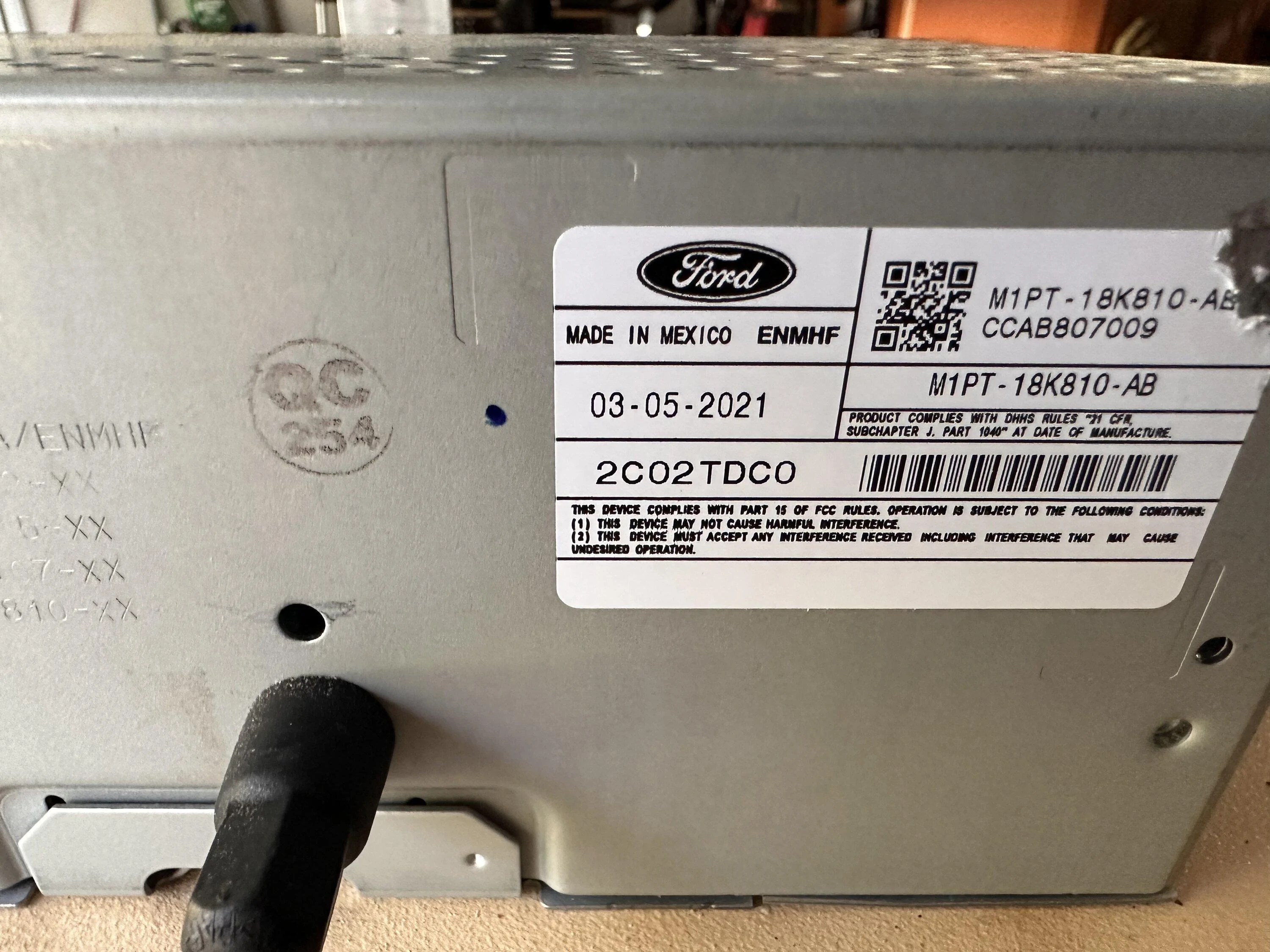

This thread is meant to serve as the how to thread for Sync 4 swaps into XL and XLT Mavericks. I will list the parts required and custom wiring required in order to have a functioning system. Main parts required are going to be the ACM (radio) and APIM (sync module). Keep in mind that this swap will require the construction of a custom harness for the APIM as XL and XLT models do not have the APIM connector present. The harness ties into the main ACM connector for all signal wires required for the APIM and has an additional grey ACM connector for APIM to ACM communication. This harness is by far the hardest part of the swap.
PARTS REQUIRED
1. ACM: M1PT-18K810-AB. These can be found on eBay for around $150 and will provide the ability to integrate Sirius XM if desired. This ACM comes from a Bronco Sport.
2. APIM Sync 4: For Sync 4 swaps you are looking for the below configuration. There are at least three hardware variants of the Sync 4 APIM, Non Nav 8" (one large blue connector), Nav 8" (one large and one small blue connector), and Nav 12"+ (one large and one small blue connector and one small brown connector). For this swap to function, you need a Nav 8" variant of the Sync 4 APIM. These again can be found on ebay for around $300.
