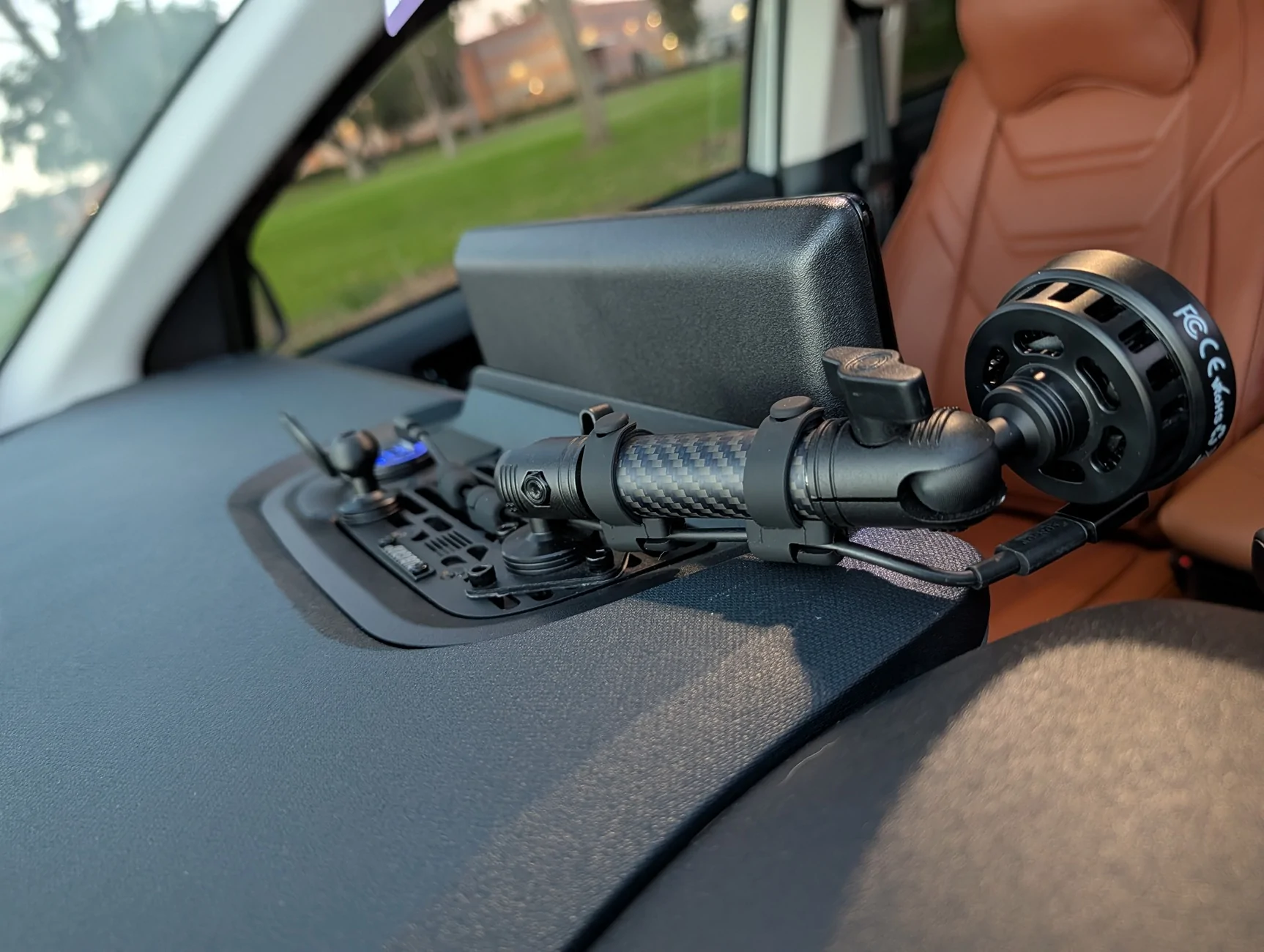

I like my solution as well (from Amazon - either a knock off or the actual MFR that Bulletpoint uses), and I see how this could possibly conceal the upper left sliver of the screen.
https://www.amazon.com/dp/B0D5V4CLC5
BTW: I got that USB-C extension and just need to find the time to get it in. It fits the space between the brackets so it will make that area look clean, then just relo the USB-C charger into the space where the old cubby lived and it's done.

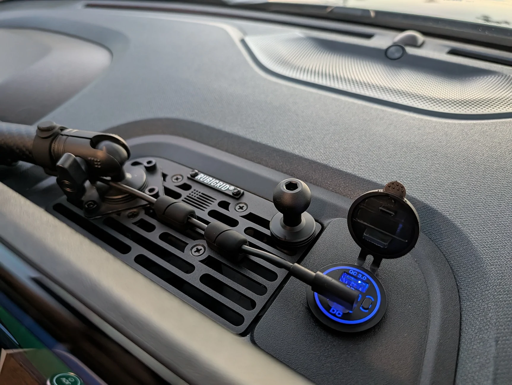

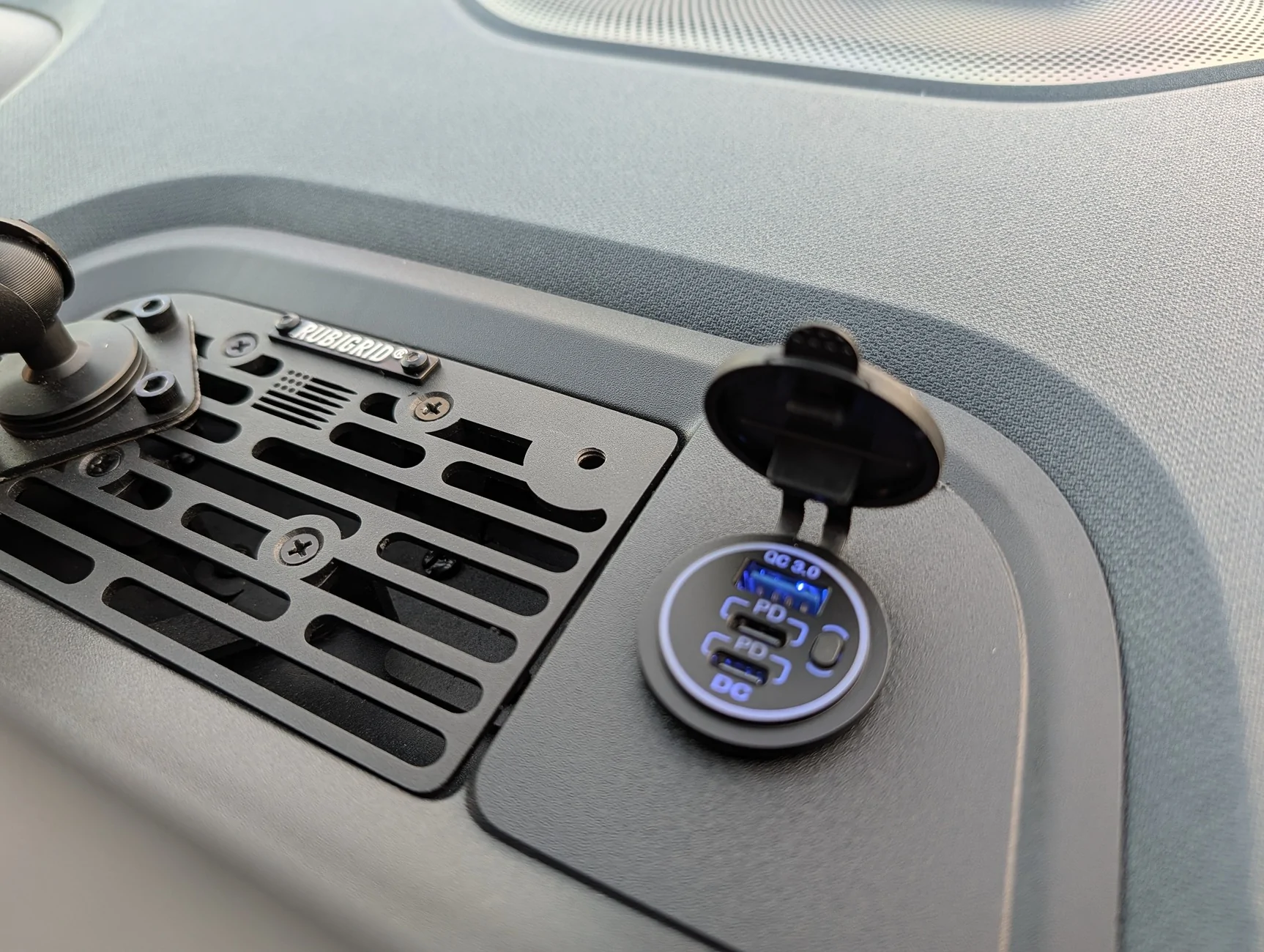

@Mavreezy Here’s how I ended up doing the USB charger up top. My bracing was in the way too - once I took the top off, I had to think of other ways. I trimmed the cosmetic edges of the charger and it still wouldn’t fit, so it became a surface mount inside the tray. Lol
It'll totally fit...
Nope. Even with trimming the mounting brace is in the way. So, I just ran a hole for the wire (straight drop to the fuse box)
If you know it's there and are looking for it, you see it. Otherwise, invisible.
I went ahead and copied your idea of adding a 12v power outlet in the back of the head unit. I wanted to do it underneath the Rubigrid the same way you did it, but I decided it was better for me to have easier access for when I plug and unplug accessories. I tapped fuse number 3.
