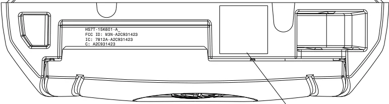

2025 Mavericks look to have the different Key Fobs as noted below.
https://fccid.io/M3N-A3C108397 Frequency Range 433.589-434.251 MHz
https://fccid.io/M3N-A3C108397/External-Photos/External-Photos-5701473

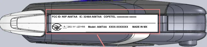

My 2023 XLT 3 button Key Fob is PN FL3T-15K601-AC, FCC ID N5F-A08TAA
https://fccid.io/N5F-A08TAA, Frequency Range 314.95 MHz

2022 to 2024 Maverick Lariat Key Fobs look like Escape Fobs, but each use a different frequency.
Maverick with Remote Start:
Ford Maverick How to Save $$ Money $$  on Keys by Programming Yourself -- From a Locksmith and Owner :) 1755287704748-ri
Maverick without Remote Start
Ford Maverick How to Save $$ Money $$  on Keys by Programming Yourself -- From a Locksmith and Owner :) 1755287806708-ym
edit : Maverick 22-24 Key Fob frequencies updated.
