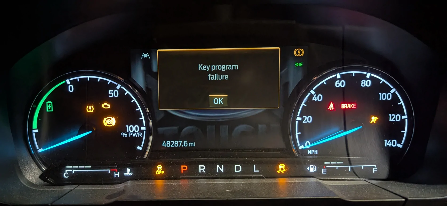

Similar issue here with my 2022 Lariat with Remote Start.
Except I get Key Program Failure on the 3rd key.
@Redneck Garage
Followed OP directions exactly. Also tried 3 seconds instead of 5 as someone else mentioned.
I've tried about 10 times, but have given up for now.
Is there a way to do this with Forscan, without deleting current keys?

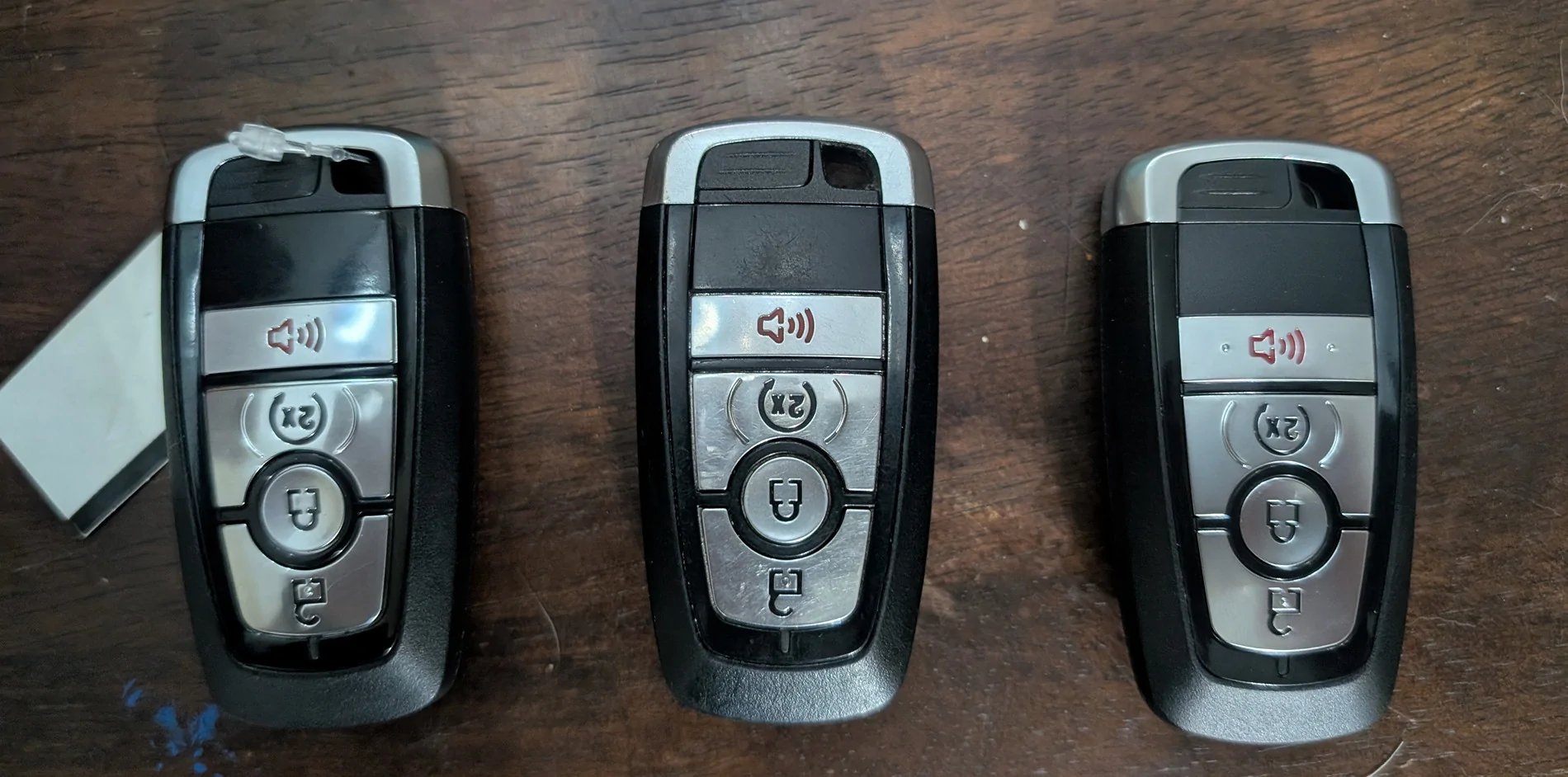

Ford Maverick How to Save $$ Money $$  on Keys by Programming Yourself -- From a Locksmith and Owner :) PXL_20251226_014359137.MP~2
3rd key is identical to existing two keys.

I tried a half dozen times this morning with the same results, "Key Program Failure."
Mine is push-button start, so no key to enter. I use the slot in the console and Push the Start button per the sequence.
Both factory keys work fine, and the 3rd Amazon key, linked in OP, has a red light that comes on when you press a button. So I assume the battery is good.

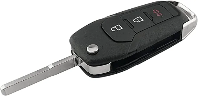

On the XL or XLT trucks you can either add a flip remote or just a standard key ( possibly you might want to add two cheaper keys as a backup ) On the Lariat only the fob will work however the emergency key is not required. I thought I would put links to which keys to purchase and you can take them to a local locksmith just to have cut - as long as you maintain two extra you are in good shape adding in the future.
XL and XLT Keys - I have posted multiple links in case one is out of stock -
Remote headed Keys - $23.99-https://amzn.to/40xtAk7 or $29.95 https://amzn.to/3RpQJAH or $23.99 https://amzn.to/3WVGxAX

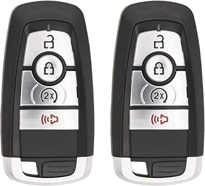

If yours has a remote start it would be this key - 49.99- https://amzn.to/3wNgDVG 89.95 2 Pack - https://amzn.to/3jsaBq7 45.29 - https://amzn.to/3WUcmdl

58.95 - https://amzn.to/3XT89b7 109.95 - 2 Pack - https://amzn.to/40m014U 37.95 - https://amzn.to/3XaDs0h For the Fob to work / be programmed it doesn't matter if the key is cut or not - it only opens the door if the battery is completely dead.
If your Fob does not have remote start for the 2023 Lariat it is this one - 38.99 - https://amzn.to/40ihWsZ
To program - open center console. Pull up felt cover - place first existing fob in depression - push start button ( without foot on brake ) ignition comes on- count to 5 - remove fob - push ignition off - put second existing fob in depression - push ignition on - count to five - remove fob - push ignition off. take new fob - put in depression push AND HOLD start button down - you should hear chirp and message - key programming successful.
