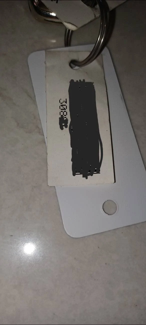

I'm not sure why you're having a problem with cutting the key. I live in a small town and we have one locksmith. He was able to cut the key, no issues. He asked me for the key tag number that comes with the key and used that to program and cut the key. The Maverick key is nothing special and is used on many Ford products.
Picture edit for security.

Did anyone ask you for the key code? Maybe try the dealer.
You should color out the whole barcode, a line down the center of it doesn't prevent it from being scanned as all the bars remain the same.
