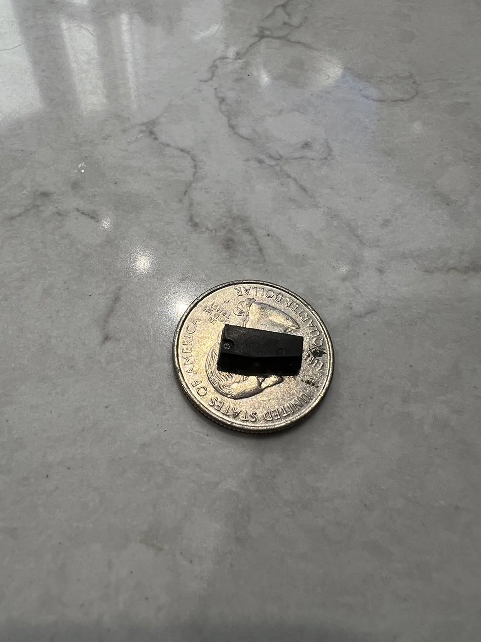

I asked you because the FOB section of the key was large enough to hold the chip to program the truck.
The chip must be really tiny in order to be installed within the rubber section of the key (without the FOB} in order to program truck for that key
This is what a key chip looks like. It’s sitting on a quarter for reference.
Think of your tap-in-pay CC's - that small.
The chip just needs to hold a micro-radio, such that when it receives power via some radio waves it can send out it's info. Very close proximity.
That's why the keyless entry system powers the chip as needed and sends the info farther with stronger signal. Why the truck can see the fob in the truck or outside.
It's also why you don't get the cheapest key you can - it may have quality control problems, and that ability to make a little power from the radio wave and send out it's info is broken.
You'll see some sellers claim to test their keys for that working.
