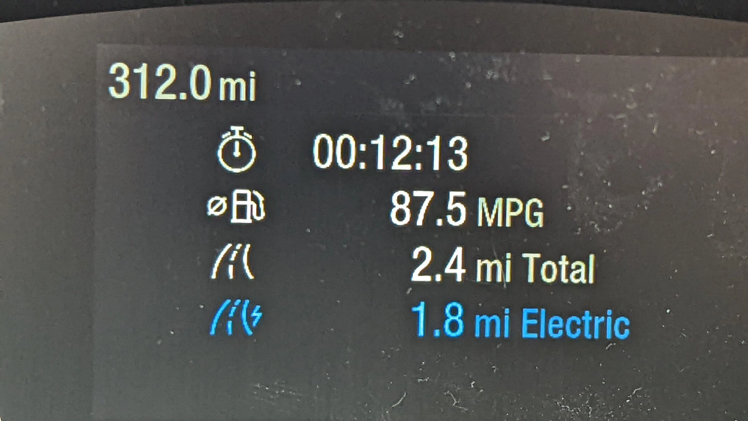

I'd like to add to this. If you keep your power meter under 10% during take off, you can generally avoid running the ICE on takeoff. Of course this depends on incline, The difference between 10 and 15 is negligible as far as acceleration if you're into hypermiling, but avoiding the ICE until it needs to cycle is key. I'm also in Pennsylvania and I agree with the climate control limitation. I see some people just running the compressor constantly on their cars and really don't understand it if it's 62 out work with the air volume and direction first. In this state you can get away with regulating the air only a lot of the time. I'm getting stretches of '50s, even '60s with hypermiling. It drops significantly if you have a heavy foot.

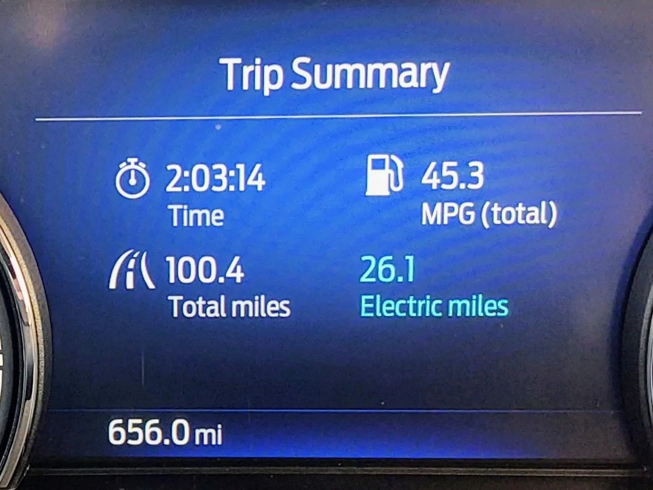

Would like to share my experience on a small road trip I took recently with my hybrid Maverick. I usually leave my Mav in normal and average about 34-37mpg freeway. i decided to try eco mode and was a bit more conservative on speed and lightfoot on acceleration. I admit i was a bit surprised to see the mpg result once I arrived at my destination. 45mpg on 100 mile trip! I would also like to mention I ran into traffic on at least 3 different occasions, which more than likely contributed to higher mpg since the maverick was mostly in electric mode in stop-and-go traffic. the trip took 2 hours due to traffic instead of 1.5hr with no traffic.
