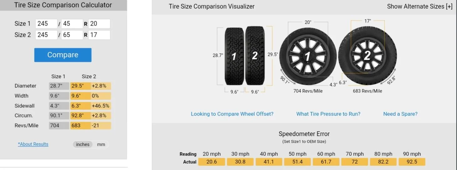

Montana
Jun 13, 2023
4,094
6,347
Use tire size calculator.
Look at the revolutions per mile, factor in the weight of the wheels and tires and rolling resistance... Similar MPG no matter what size wheel/tire you chose if those things are similar. Compare their tire sizes to your 19s or 20s (which still is very vague information) and there ya go...
245/65R17 vs. 245/45/20:
Ford Maverick Hybrid mpg question Screenshot_20230801_052729_Chrom

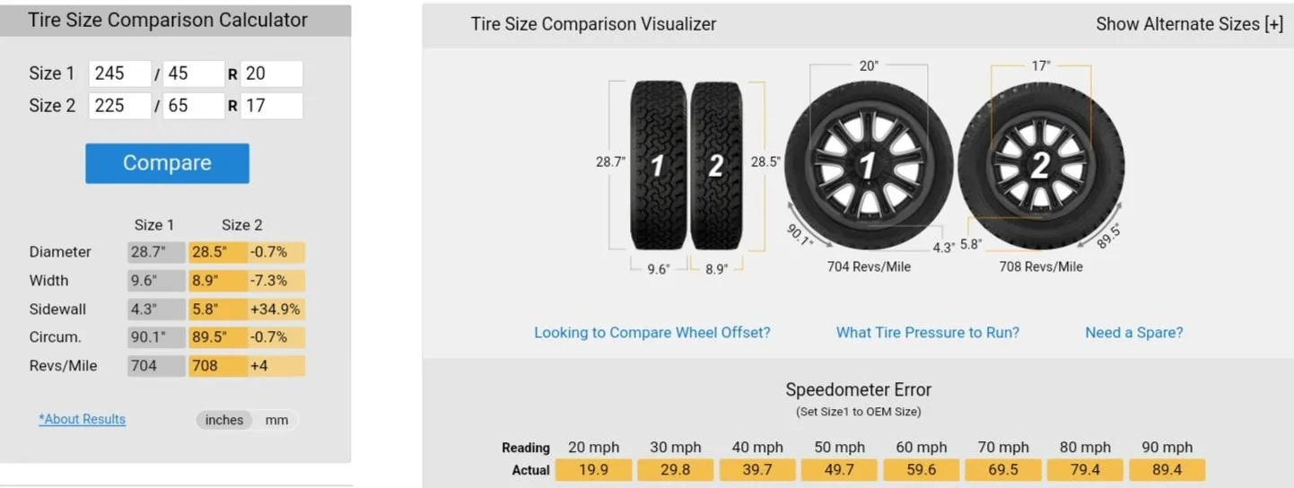

Stock size:
Ford Maverick Hybrid mpg question Screenshot_20230801_053258_Chrom
Compare the size YOU want, because there is more to it than just vague "19/20", to the stock size you are replacing.
