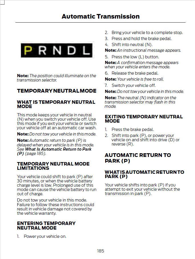

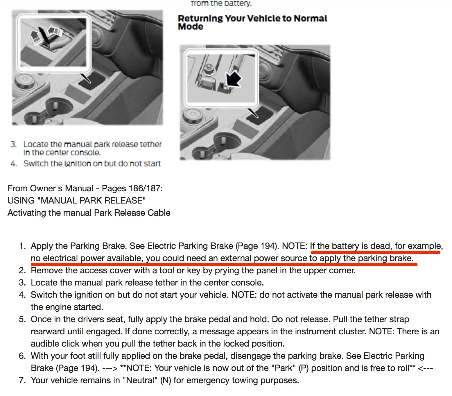

Ended up jumping temporary power to the fuse box as recommended to shift the vehicle to neutral. I Read the owners manual before I sent my request for help from the board after I quickly realized it didn’t apply to the hybrid Maverick .

The truck suffered a total power failure not just a dead battery. I needed to shift to natural to push it out of the driveway to complete moving my son into his house. A tow truck showed up a few hours later to take it back to the dealer for repair.

The battery jump only let us shift to neutral, still had no power for motion.

It is a PowerSplit, so there is no true neutral. The powertrain has to be powered up. This is also Ford's 4th generation of this hybrid powertrain.
