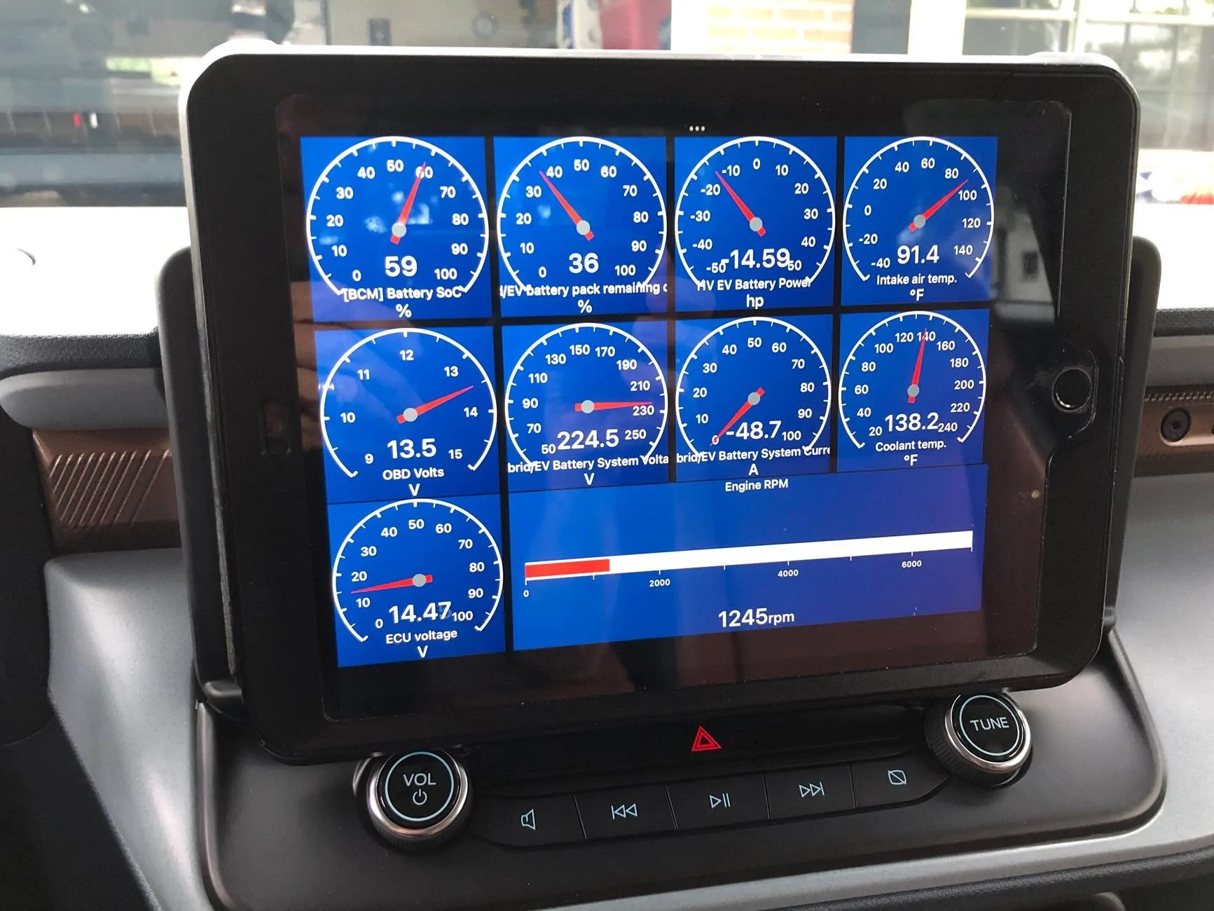

CarScanner app through OBDII has all sorts of “voltage” options available. This is from my 24 Lariat Hybrid.

Hey @BlueMav43 I was going to ask how you had cast your car scanner screen to the built in Mav screen, then saw you have a tablet sitting over the factory unit. Does anybody know how to get the gauges/infor from the phone directly to the built in screen?
Edit - I just did a web search and it sounds like there is no easy way to do this without a piece of third party hardware.

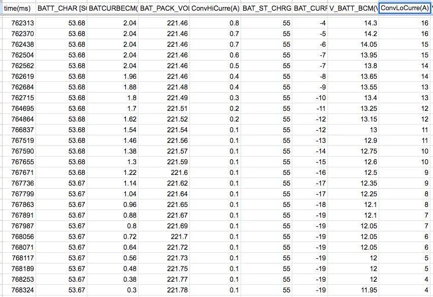

A click to Acc stays at 12 V and battery supplying the 12 V system.
A click to On goes to the higher HVB engaged & charging mode 14-15 V and battery receiving Amps.
A click to Start changes nothing from On.
Going backwards from Ready/On to Acc also drops back to 12 V and battery supplying the 12 V system.
Here's the log from parking and going to Acc mode.
Can't get readings from OBD2 when Key off. Upon door open OBD2 dongle light turns off and powerport display on my live Volts turns off. Immediately now, of course was longer.
In this 5 second chart snippet, 1st set of 3 is HVB, 2nd set of 3 is 12V battery, DC-DC Conv Hi & Lo current:
Read time from the modules has some delay that is different between modules, but you can see the changes.
HVB current was in supply direction as was DCDCHi, dropping to 0.
12VB current is already is supply direction (negative) and going up, while DCDCLo was still in supply direction dropping to 0.
12VB volts changed from the charging state 15V to the resting 12V.

Concur, I’ve looked a lot too. Just not worth it to me.
