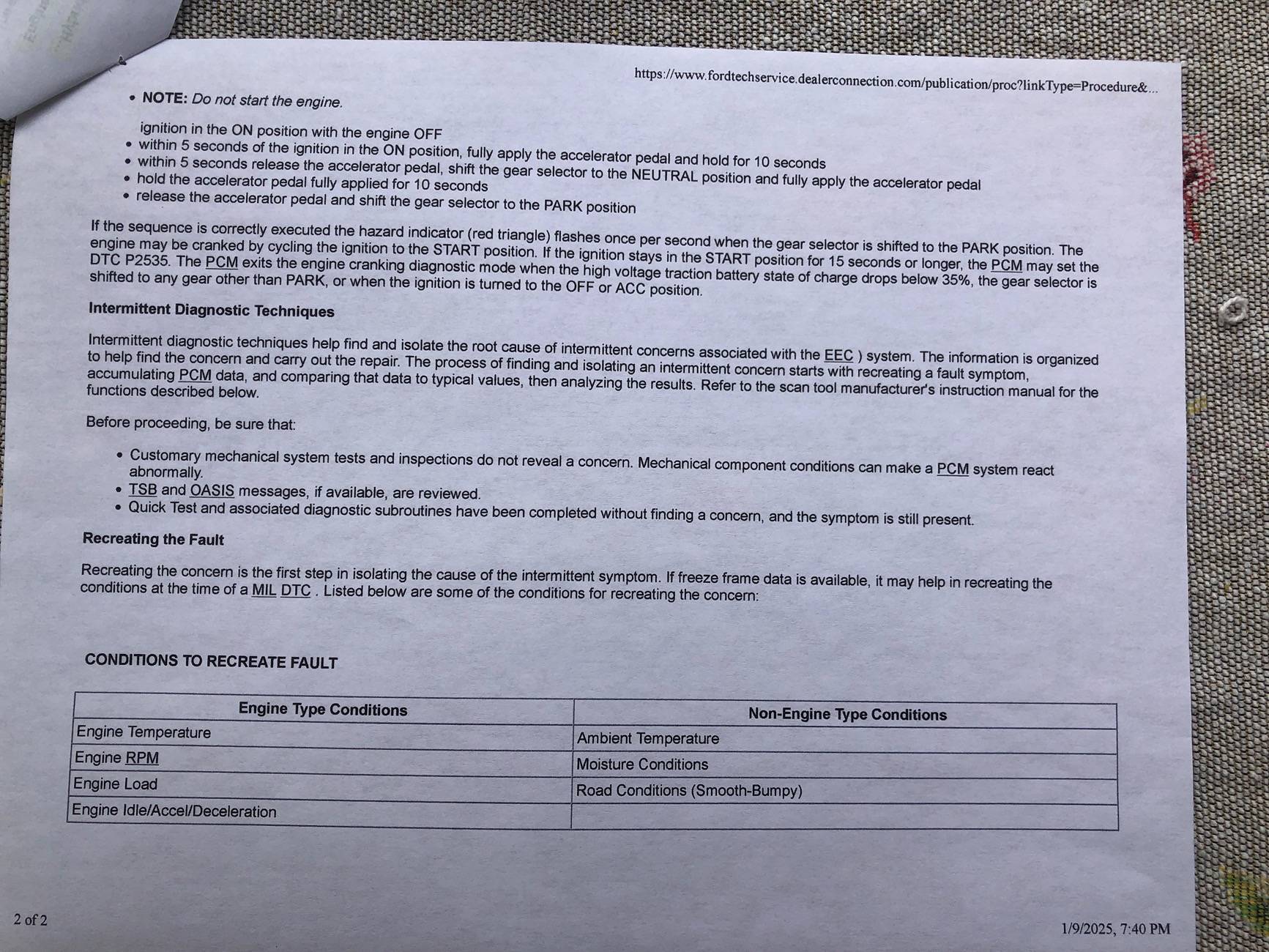

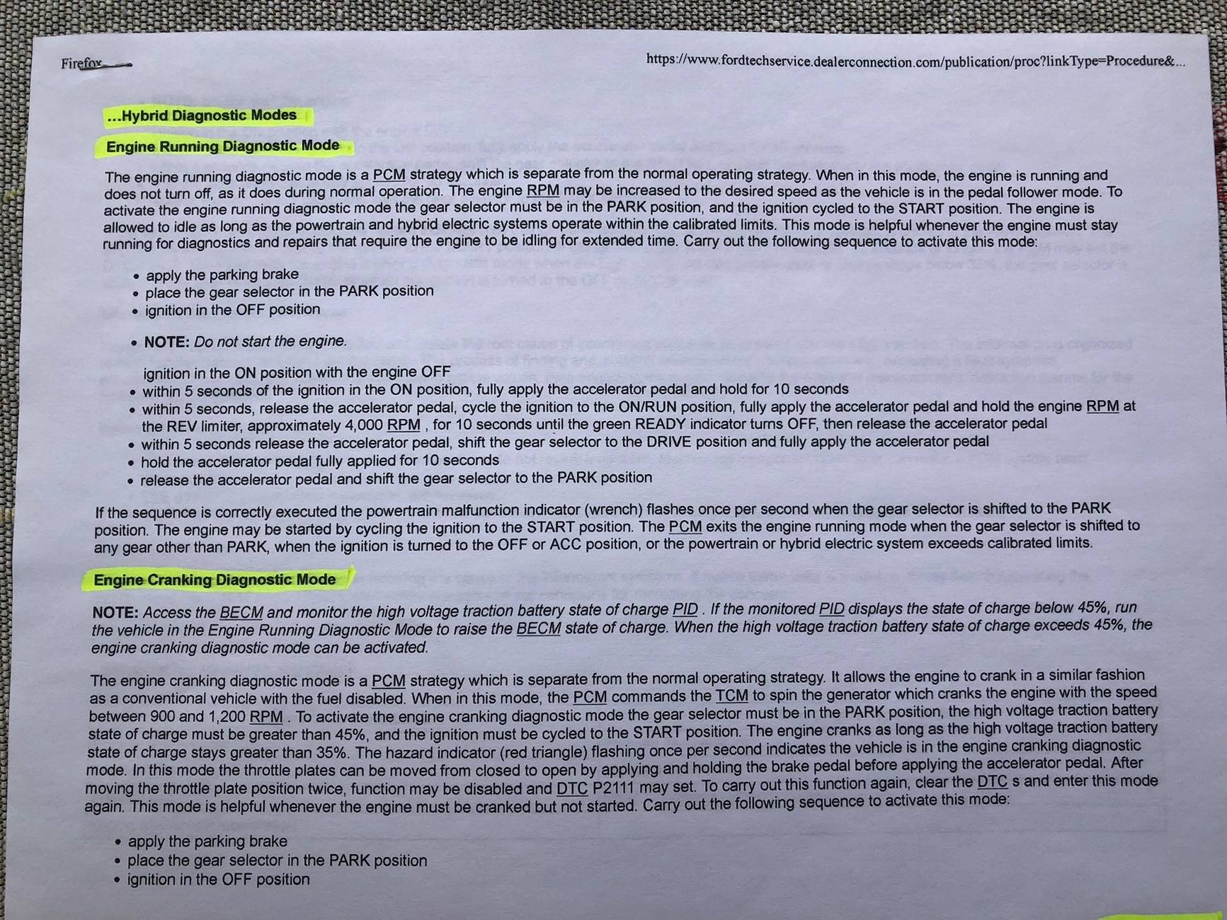

Isn't it interesting that the documentation on modern vehicles is so egregious that we actually have conversations like this, and simple facts on the underlying design never come to light? Ex: I'm pretty sure there must be some way to manually start and idle the hybrid's engine for testing, but this is somehow a closely guarded secret.
I have information on that procedure!! Bill P

Yeah, I finally figured it out. The service writer at my dealer said there was no way to do it, too. Mashing the accelerator while in Park will be good enough for a leak check after an oil change, but I would still like to know if you can actually put it in a diagnostic mode where it will actually idle with no load and the throttle responds to the accelerator pedal.

Here’s the answer on starting Hybrid-
I have not done this procedure, so you’re on your own !! Bill P

Thank you, Bill. There are some ambiguities there, like leaving the engine off but holding it at the rev limiter (4K RPM, no tachometer) for 10 seconds. Time will tell if I can make it work. Thanks very much for the info.

Wow thanks.
That's convoluted enough to not accidentally happen.
The page break appears to have missed a line.
I'm betting a tech would rather just hook up a computer and tell it to do the modes, compared to those steps.
I think for oil change leak confirming, the normal engine idle by Go pedal press runs long enough.
But I guess this will be needed when time for coolant.
You for sure need to create a new titled thread for this nice info.
Let's see, something findable from a search - "This is great info"
