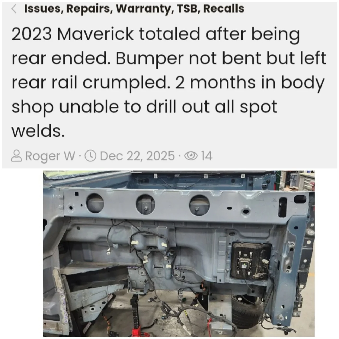

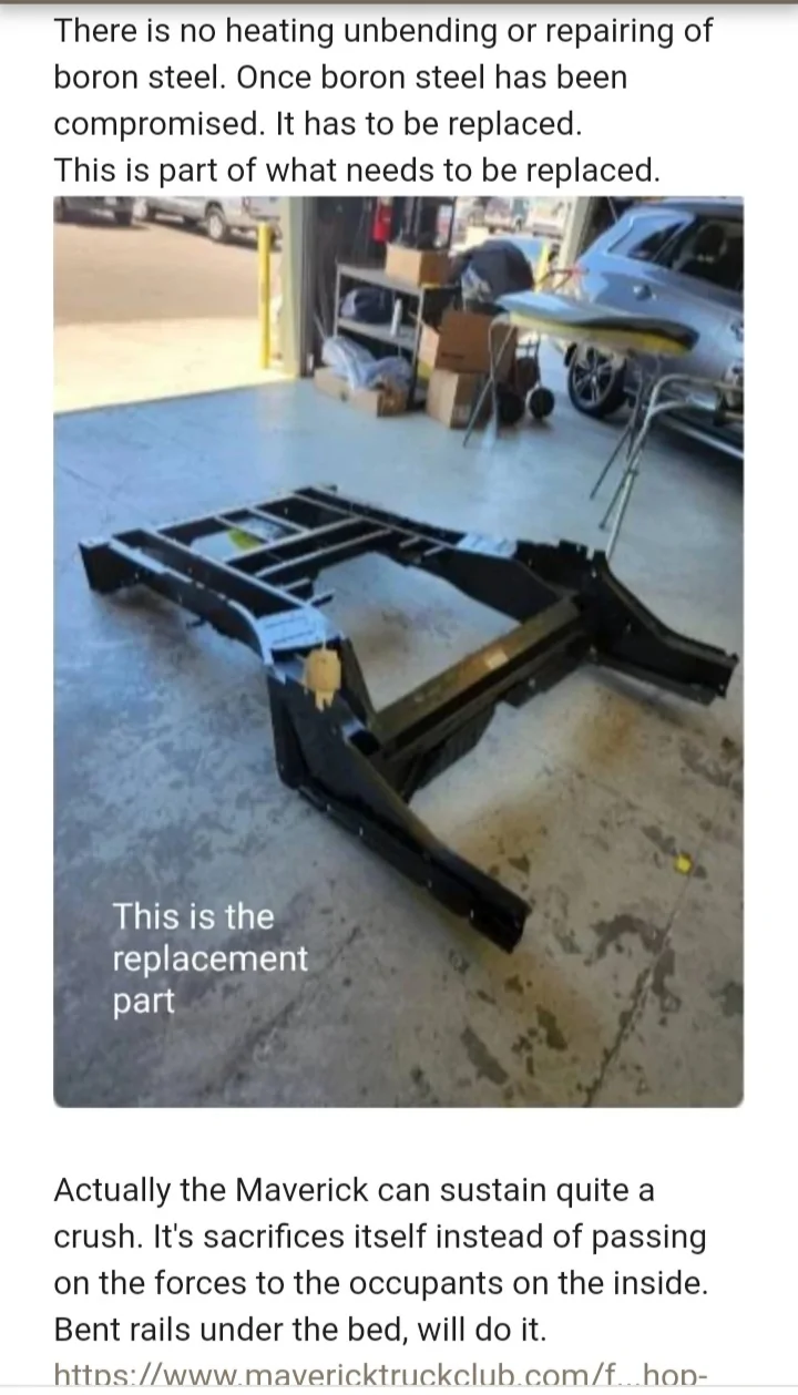

A few months back there was a first poster on here saying that he had bought a Maverick with a Totaled Title and a bent rear frame for $12,000 at auction and asking how much would it cost to repair. Someone pointed out that the Maverick rear frame is made from Boron steel and would cost $25,000+ to repair.
Take the insurance money and cash it asap.
Vik, hasn't been back since.
Here's the thread, Joe is referring to.
https://www.mavericktruckclub.com/forum/threads/rear-ended-damage-to-frame-rails-or-not.79920/
Ford Maverick How Much Does a Light Rear End Damage Cost to Repair? 20260507_081926
Sounds like there's going to be a lot of salvage title or title-washed Mavericks that were put on a frame puller and sent on their way.
That’s not how the boron steel sub frame works….
It will just crack. Very brittle.
