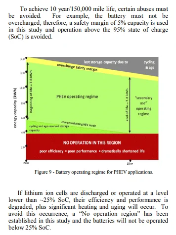

there is a lot of money and effort going into figuring out how to salvage and remanufacture EV batteries. by the time we need one, should be affordable options.
Also, EV battery design today typically allows for degradation over 8-10 years. Say a battery will lose 30% over 10 years, that 30% is added capacity in the design with software controlling the effective capacity. So a battery will not be overcharged at full (vs. the only charge to 90% and unplug of early EVs). But will continue to eat into the excess as needed as the battery ages to maintain performance. Once the battery eats up the excess capacity (lets say 10 yrs) then you will see actual performance degradation. But the battery is ALWAYS degrading over time. Those living in hot climates will see faster battery degradation. single best thing a person can do to increase battery life is to avoid long periods of parking in direct sun on hot days. (see graph from study on design of PHEV. Note dark green (hard to see) is reserve and is used to offset degradation. Link to Ohio State U research paper that this graph comes from. https://cecas.clemson.edu/~sonori/Publications/536.pdf

Also, EV battery design today typically allows for degradation... a battery will not be overcharged at full ...
Still stuck in the BEV/PHEV paradigm.... batteries in HEVs are life-of-vehicle parts because the are never fully charged.
yep, you are correct, I was referring to the research I did for my Wrangler PHEV. BUt point still valid, even at 90% maximum charge with environmental considerations, batteries, all batteries, degrade at some rate with the most impactful condition being heat at charge/discharge. Any designer of modern HEV; BEV; PHEV will account for some battery degradation over 10years of normal use and use BMS (battery management system) to control state of charge that is dynamic. Its the only way to build and protect consumer confidence and make the federally mandated warranty coverage work.

In a parallel hybrid losing 30% of the battery capacity isn't nearly as bad as it is in a full electric. Namely because in normal use the battery cycles between 40% charged and 70% charged. As the battery ages typically you start seeing a bit more of the 70-100% range used. You probably won't even notice it in fuel mileage calculations. I know my 2010 fusion only had 80% of it's new capacity left, and hand calculated has mileage has me up .1 mpg since I bought it. Not to mention the 1.1 kWH battery can only give you at most 3 miles of all electric range (without them factored in) a 30% reduction drops that to 2. Compare that to a plugin hybrid with 20 miles of all electric range new that drops to 14, or am all electric car with 200 miles new that drops to 140. Sure the percentage lost is the same, but the impact in actual miles that can be driven are vastly different.
