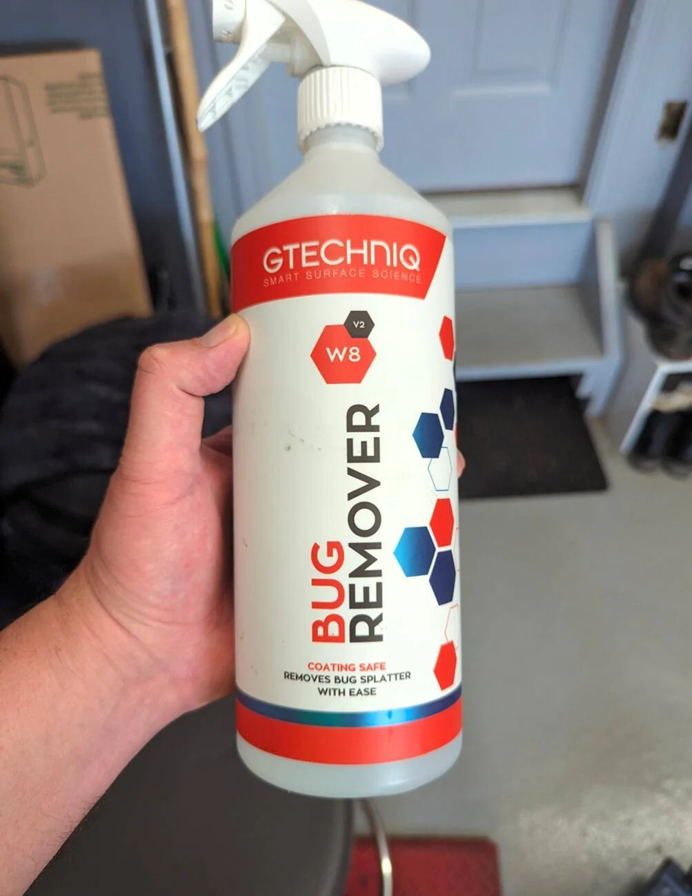

I hand wash with the 2 bucket method. I've found the best way to handle bugs is a good defensive strategy. I wax my vehicles a few times a year. But I hit the front end surfaces with spray wax after every single wash. Get something compatible with whatever wax or coating you use. Meaning often the manufacturer of the wax/ceramic/sealant you use likely also makes a spray quick wax version. Takes all of 5 minutes.
Otherwise it's best to get the carnage off the paint sooner than later. Like birdpoop, some of the bug guts will etch into your clearcoat. Detail sprays can help with this, just be cautious if your car is dirty, as you don't want to grind dirt I it the paint. I'll hit it with the spray and very lightly pat/wipe the area to clear off surface dirt, then flip the towel and spray and wipe the bug off.
To remove stubborn bugs that make it through a wash, or also ahead of time, they make a variety of bug and tar removers. They work pretty well but the problem is that almost all of them will remove your wax or coating where you use it. So keep that in mind.
There are a couple products that do a decent job but don't remove the coating. I use Gtechniq Bug Remover. Can do larger areas by spraying on the area or smaller ones by spraying on a towel and blotting onto the bug first. Either way, you want the product to sit and keep wet on the bug for 30 seconds or so before you wipe.
Otherwise, it can also be used as a pre-treatment before you wash that area. Spray it on liberally and let it soak for a minute then wash. It helps, especially if you've kept the area waxed, but a lot of times it can still require some elbow grease.
