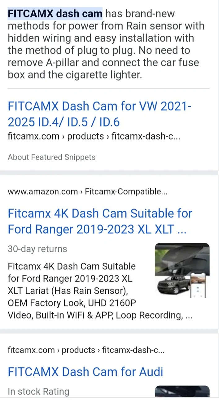

None have rain sensor!
Fitcamx 4K Dash Cam Suitable for Ford Maverick 2022 2023 2024 2025 (HAS Rain Sensor), Integrated OEM Look, 2160P UHD Video, Built-in WiFi & APP, Loop Recording, G-Sensor, Easy to Install, 64GB Card

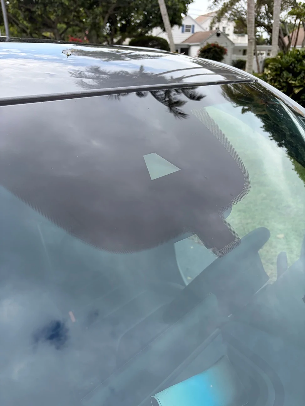

Looking at the other instructions for the ranger it seems that they made a mistake😱 and assumed the Maverick had a rain sensor.

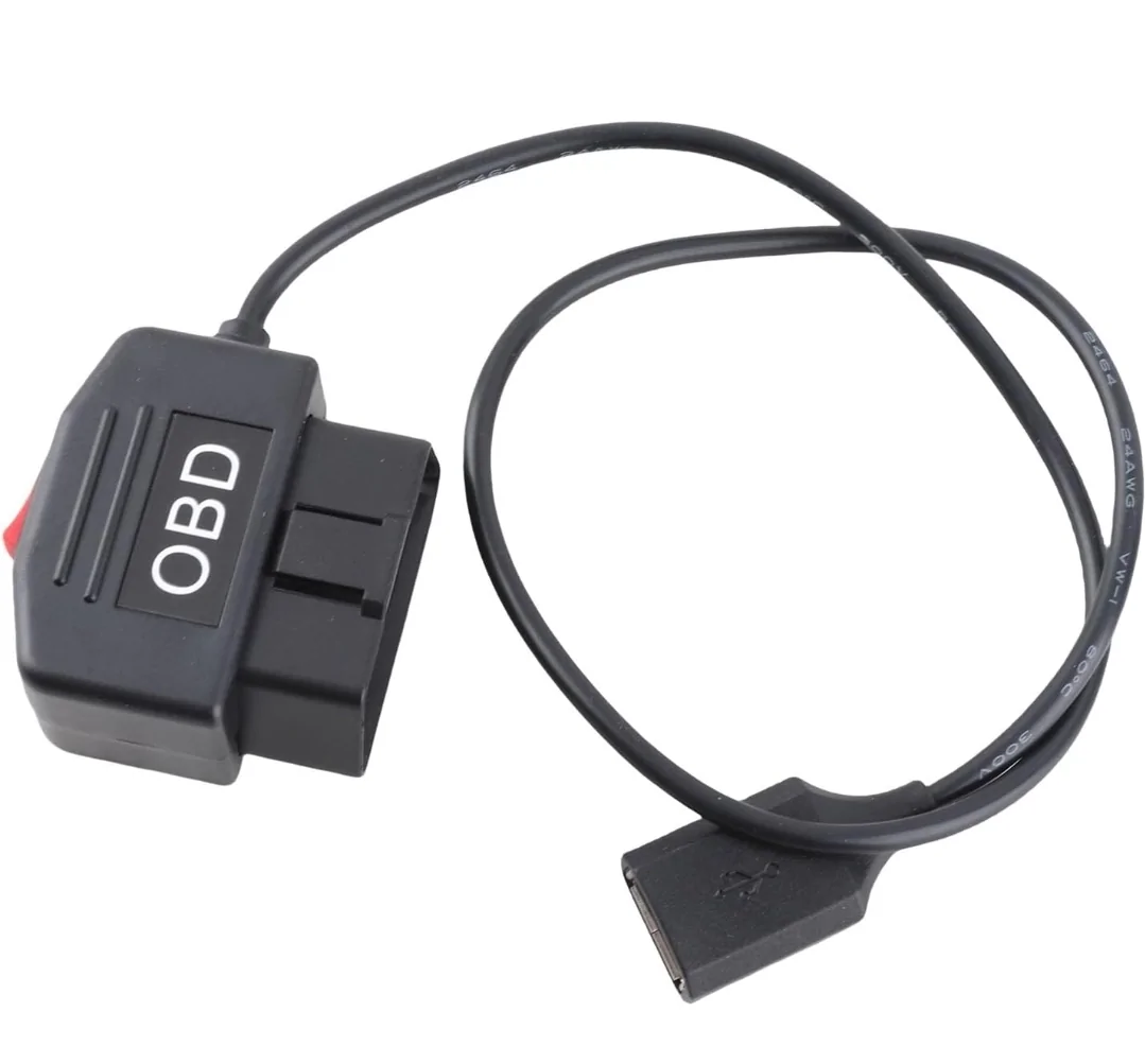

It plugs right into the camera and is plug and play?
It plugs into the OBD port (at your left knee under the dash of the Maverick) and the dash cam plugs into the USB plug on the adapter.

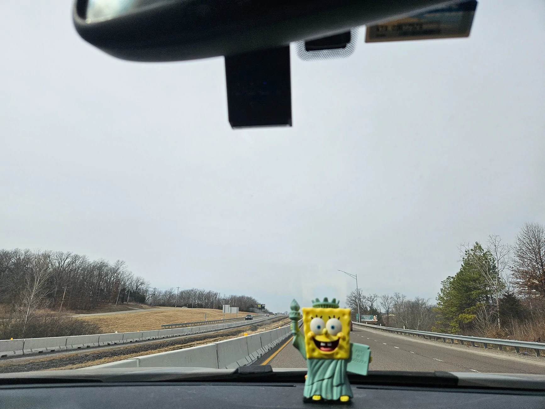

My dash cam was placed just behind the rear view mirror, in fact I am currently in my truck on I70 driving to Kansas as we "speak".

So it’s simple then. The other end plugs right into the camera. Need to get that.

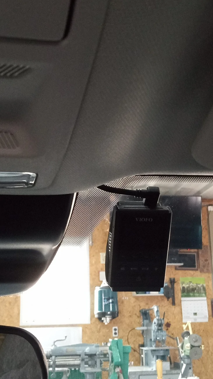

I just installed a Viofo A119M Pro bundle and it was very easy to install. I hardwired mine to the fuse panel and after watching several videos and reading info found on this forum. I am very happy with the video quality and the looks of it mounted. I did not elect to use the static film. I also used fuse 1&2 for the ACC and fuse 24 for the battery using the HK6 wire kit. (note) the kit does NOT include a micro 3 fuse tap, which is needed for the 1&2 fuse. The only panel I had to pull out was the passenger A pillar, BUT just at the top....just enough so you can slip the wire in behind the airbag. Of course you need to remove the fuse panel, which is nothing. The hardest part for me was hooking in the fuse taps as 70 yr old necks don't bend like they use to.
Link to the bundle:
Amazon.com: 【Bundle: VIOFO A119M Pro+256GB SD Card+HK6 Hardwire Kit】 VIOFO A119M Pro 4K HDR MINI Dash Cam, STARVIS 2 IMX678 Sensor, Front Dash Camera for Cars : Electronics

Thanks for posting this.
