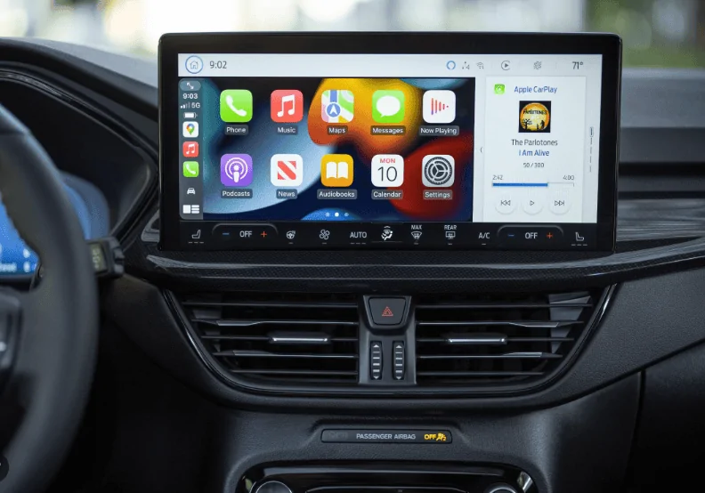

There is a reason the Maverick has a slot that large. In my opinion, they always wanted to put the larger screen there but didn't have it ready in time. I'm thinking it might not take much effort for them to add it as an option for the 2024 model.
Honestly, the only thing likely to keep it from working is the fact Ford adds Sync 4 on the Escape when you select the 13" screen. Given the Maverick currently tops out at Sync 3, that may be the lone limitation.

It's out there on the 2023 Escape. 13.2" diagonal will fit using up the cubby, probably.
But only 8" of it is used for nav. The "cubby" area is more for "info".
Car and Driver article.
CarPlay and Android Auto can be expanded to take up the full width of the screen (hiding that info pane on the right), not sure if native Sync 4 navigation can as well.
2020+ Escape 8" has:
Push-button start to the left of the left vent, behind the steering wheel
Same row of buttons below the touchscreen as in Maverick, including power/volume, play/pause, seek, screen off
Same climate module down below the HVAC vents
Drive mode, auto start/stop near gear shift module (dial)
2023+ Escape 13.2" has:
Push-button start, auto start/stop, max defrost, drive mode, power/volume relocated where the climate module was
Climate relocated to the bottom bar on the Sync 4 touchscreen. No physical climate controls other than max defrost
No dedicated controls for track/radio station, no button to turn off the touchscreen
The spot that housed the auto start/stop, drive mode, etc. buttons is now a little sauce packet/change bin
Probably the bare minimum would be to fabricate some sort of bracket to hold the larger screen in place and stick the physical infotainment controls somewhere else - surely you'd want to keep the volume knob and power button. Once you start trying to change all the other control panels to match, it gets more involved.
And that's before even looking at ensuring the modules would be supported.
