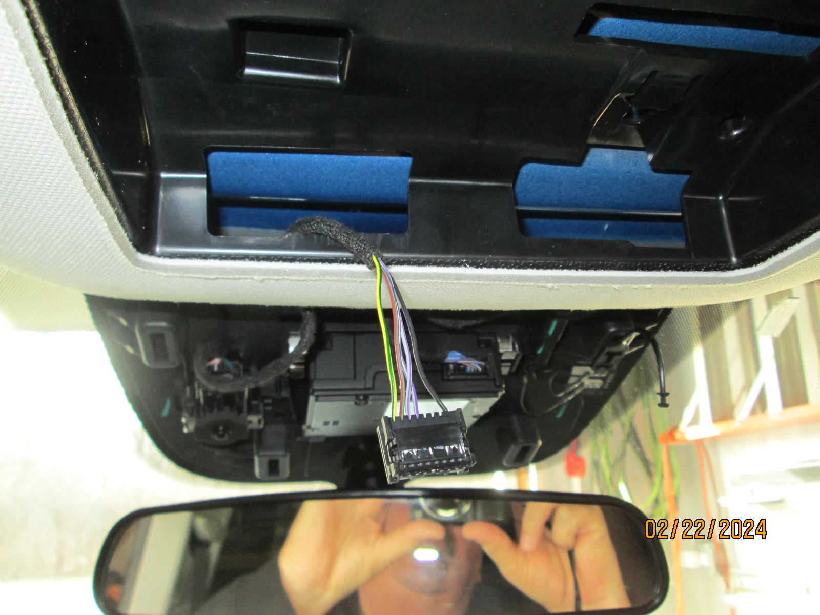

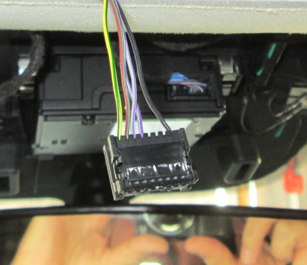

This is interesting:
Message from seller FiTCAMX Brand Store: Thank you for your reply. Could you please remove the cover above the rearview mirror and take some photos of the connectors inside? We would like to check whether there is another available connector that can be used to power the camera. If there is a compatible connector, we can provide the appropriate cable so the camera can draw power from it. Best regards,
Here's one of them (that feed the overhead lamps)

Fitcamx 4K Dash Cam Suitable for Ford Maverick 2022 2023 2024 2025 (HAS Rain Sensor), Integrated OEM Look, 2160P UHD Video, Built-in WiFi & APP, Loop Recording, G-Sensor, Easy to Install, 64GB Card
i know the 26 doesn't, i'm working with them right now to figure out if there is a way to utilize the sensor/camera that is there for power.
Yip. Just went trough that this morning. They are sending be a cable to match whats under my cover.
